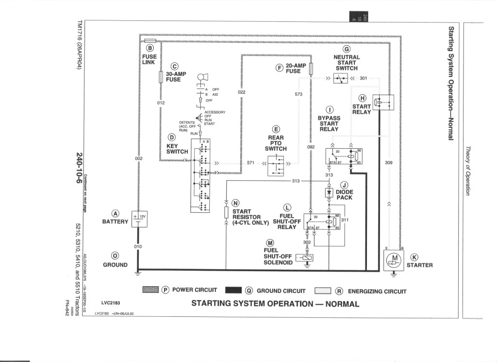

Hi Thanks , Ive just joined this group and found with my , john deere 5520 that there was no start up due to no power going to starter switch , traced to the fuse box , power going in to box , but no power coming out at starter switch side , checked all fuses and relays all ok , but still no power from fuse/ relay box , which is located at the left window in cab , I have since drawn a blank on what to do , the box may have ashort internally , but cant seem to break in to , hope someone can help?

Is trans in neutral & pto in off position?

The 5X10 and 5X20 are very close in the area of electronics. I have attached a picture of the 5X10 startup and you have to determine how close.
What is it you are calling the start switch? Is it the starter relay or something else? If it is the starter relay most likely TX Jim has provided you the answer.
If you go to JDparts.com and look at the parts catalog (selection on left side of screen) it will help you locate the two safety switches TX Jim spoke of.
