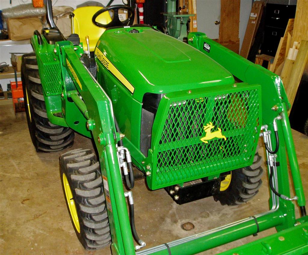

Here's my grill gaurd replacement for 3720. I made it out of real expanded metal (not that thin flat stuff JD used), and a bent tubular frame.

Nicely done Jim! I sure agree that the JD guards could be made more stout. You must have access to a tube bender...nice work.
Ditto Jim,
That's how it should be done!
Rob

Rob...I just bought my 3320 last week (used).....and it came with the optional Deere guards on. Deere offers two types of bolt on guards. I believe Deere calls what I have the "heavy duty" guard, as I have the expanded metal front and on the sides of the guard. BUT....even this "HD Guard" is built pretty light duty....AND has the gaping hole at the bottom. This is what my fabricated plate is all about (shown in primer on some pics above).
Jim G's design covers most of the Deere's deficiency quite nicely.

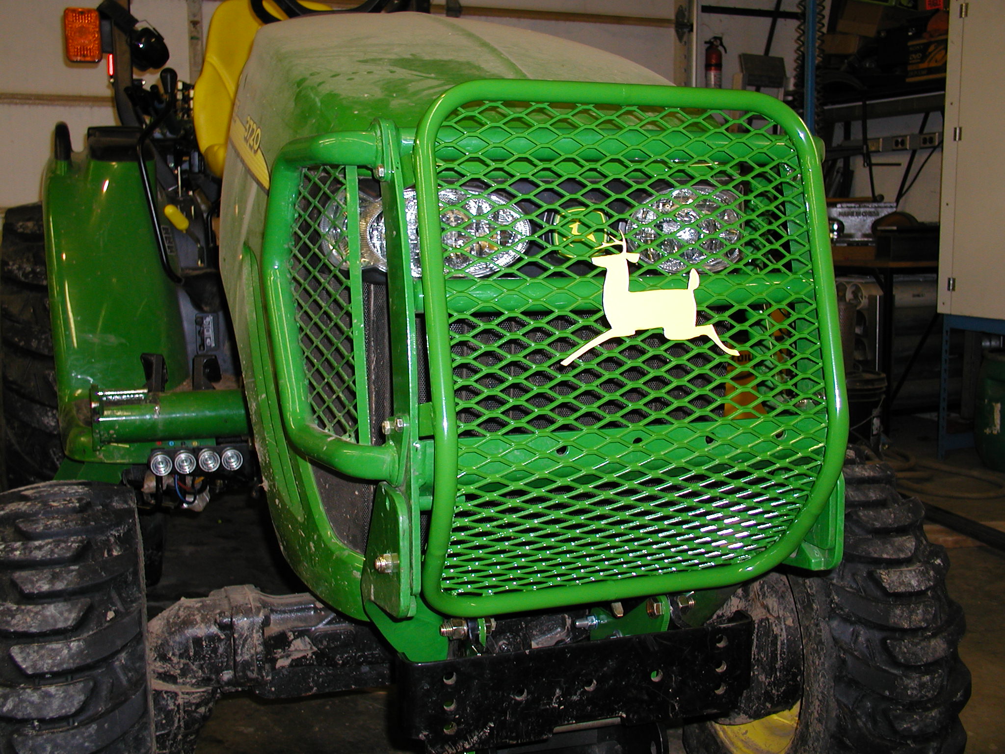

Great minds think alike, but mine is a simpler design due to the limited fabricating skills of the designer--that would be me. My yellow Deere-deer came out good though, LOL! I really like the wings on Jim's guard, but trying that would have been like brain surgery for me and my little Lincoln 225.
Seriously, anybody with one of the open JD guards ought to put one of these on, might save a lot of grief later.
