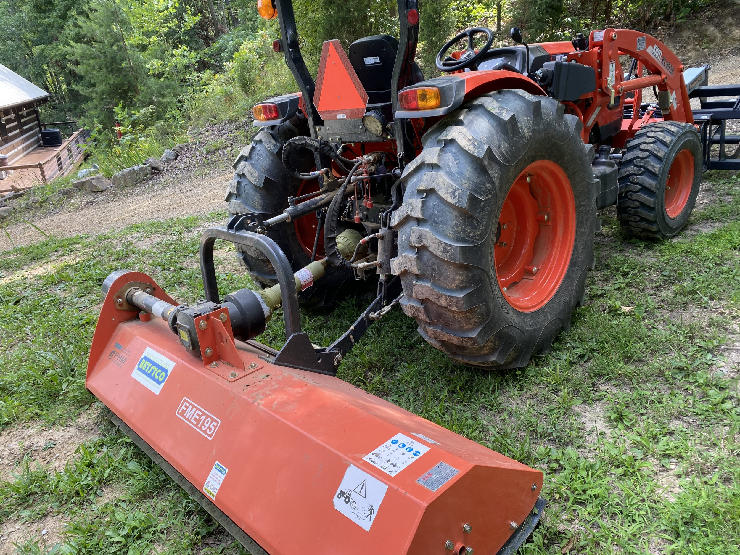

What angle do you set your mower at? I usually keep mine where the roller in back is on the ground but the front is up 5-6 inches. Am I doing that right? I have a hydraulic top and tilt.View attachment 708714

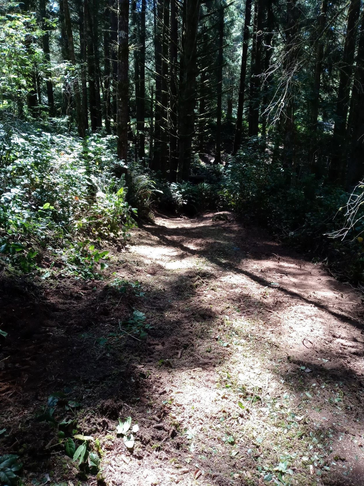

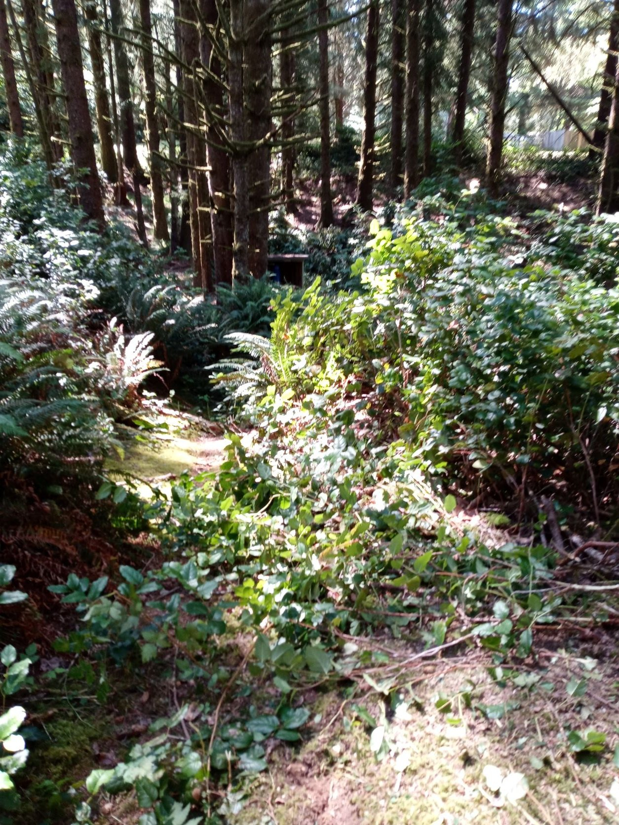

On my 48" Bestco Flail the guide suggested the top pin be slightly behind the lower pins, after using the mower for about 12 hours now and playing with it I'm staying with that position. Did about a hundred yards of trail clearing to the Cistern earlier today and it did the job.
Before and after shots.
