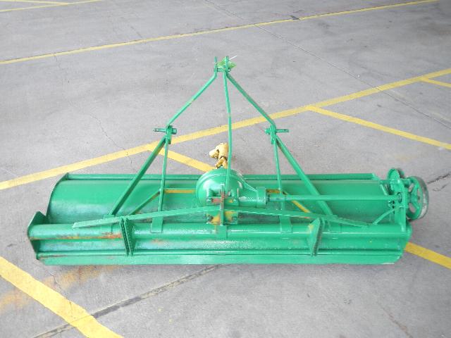

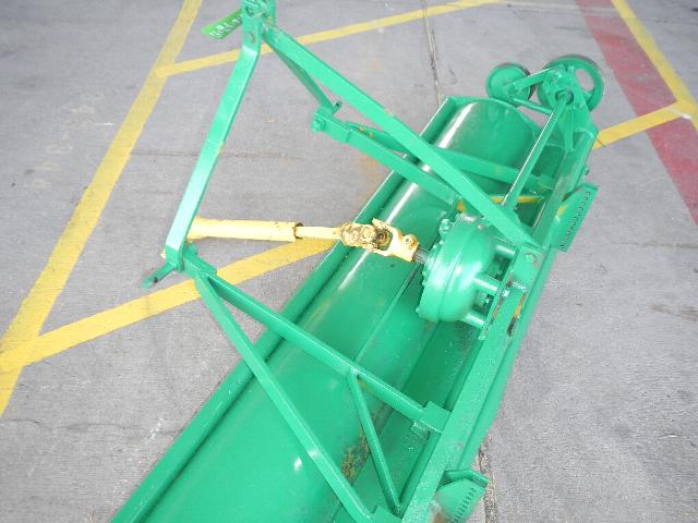

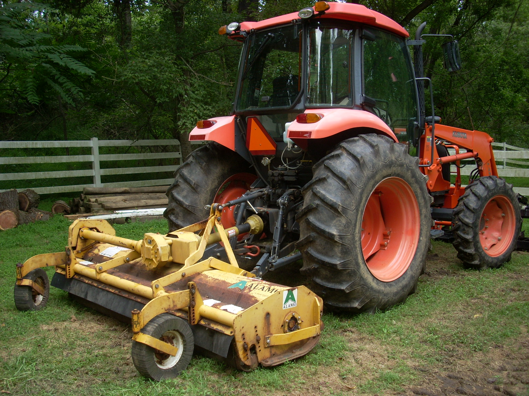

I recently purchased a flail mower. It has no distinguishing marks or labels. The mower is painted John Deere, but I doubt it is the brand. I am looking for the 2 tire/wheel assemblies for it. I seen a post on here that shows an ALAMO that is very similar. (First Picture).

Can't help you with the manufacturer, but you really need a belt cover. Without one, you'll get into weeds and brush that will quickly strip the belts off the pulleys. The other half of the PTO shaft cover would be desirable as well. But hopefully it's a trick of the camera lens that makes the thing look like it's bowed. Were you able to spin the rear roller and/or cutting rotor before committing to buy?
The gauge wheels by the way, might be the same ones depicted on pg48.

It's a Mott/Alamo. According to archived pics of this model, the pulleys were open and did not have a cover. There is no rear roler only a cutting rotor and yes the rotor turns very easily by hand. Thank you for providing the link.
ps. No it is not bent...just an illusion.

I've never seen a Mott that looks like that. The hitch looks completely different and I've never seen a Mott with a round shell over the rotor. Mott was an approved implement for MF tractors and even the old MF catalogs don't show a Mott that looks like that. The gear box looks similar to a Mott but that's about it. Do you have a picture of the rotor? The knife design would tell for sure if it's a Mott rotor. Being it's all painted green, maybe it's something somebody has pieced together from various parts? It HAS TO HAVE a rear roller! You go over a little hill and the rotor scalps, well, then you bend the rotor and you're hooped! The gauge wheels won't prevent that. I think the paint is trying to disguise it as being better than it actually is. Just like a rattle can restoration on a tractor.

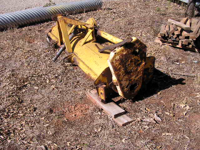

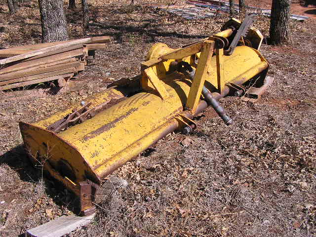

Can you provide a link?
The gear box is mounted backwards from the Mott that I had, and every Mott picture that I have seen.

The mower you have is a MOTT Hammer Knife Mower, you can buy spares from UGH!! GAG!! Alamo Industrial including wheel sets AND it does have a V belt guard AND a cover over the stub shafts on the opposing side and a rear roller.
It looks to be his-Mott's model 72 flail mower.
I am unaware as to why Mr. Mott referred to the knives as hammer knives but.....................the story continues.

You need the rear roller regardless. Gauge wheels help smooth out a rougher field but aren't needed for most applications. In the link with all the Mott pictures, there isn't one that looks like the mower purchased. There is another link of a mower that looks similar but that isn't listed as a Mott either. It's possible it's a very early Mott or a copy of a Mott. None of the Mott pictures show the same type of 3 pt. mounts or the plates coming up at the back to hold the pipe that goes across the mower. I think the Mott knives were called hammer knives because they swing like a hammer. Similar to a hammer mill? When developing the flail mower the knives were run in pig manure to test the self cleaning properties. There are a lot of IH tractors in the older brochures and even special models made for IH tractors. This isn't by coincidence. Mr. Mott was an engineer at IH when he developed the flail mower. IH wasn't that interested so Mott went off on his own and the rest is history.

The mower in question IS NOT a SHD (Super Heavy Duty) model Mott. The Super Heavy Duty is a much heavier mower and uses a 4 1/2" diameter cutter shaft. The SHD would also be a lot newer. By design all flail mowers look similar but there is not one conclusive picture identifying it as a Mott. It may be a very early Mott but when you look at some of the details, they are different from what are for sure Mott flails.
