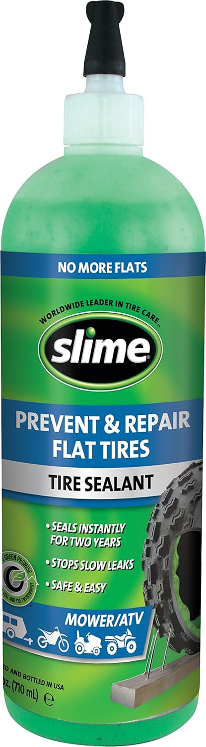

I put a shot of sealant in all my seasonal tires.
Minimizes air loss over the winter in all my ag and RV tires.
Won't help now with your out of round tire but it can keep the problem from happening again

When the tire gets warm and you drive it around for a while the tire will get round again and stop making you bounce around. Add some slime afterwards inside the tire and all should be good.

How will that Slime prevent colder weather pressure loss? As WinterDeere said, nothing change the laws of physics.
Goodyear states results of the law of physics for this:
How Cold Weather Can Affect Tire Pressure​
For every 10 degrees of temperature drop, tires will drop 1-2 pounds of pressure. It is important to keep your tires within the recommended PSI to maintain traction, handling and durability.

Won't prevent some loss, but it will keep the tire from going completely flat
That was the OP's problem.
   / Flat all winter #10
Yup, allowed to remain flat for an extended period can ruin the sidewall plies and belts permanently.
I forgot that happened. I guess I allowed my aversion to Fix A Flat to color my opinion; it will cause so much rim damage and mess, most tire shops will not work on a wheel with that added.

Slime is supposed to stay gooey, to be wiped clean next time the tire is off the rim, so a bit different than Fix-a-Flat. Also, tractor tires don’t need careful balancing, like automotive tires, so less a factor.
I’ve never used either, but I’ve seen the result of both in tires from others. It might not be a bad solution, here.
My usual method is to hunt for any potential bead leak with soapy water, and then once found, pop the bead, clean the tire and the rim with Scotch Brite or fine sandpaper then use bead sealer. If that fails, then I usually resort straight to a tube. Call me “old school”.
   / Flat all winter #12
Not sure about Fix A Flat, but Slime is water soluble and easily washes away. I've been using it for years and have had to work on tires & rims a few times. A garden hose quickly cleans it up.
It's difficult to patch a Slime filled tube though. I usually don't bother and just replace the tube.
