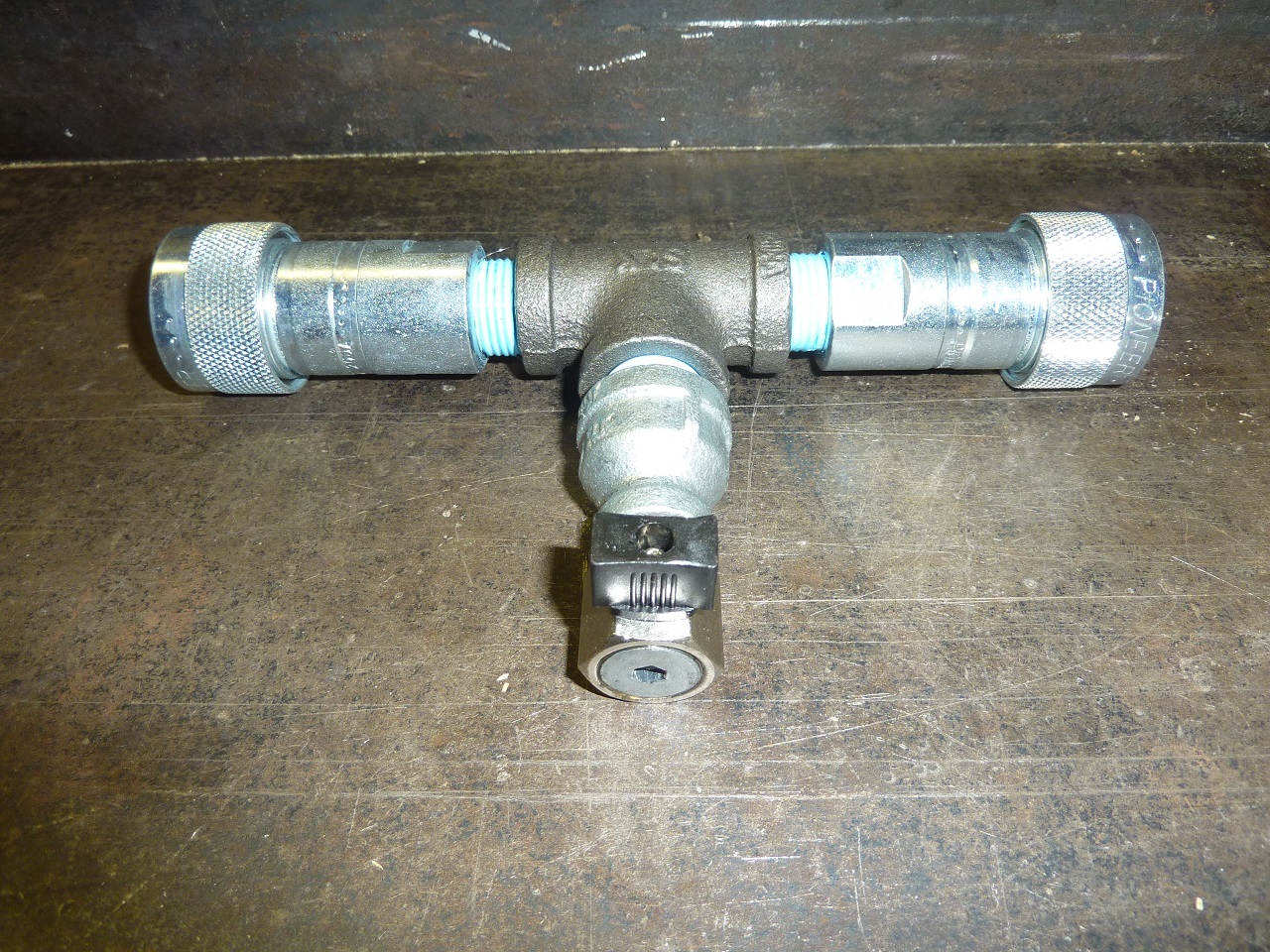

I've been fighting with these pressure bound fittings for years now. I tried the connect under pressure Flat face and Pioneer types with little improvement. I finally switched to the Pioneer 2 way style QD's which so far are working well. I used Female breakaways on my tractors which can be pulled apart even when not completely depressurized. The male fittings on the implement hose ends can be depressurized by rapping the ball valve end on the side of the implement frame. For my frequently used implements, I made up a few of these:
Although more expensive, the same idea can be used for flat faced QD's as well.

I made something very similar but used a 4-way cross tee instead of a Tee and just left it open on the sides. I stuff a paper towel in there. Sounds like you have the exact same issues I have and tried all the same things...
I did that at first but found I was losing more oil. I still do this with frequently used implements though. For long term storage, Letting the hoses "breathe" allows air and moisture to enter which is never a good thing.
   / Flat face hyd. coupling "pressure release" tool #59
Oh - I don't leave mine in place. I just use it to release pressure on the tractor or implement side when i am trying to connect. I plug it in then pop it back off. The most that comes out is a tiny squirt.
