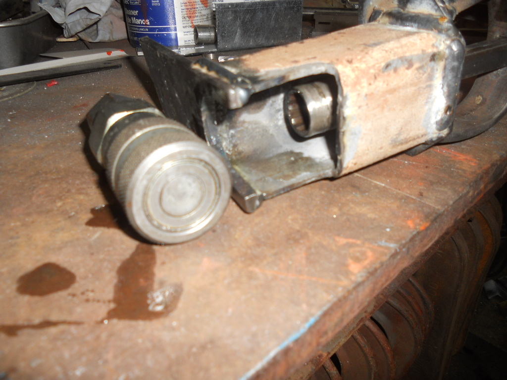

Threw these together during shop time with all the recent snow. It seems lately that all my hyd. attachments are needing me to "crack a line" to release about a tsp. of fluid to connect them. Very frustrating, and yes I know how to release the pressure before you disconnect. I'm convinced that it only takes a few degrees of temp. difference to expand the fluid and create enough pressure to make it impossible to do. Pretty simple, for the male end I just made a slot to hold the fitting in one of the recessed groove and use a bolt to screw into the middle part to release the pressure. The female side I found an old socket that fit (with a little grinding) into the proper "ring" on the face and plunger that is hand activated. They seem to work well so far.:D

A word of caution on the flat face QD's. Some of these have an O-ring seal that can pop out of it's groove if the mating connector is not there to hold it in place. I don't know how much movement is required for this to happen but when it does the QD can not be used until that seal is replaced or reinstalled in it's groove.

Hey thanks for the heads up. Have you guy's figured some other way? Is this on the female side or both? It (so far) don't seem to bother the Parker QD's

Not sure how far they have to be pushed in to expose the seal. Best suggestion to be take one that you has no pressure on it and push the seat in slowly until you can see the seal. My experience was with Snap-tite and Foster, possibly Parker traps the seal a little differently to reduce this risk of the seal extruding.
I believe in my case it was typically the female half that caused the most problems.

Well the blue tool for the male ff coupler is all I need to use. I just put it on the attachment (male) & then on the machine (male). This has been working well and has not given the coupler any troubles. I might just be imagining it, but the male fitting seems pretty simple vs. the f/m fitting and the previous advice about possibly disturbing an o ring.
