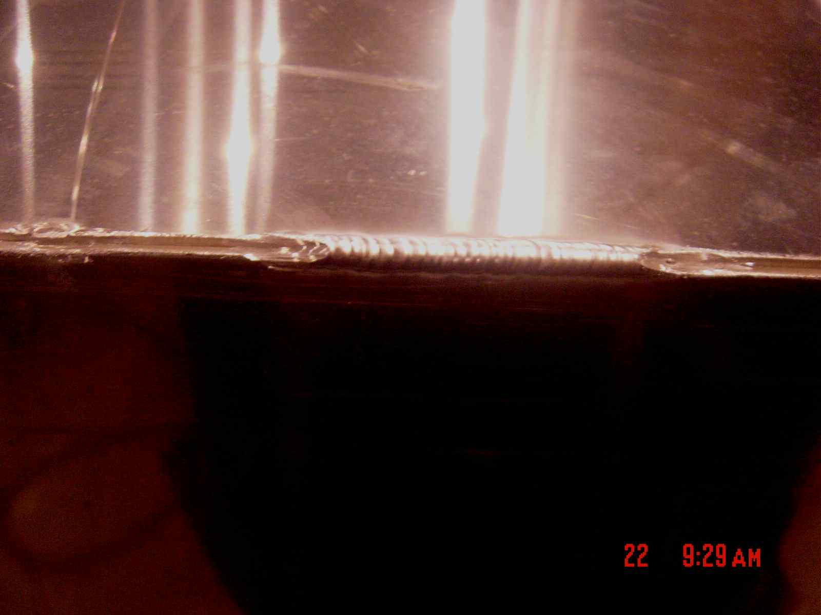

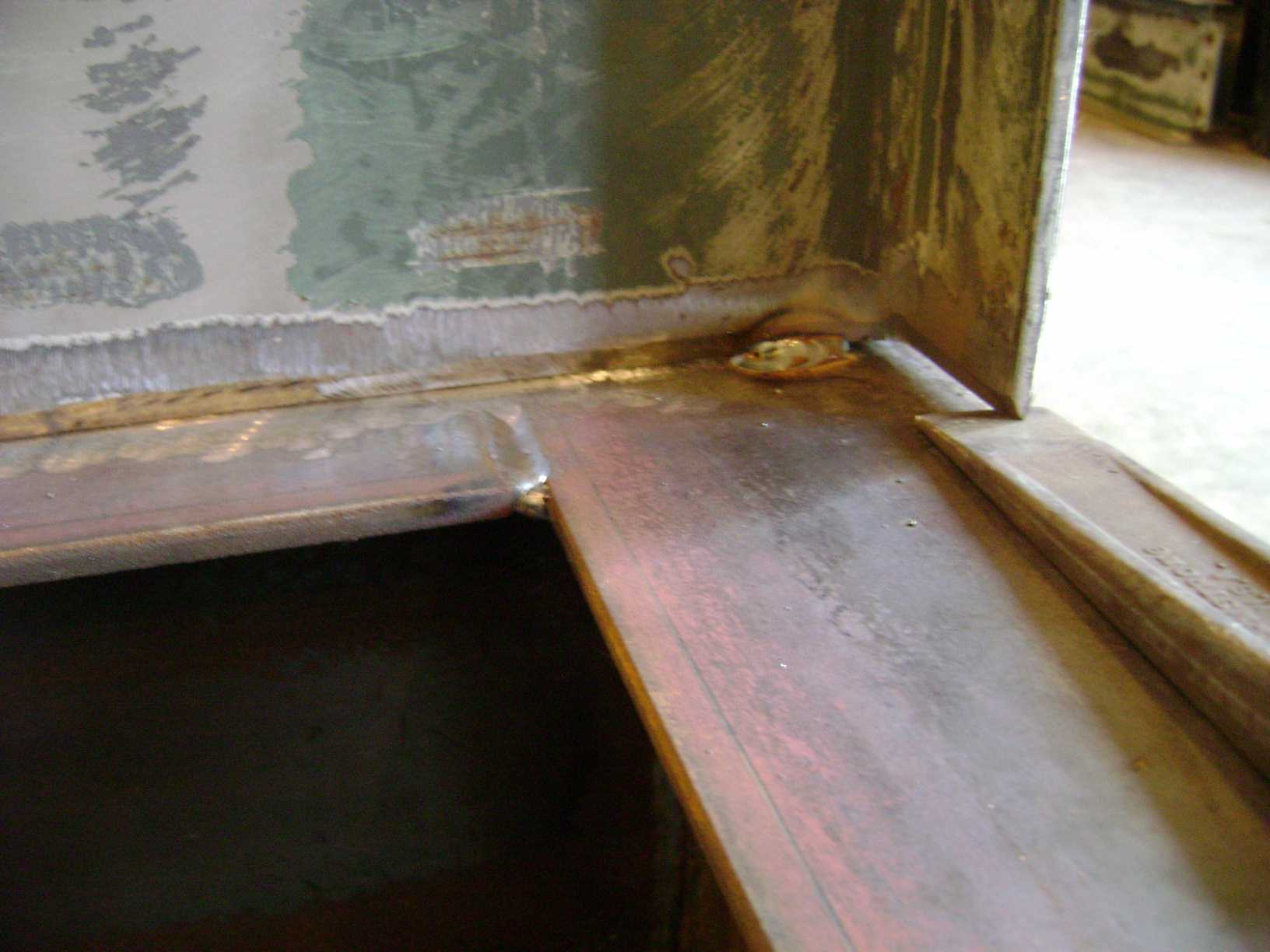

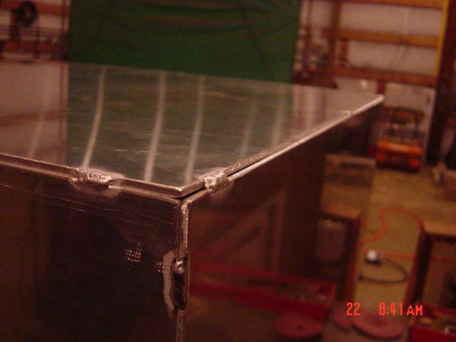

dragon just like Arc welds is saying. When ever you can set them up corner to corner! Nest best is to bevel the the top plate.

Open corner outside welds are one of my favorite welds in steel and aluminum - no grinding required, just cut exact sizes needed and weld it up :D
....yeah, I'm a lazy welder and like to eliminate grinding when I can :laughing:
