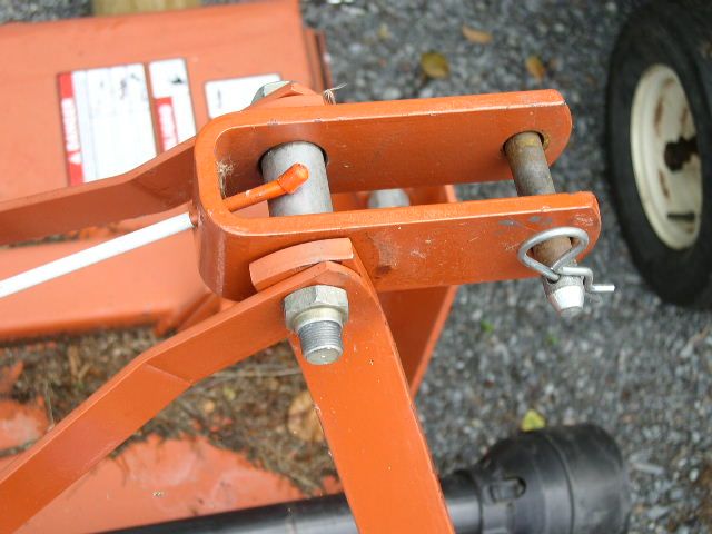

That said, I've had three different types. And the type is determined by the design of the implements A-frame.
1. U-type
//greg//
Is this what you mean by the "U-type"? This is from my mower.
/ Flexible Top Link #11
Exactly. In that particular configuration, it operates very similarly to the parallel bars (forward carry) that I mentioned above.
