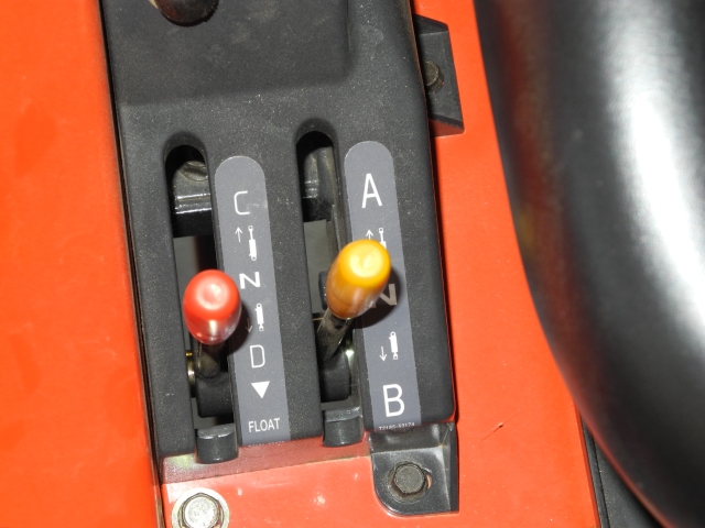

Hopefully he will look in and confirm this for you. Here is a picture of a guys CK35 with the float function. This does exist.

I have personally installed a top & tilt set on a Kioti CK27 that has the float function with the 2nd set of rear remotes which was installed at his request. Davrow who is a TBN member.
Holidays and all - sorry it took so long for me to respond.
Here is my "installed by my Kioti dealer using Kioti parts" lever setup on my Kioti CK27 (new early this year):
and the rear connects:
Currently the backhoe is mounted. The A/B lever has a detent in B, so that lever is pushed forward (to B) and it stays there - allowing all the backhoe valves to have fluid flowing to them (and from there to tank). Putting that lever in B with no attachments or backhoe would deadhead the hydraulics.
The C/D lever (2nd remote) has the float (push past D). Depending on specific need it allows an attachment to rise and fall with the terrain. Basically it opens a fluid path between the sides of a double-acting cylinder so fluid can freely flow between the two sides.
Personally I imagine myself mostly using the float on the top link, although I can picture instances where it might be used on the side link.
