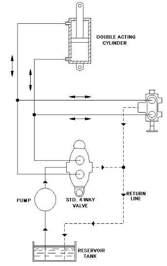

/ Float option routing #13
I'm wondering if this valve could be used to add float to an existing loader valve without float capability. Guessing that the plumbing might get hairy.
/ Float option routing #14
Here is the required plumbing setup
/ Float option routing #15
The plumbing doesn't look to be as bad as I had envisioned. I was concerned about the volume differential between the base and rod ends of the cylinder but looks like the return to tank takes care of that.
That is a very neat diagram and follows the "picture worth a thousand words". I would personally like to see more diagrams included in "hydraulic discussions" but I also realize it takes time to lay them out.
/ Float option routing #16
Fortunately Surplus Center had that diagram in the literature for the valve and I was able to just copy and paste it.
