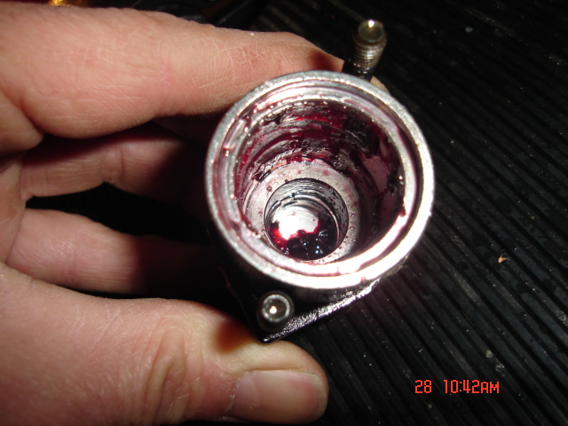

After reading and looking at my setup, I do definitely have a float position but my control valve will not lock into float. If I push the level up (towards the bucket down position), part way, it will push the bucket down until it lift the front wheel off the ground. Then if I push a little further it will drop the front wheel back down...but again, there is no position between down and float....This is also why I having problems digging with my loader...I usually just push all the way to the down position, but this really is the float position...
So my question now, can I fix the control valve???? If I can't and need to purchase a new valve, how do I know which valve to get?? All my manual says is "Valve, 2-spool, 1000PSI....part number KU10445.

Some Kubota's had a problem with water getting in the detent portion of the valve-it's the long cap looking thing bolted to the end of the valve opposite the joystick. There a balls in there that get rusty causing the "lack of float" problems you are having. Drilling a drain hole and packing with grease is the solution.

Kennyd Nailed it right there.
