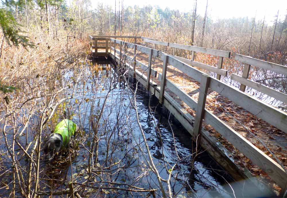

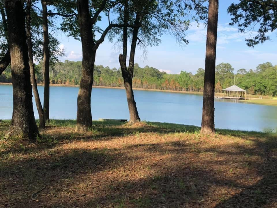

Anybody out there have any experience with floating docks? I want to build a dock on some lake property and would like to have a covered area for a picnic table, swing, etc. Covered area would be about 20' x 20' with a 15' walkway similar to the one across the lake. I haven't been successful in finding someone to bring in a barge with pile driver and probably can't afford to have that done anyway. I was thinking I might have a floating dock built but not sure how stable they are. The little lake stays at a pretty constant level since it is spring fed. Little to no rough water to worry about. If you have a floating dock I would love to hear about your experience. Thanks.
