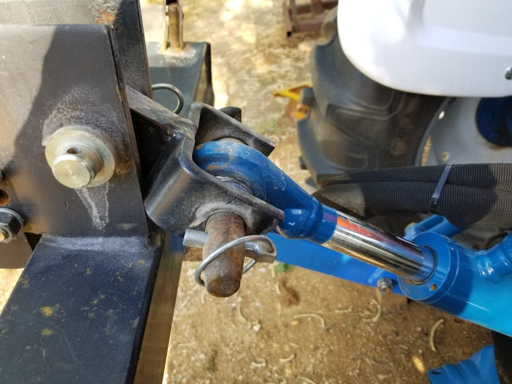

I'm thinking that the "stirrup" is some kind of floating link? Did you mean (right AHEAD of the QH?)
I guess it depends on which end you're standing on. :rolleyes:
Forgot to mention--The 3PH is all the way up in this photo.
Here it is:

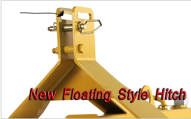

The EA landscape rake I have has the usual connection point for quick hitch l top link and an extended "slot" where you can connect the top link to allow for some floating. I'm still learning how to use it best, but combined with gauge wheels, it does a good job. I am never eager to remove the quick hitch to mount it this way, but I will if the job is large enough.
