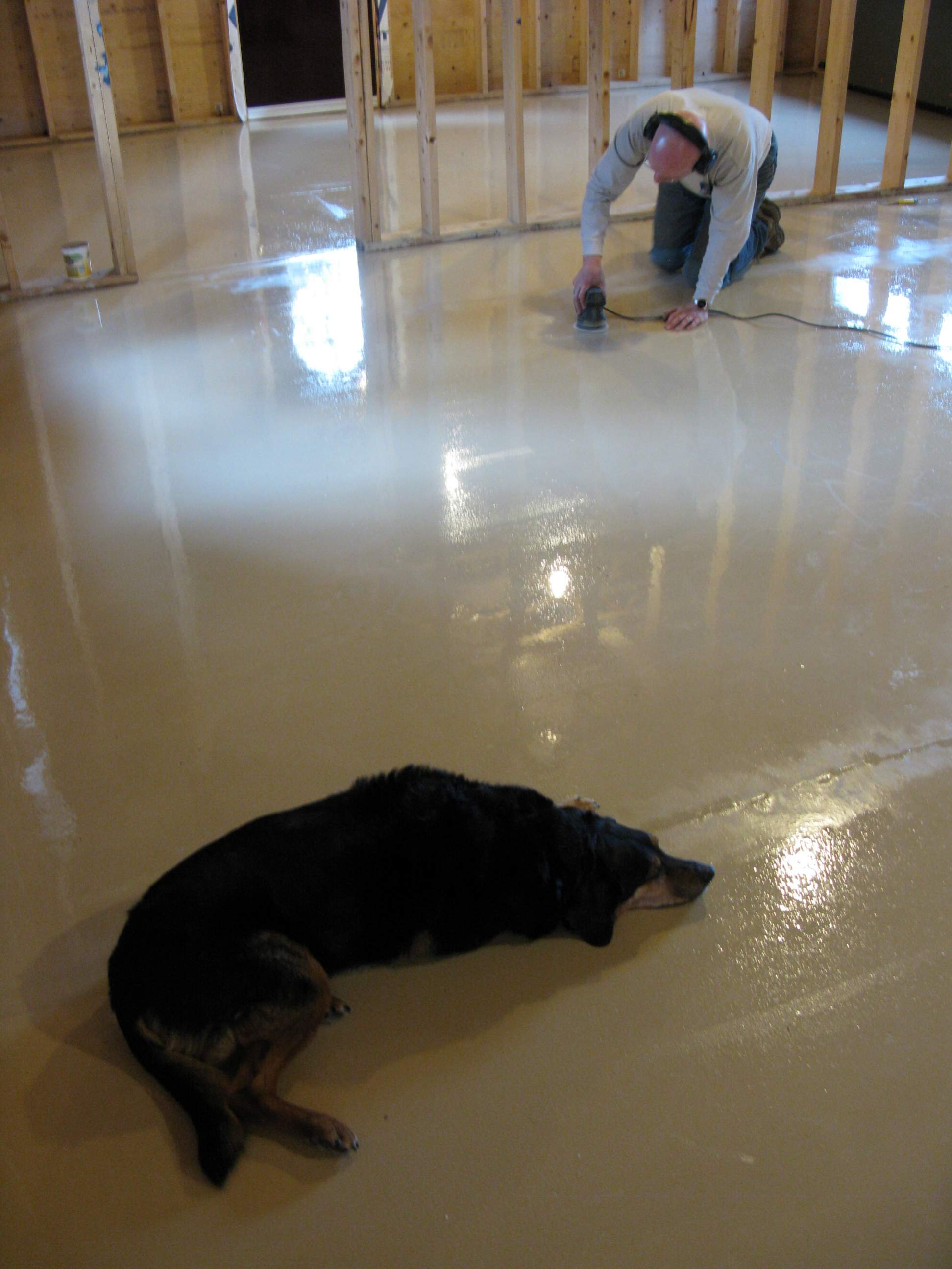

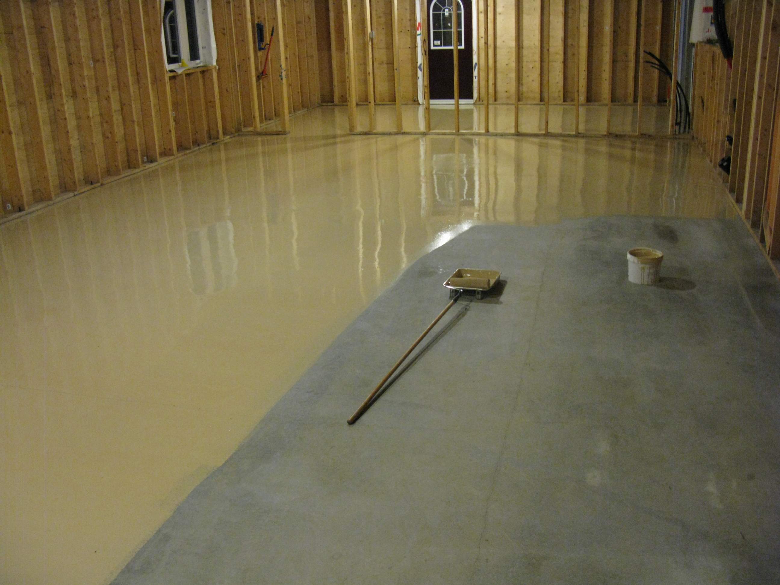

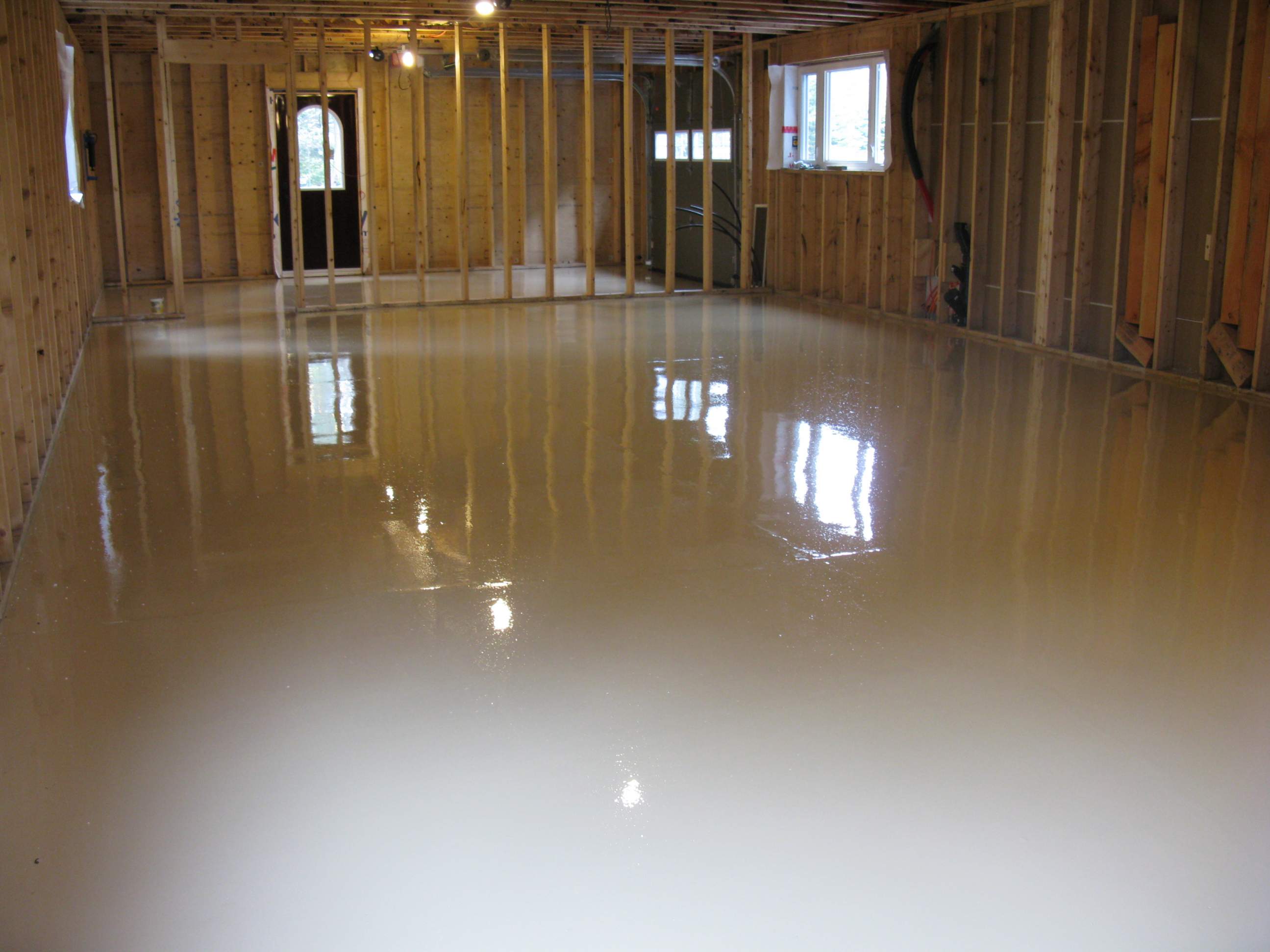

Thanks everyone, the comments were helpful.
It comes down to a few things to consider:
- Smooth floors are easier to clean but can be slippery when wet.
- Many coatings are suspect to wear, chipping, or hot metal when welding, grinding, etc.
I decided to go with the epoxy floor and see how long it stands up for my particular needs. There is a garage mat I could get should it be slippery.
I sanded a few areas where a lump formed by inadvertently including a bit of dirt, etc, before applying the final coat.
Attached are a few pictures, including aforementioned canine who saw nothing wrong with hopping over the barrier to come and find me - or tracking epoxy coating on my brick cobbles, either.
We'll see how this one holds up.

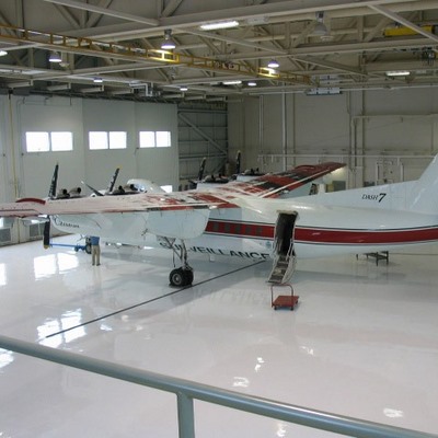

I have applied ultimate linings polyurethane system for flooring .It's result amazing,see how it looks
