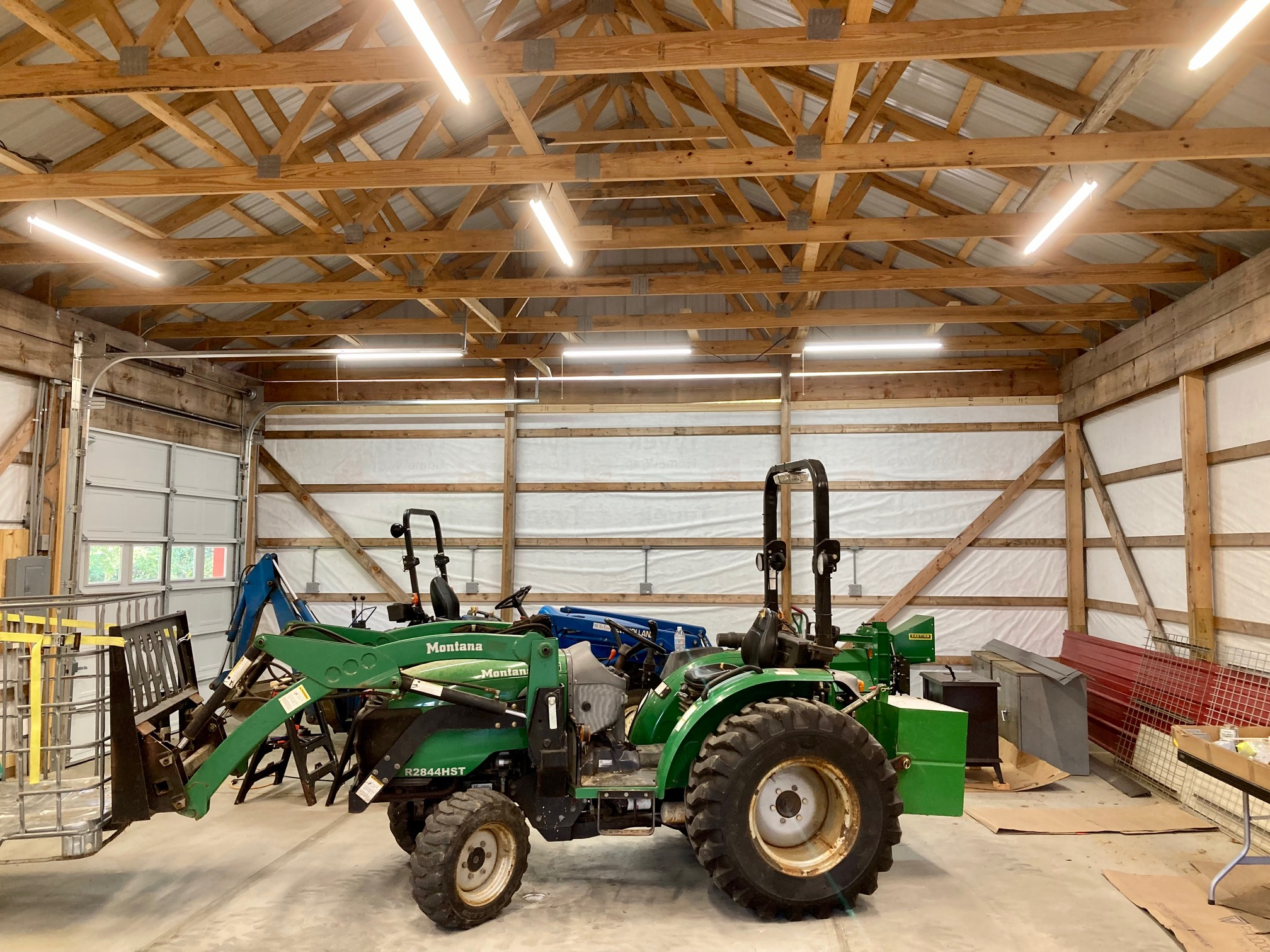

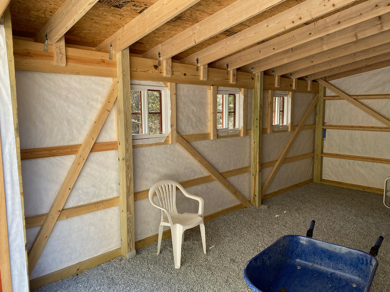

Put down heavy plastic and then fine screened gravel (I prefer #8, approximately pea sized). A screened gravel has no fines and will self compact so you can easily grade and level it, and re-smooth it any time in the future. It will not create dust problems.
A lot of people use a crusher run type of material, but to me it's not ideal. It has to be put down in thin layers and compacted, and because it will be inside a dry environment it will be dusty. I put down crusher run inside my sawmill shed (pole barn with two sides open) and don't like it nearly as much as the #8 inside my other barn. Yes, the crusher run is firmer and easier to walk on, but tractor exhaust and wind loves to kick up dust. My crusher run driveway is just feet away and doesn't have these problems unless we're in a drought. Crusher run needs periodic rain/moisture to be a practical surface in my opinion, and that doesn't happen inside a building.
If you plan to put in concrete later, that's another reason to go with screened gravel. It is a superior base for concrete compared to crusher run.
Here's a barn addition with #8 gravel on the floor (about 4" deep, over 6 mil plastic):

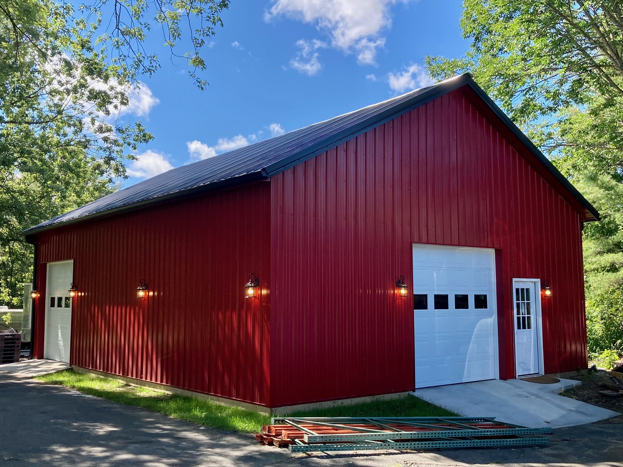

What prices are you getting for concrete? I built a 30x40x12 pole barn in 2020-2021 and the concrete floor was $4500 installed. Your profile does not say where you live, but it could be quite a bit cheaper depending on location. You will not regret doing the floor if you can swing it somehow.

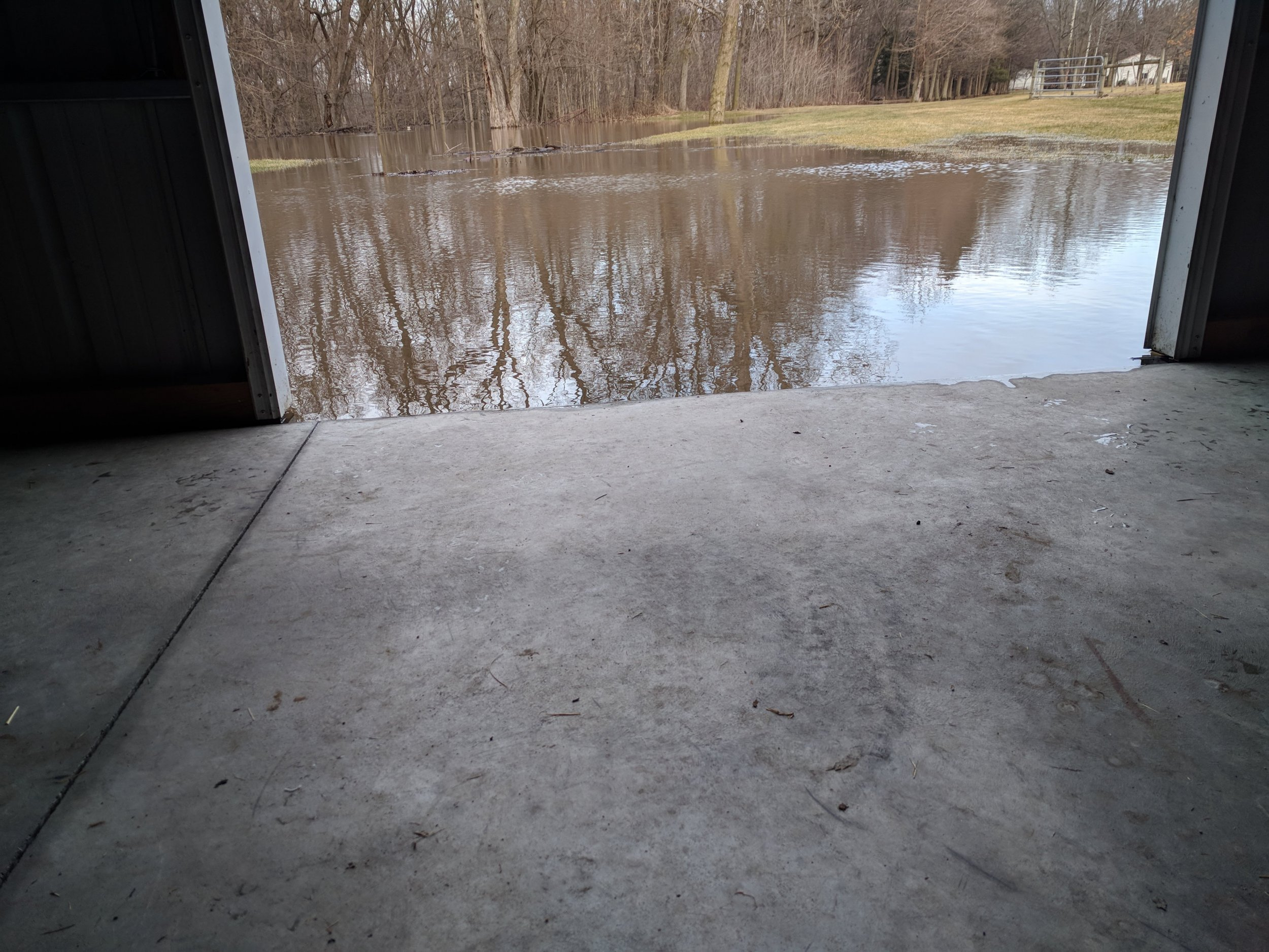

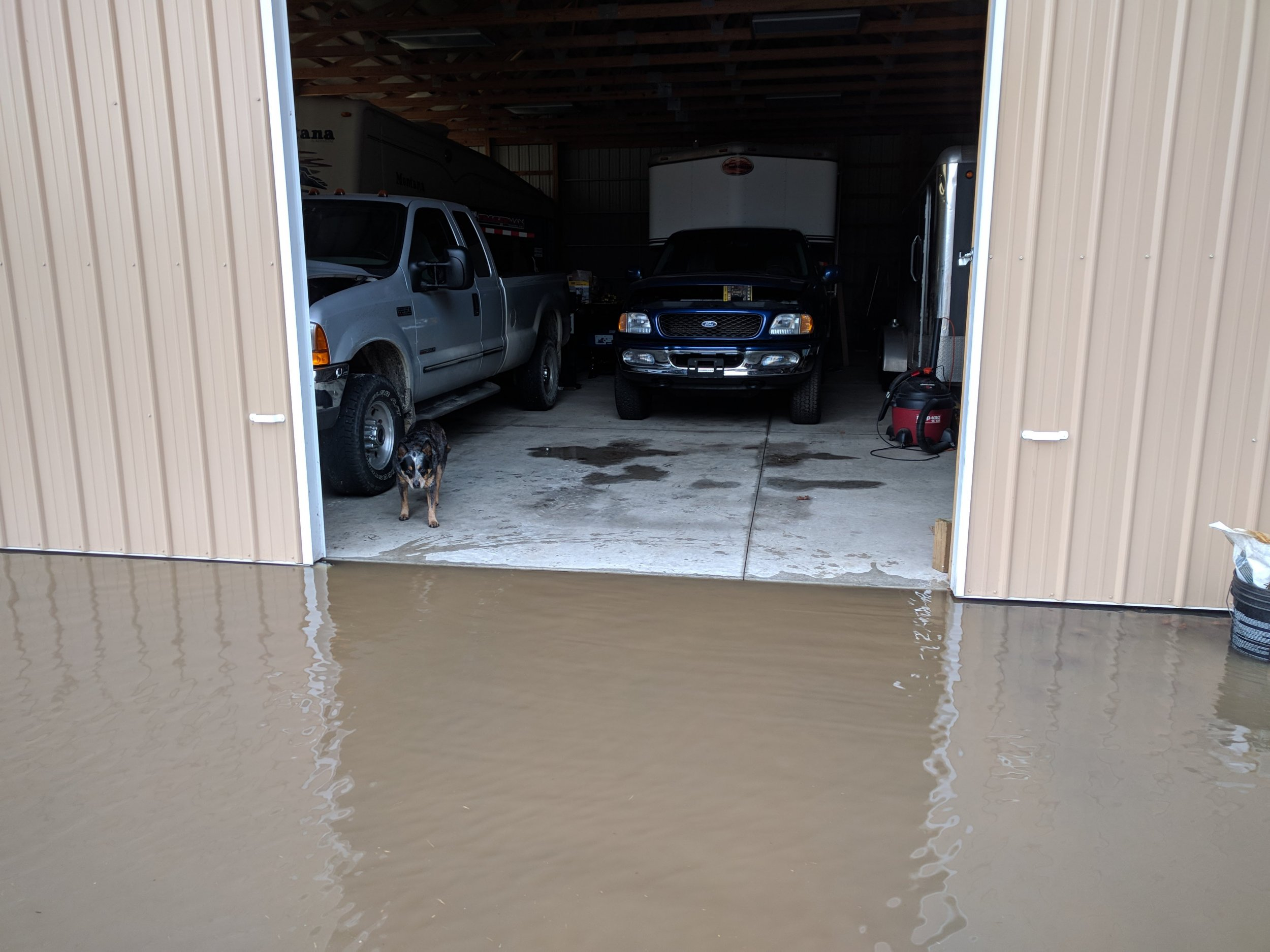

I had a 56x40x14 building built about 12 years ago and was going to skip the concrete floor but thought that I could afford it better at that time than when I would be retired. With prices now, I'm glad I didn't wait.
You mentioned mud in a dirt floor and I still have some dirt in a horse barn where I stack hay on pallets and have never seen mud. That's why you have a roof.
We had what they called a 100 year flood a few years ago and I am glad that I built up the grade where the barn is. If the river would have gone an inch higher, water would have made it in the barn.
