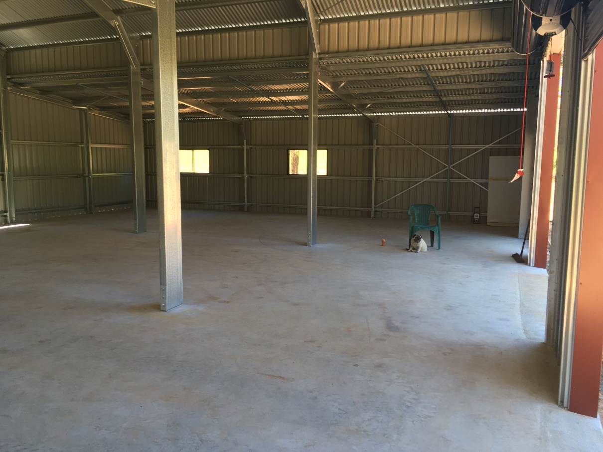

I am interested in having a small 30'x40' pole barn built this year. With everything being expensive these days, I will not have a concrete floor installed for a number of years.
If concrete is not an option right now, what floor options do I have? I plan to park a vehicle and equipment inside the pole barn. The building will not be heated, cooled, or insulated. It will be used for storage only, but I do not want the floor material to lead to rusting my vehicle and tractor. A dirt floor is not an option to me since I do not want to deal with the mud.
Thanks for your input.
Put in concrete. Period. If you have to go in debt, go in debt. I built a similar sized pole barn 12 years ago and the WORST thing I ever did with outbuildings was to go on the cheap and use gravel. I regretted it soon after. I have regretted it for 11 years and will regret it for life. My building is filled with equipment and parts and shelves and tools and work benches and ... it would take me a week to unload it and then the floor would be poor because the site was not prepared right for concrete. good grief man !! Pour the cement ! And while you are at it make the doors a foot higher than you think have any need for right now and add as much size to the building as you can. Never big enough. Lessons like this are hard to learn and most impossible to reverse when you already made the mistakes. Far cheaper to do it right and do it once.

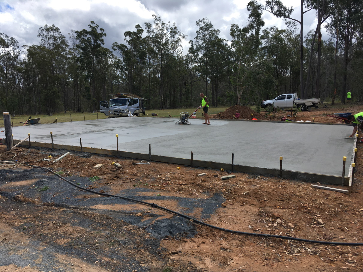

Yes, I agree with those saying to put in a proper concrete floor first. You will never be happy if you don't. I built an airplane hangar, and could not afford the concrete floor at the time. It worked, but was never a good outcome. The only thing I did right for the floor. Was to dig out a bowl shape within the hangar, and drain the lowest center area of the bowl with big O, then fill the whole thing with 1" crushed stone. That did work. I later poured a 6" pad big enough for the plane to sit on, and that worked, as it had a few feet of crushed stone to sit on.
If freezing in your area is likely, you really need to insulate under the floor, whether concrete or dirt/gravel. If you don't, and it freezes underneath, it'll heave, and you'll be extra unhappy. A few feet deep of crushed stone counts as insulation or, use foam insulation. The non gravel dirt floor side bay of my hangar heaved every winter, 6" or so. It was a dirt floor, so not much harm from that, but not nice either. Remember that if your winter would normally have six inches of snow, and a few months of freezing the roof keeps that snow away, so it does not insulate the floor, and it heaves.
I also tried used rubber conveyor belt. It works, but constantly bunches up, so is never flat, and will catch under a blade, and bunch if you steer over it.
Pour the concrete floor - if your barn lasts you 25 years, is it worth $500 for each of those years to never have a worry about the floor?
