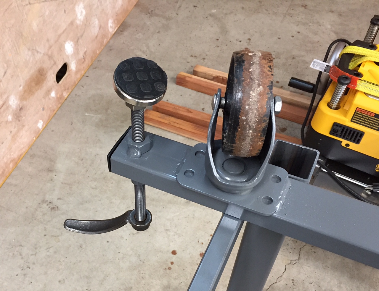

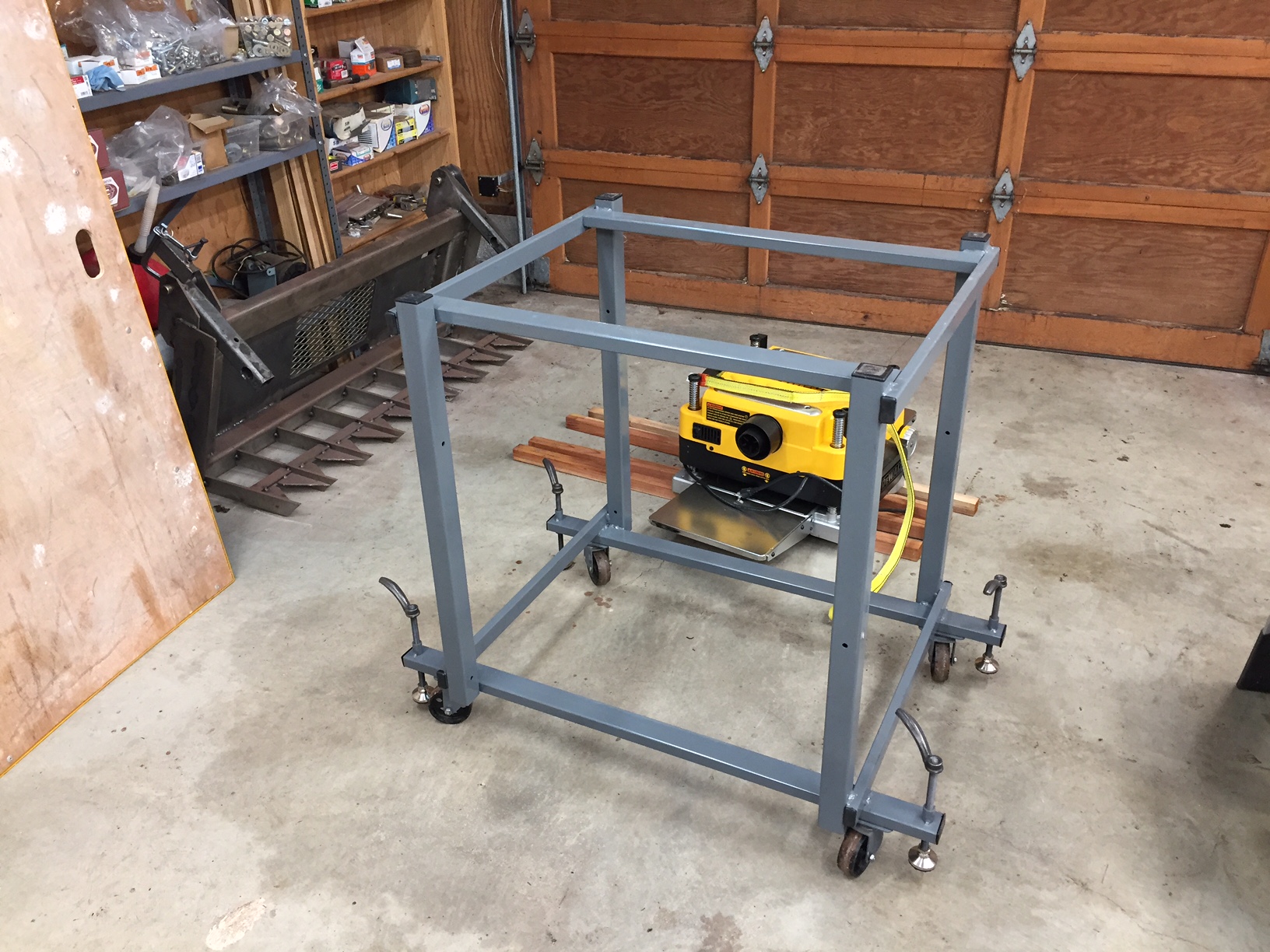

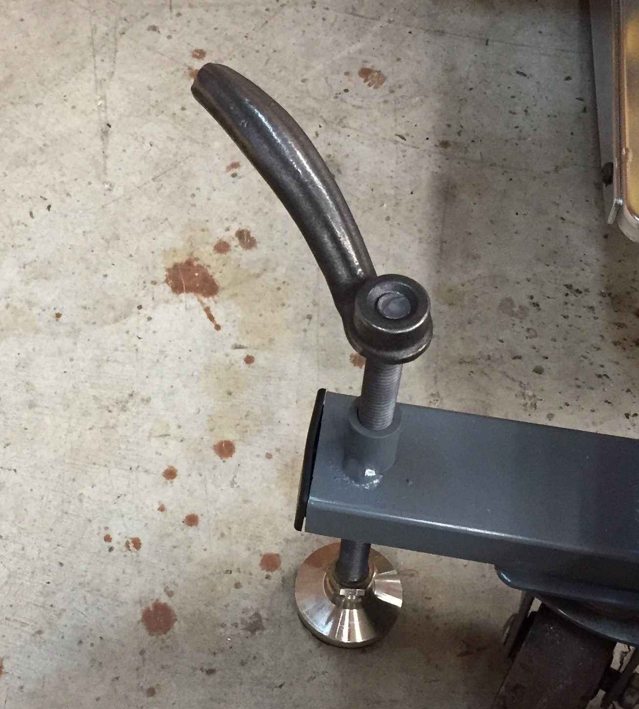

I have most everything on tool stands with wheels. I use a block of wood to wedge them off the floor when I need them to stay put. Recently there were some helpful posts on built-in floor stops. Making a tool stand for a thickness planer, which needs to be very stable, I decided to do something a bit fancier than a block of wood. These stops are easy to make and work well. There is a 1/2" nut welded on the bottom of the frame and a short bushing welded on the top. The three pieces (handle, threaded rod, floor mount) are assembled with blue Loctite. The mount rotates and tilts.

I really LIKE those. Nice job.

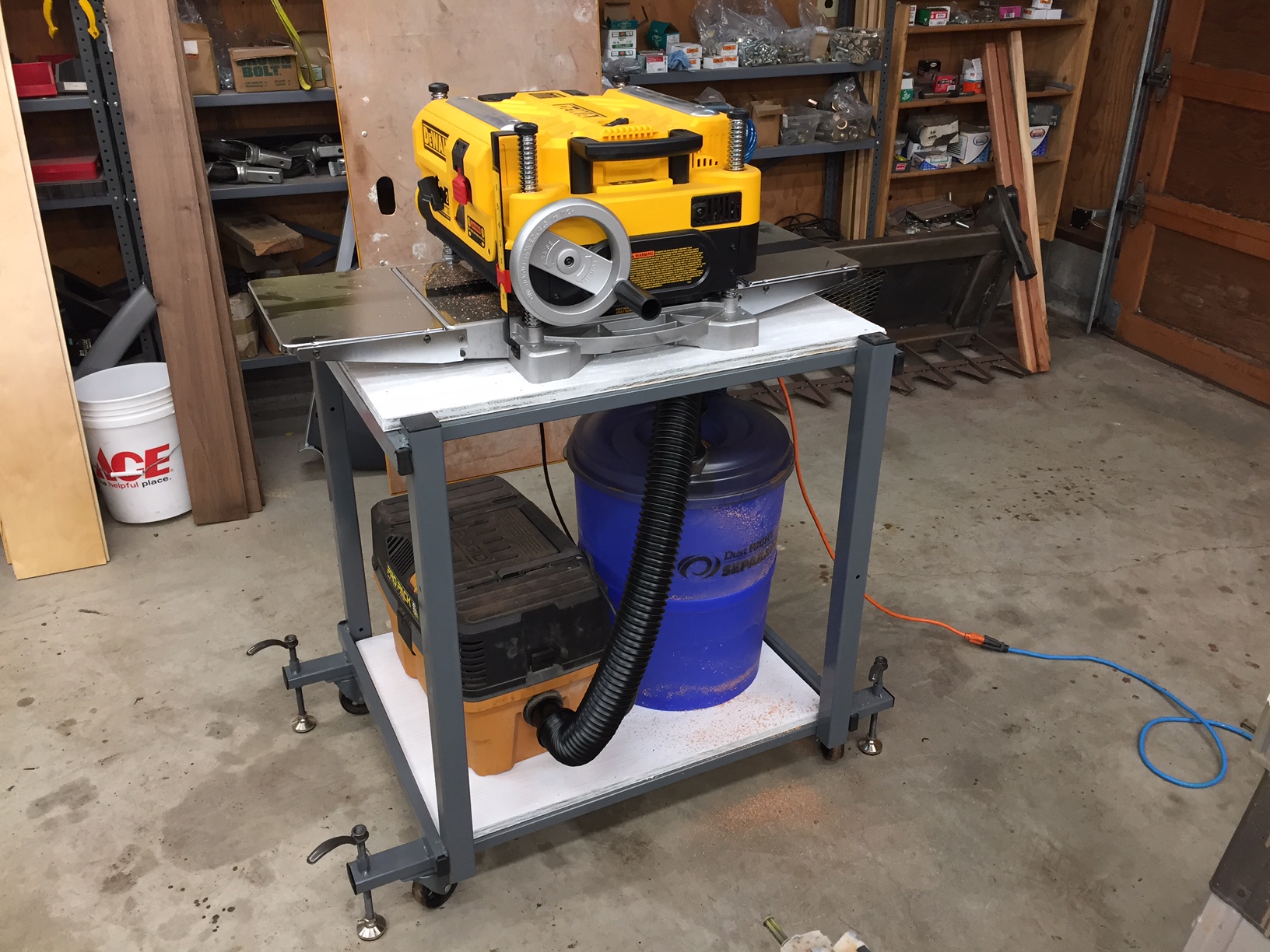

First test run, solid as a rock. Glad I decided to upgrade from the block of wood.

Those look great, very nice! Did you source the handle at McMaster-Carr too?

Nice. Be aware that with a planer you will fill that oneida bucket in 5-10 min of steady work... I have a pretty large 5hp grizzly cyclone and fill the ~50 gal bin in an hour or so of heavy planing...

There is a place south of Sacramento that sells 50 gal plastic drums with removable lid for $25. I've been thinking about that as a back up plan if I have to empty this bucket too often.

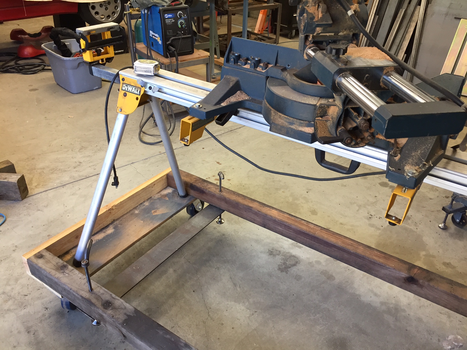

These simple floor stops worked so well on the planer stand I decided to add them to two other stands. The cutting table was easiest, I just welded two coupling nuts to the bottom rails. The rolling base for the miter saw stand was a little more work, I welded nuts to a piece of plate then screwed it to the bottom of the rails. Both stands have two fixed casters and two swivel casters, so two floor mounts to raise the swivels up is all that is needed.
