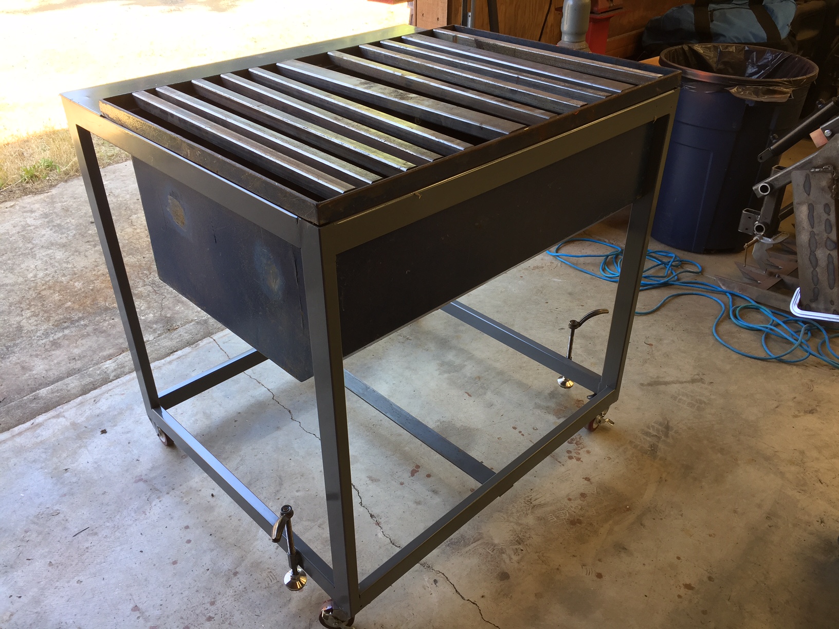

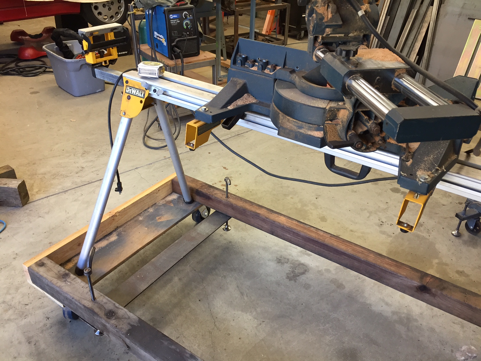

These simple floor stops worked so well on the planer stand I decided to add them to two other stands. The cutting table was easiest, I just welded two coupling nuts to the bottom rails. The rolling base for the miter saw stand was a little more work, I welded nuts to a piece of plate then screwed it to the bottom of the rails. Both stands have two fixed casters and two swivel casters, so two floor mounts to raise the swivels up is all that is needed.

Nice work as usual Pat :thumbsup:
