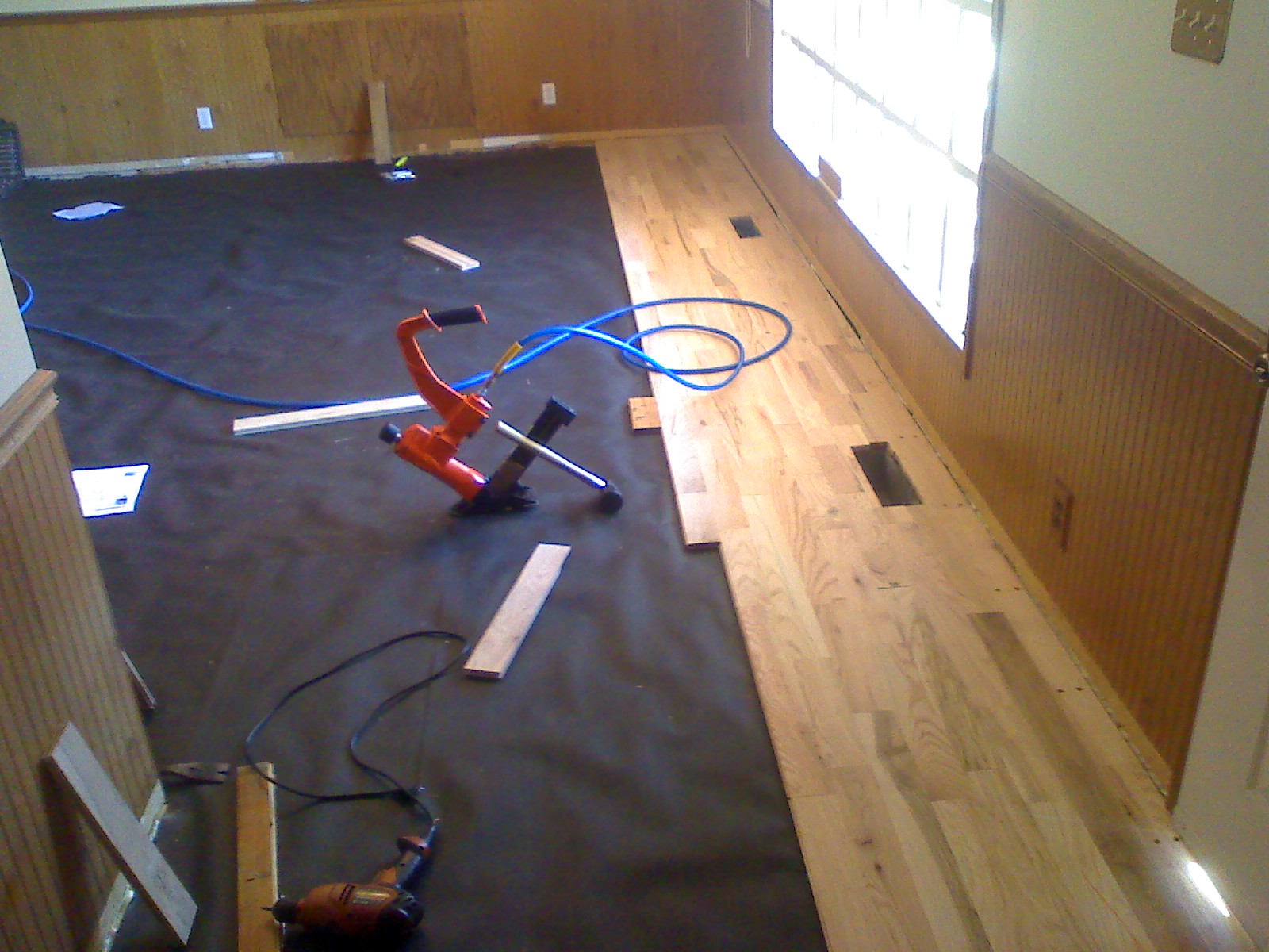

Here are som pics i started laying floor yesterday and am stopped for luch now, i have twice what this pic shows completed. My HF gun about 100 staples ago started misfiring, cant quite figure out when or why (only every so often) but i may take it back this week as i have the warrenty and its kind of annoying, but for the $99 (i looked at receipt, shoulh have used a 20% coupon) i paid its a good deal considering i cant do it all in one day.
Sorry for the quality but there cell pics.

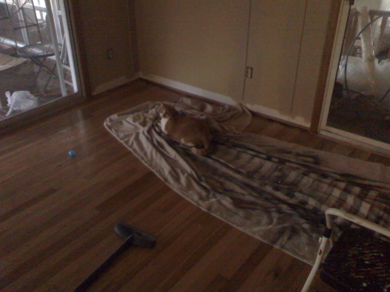

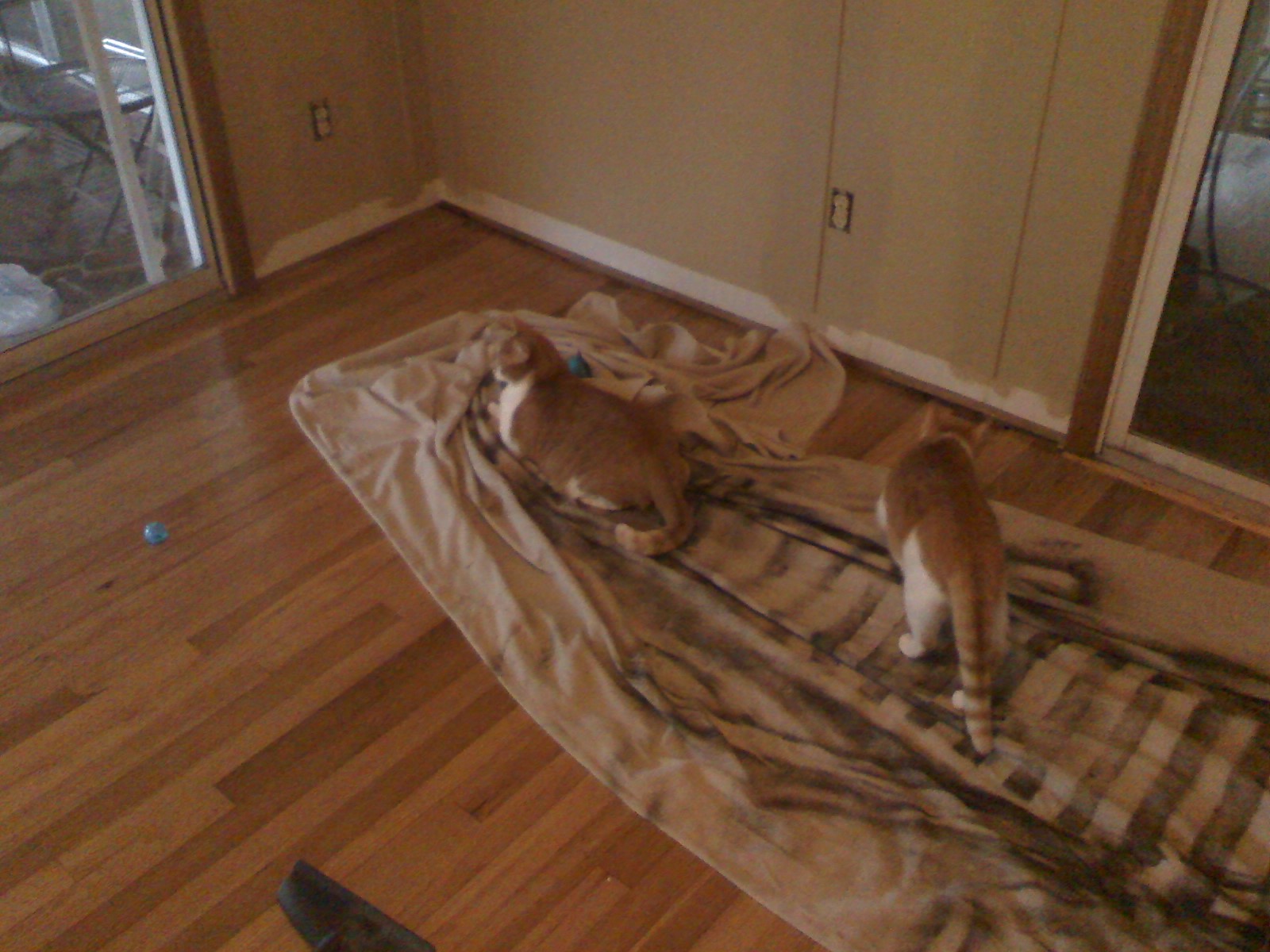

   / Flooring Nailer #40
Wrong pics i guess i should look closer at the thumbs, those are my cats on some of the floors i refinished.
Here we go.
