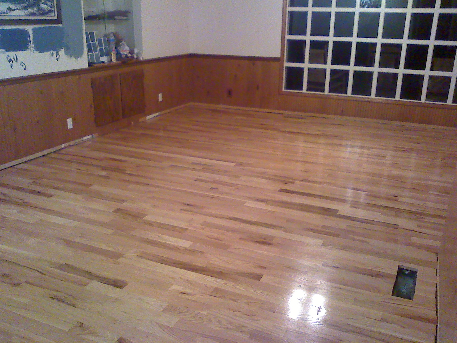

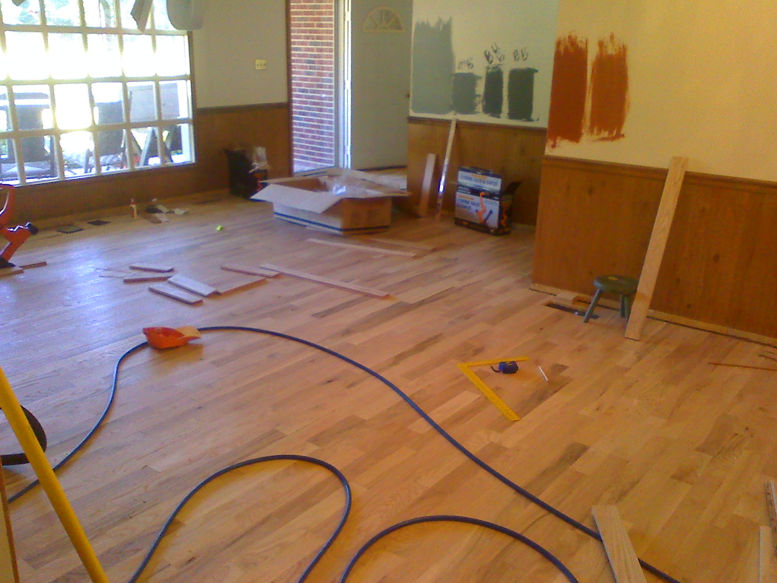

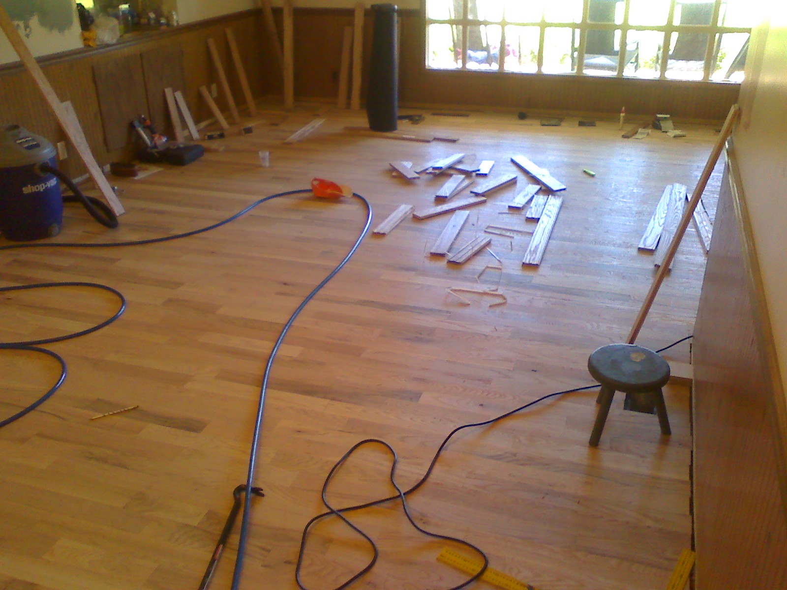

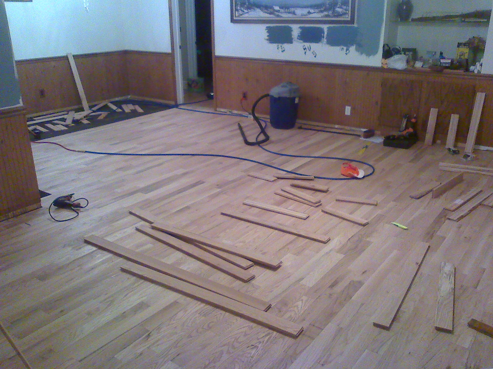

Here are some pics of the process. I am fixing to sand them with 320 grit for the last time and put the 7th and final coat of poly on them. I know lots like pics and i figured while i was pulling up my pics from the phone i would post some from this project. Pics are from my 2mp phone camera, is why there so low resolution.
The 3rd pic is after 3 coats of poly. The additional coats are for protection from the animals so that hopefully they dont scratch through it to the wood. It has so far worked pretty well on the floors that i refinished in this house. I will just lightly sand in the future and topcoat to eliminate any scratches.
