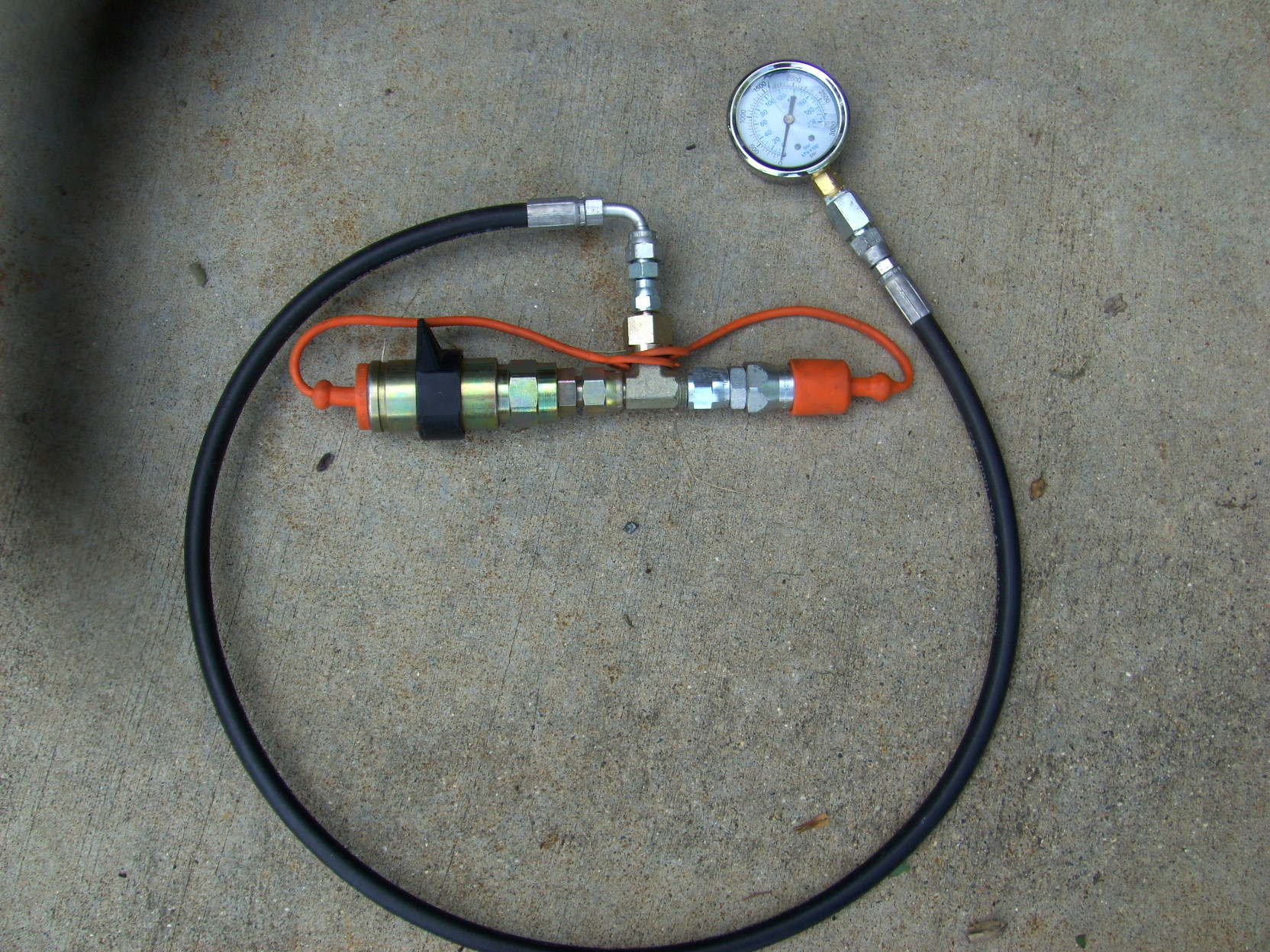

You have to put a load on the motor to set the relief pressure.
Since the relief valve is set for 1000 psi, I would turn the relief valve screw left about two turns and check it against some bushes or shrubbery with a gage installed.
Make up a hyd test gage. About $30.
Would I install the test gauge on the return to tank line from the sickle?
Gage goes in the pressure side. Fluid coming out of motor is low pressure going to tank.

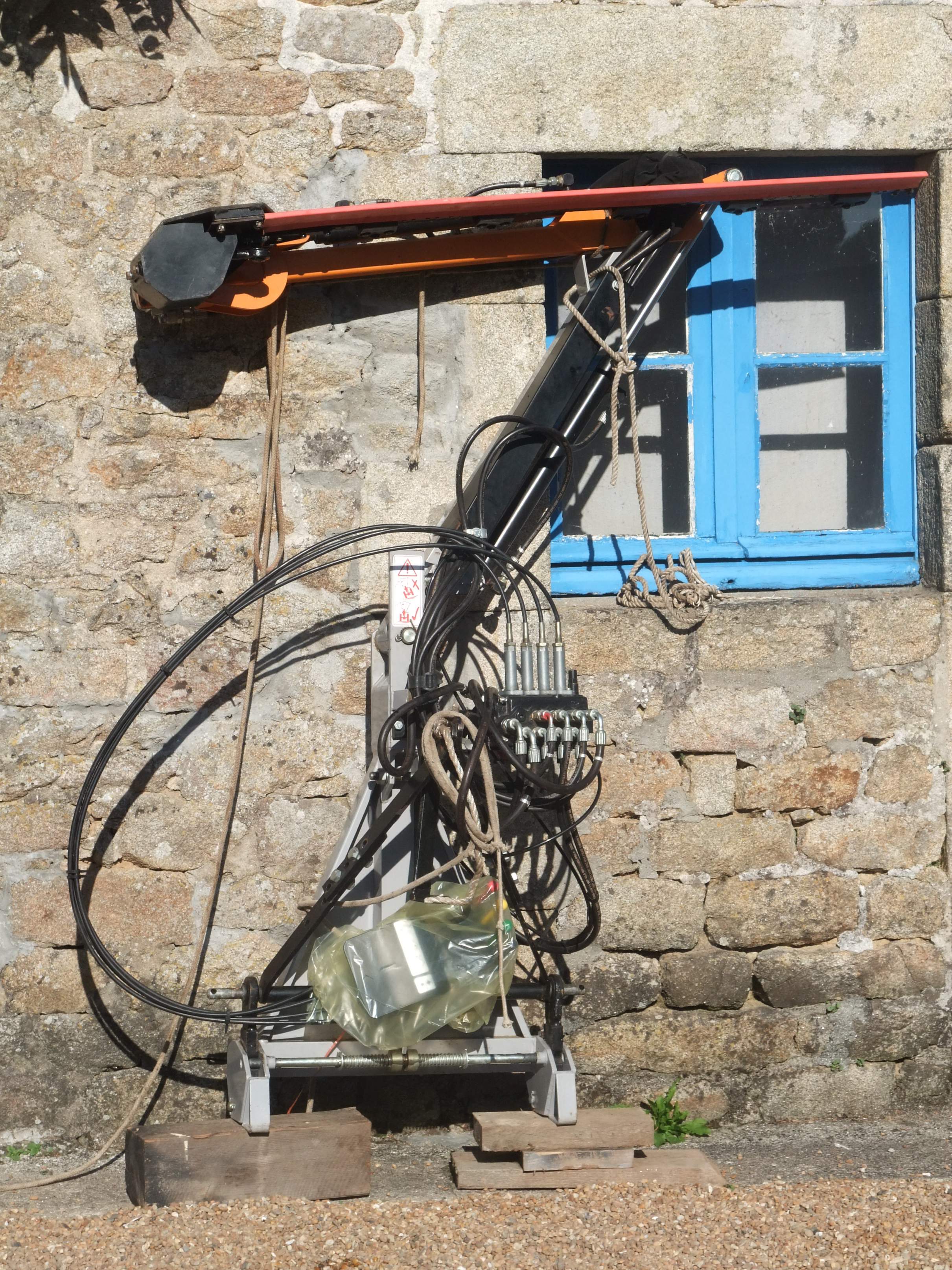

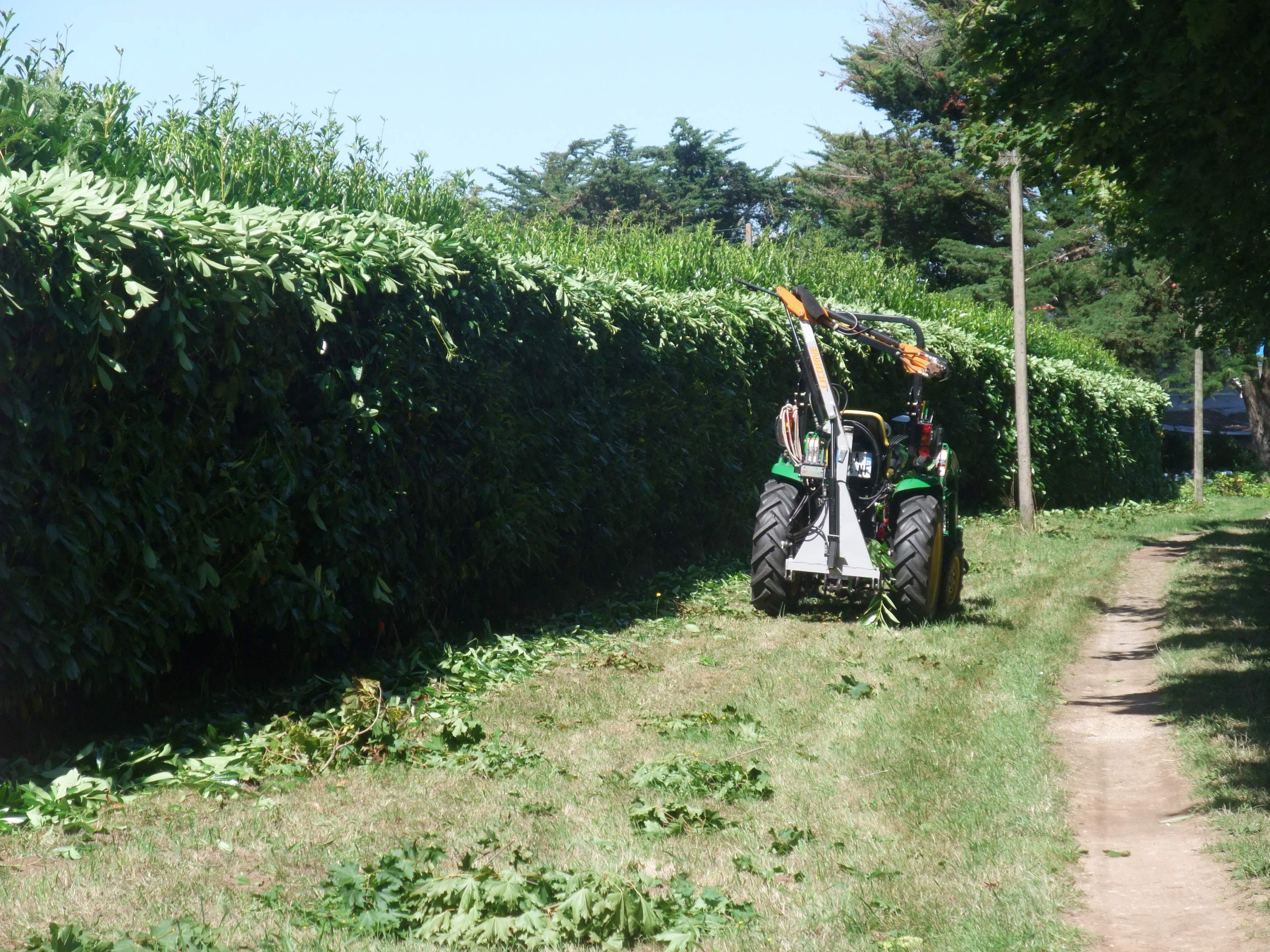

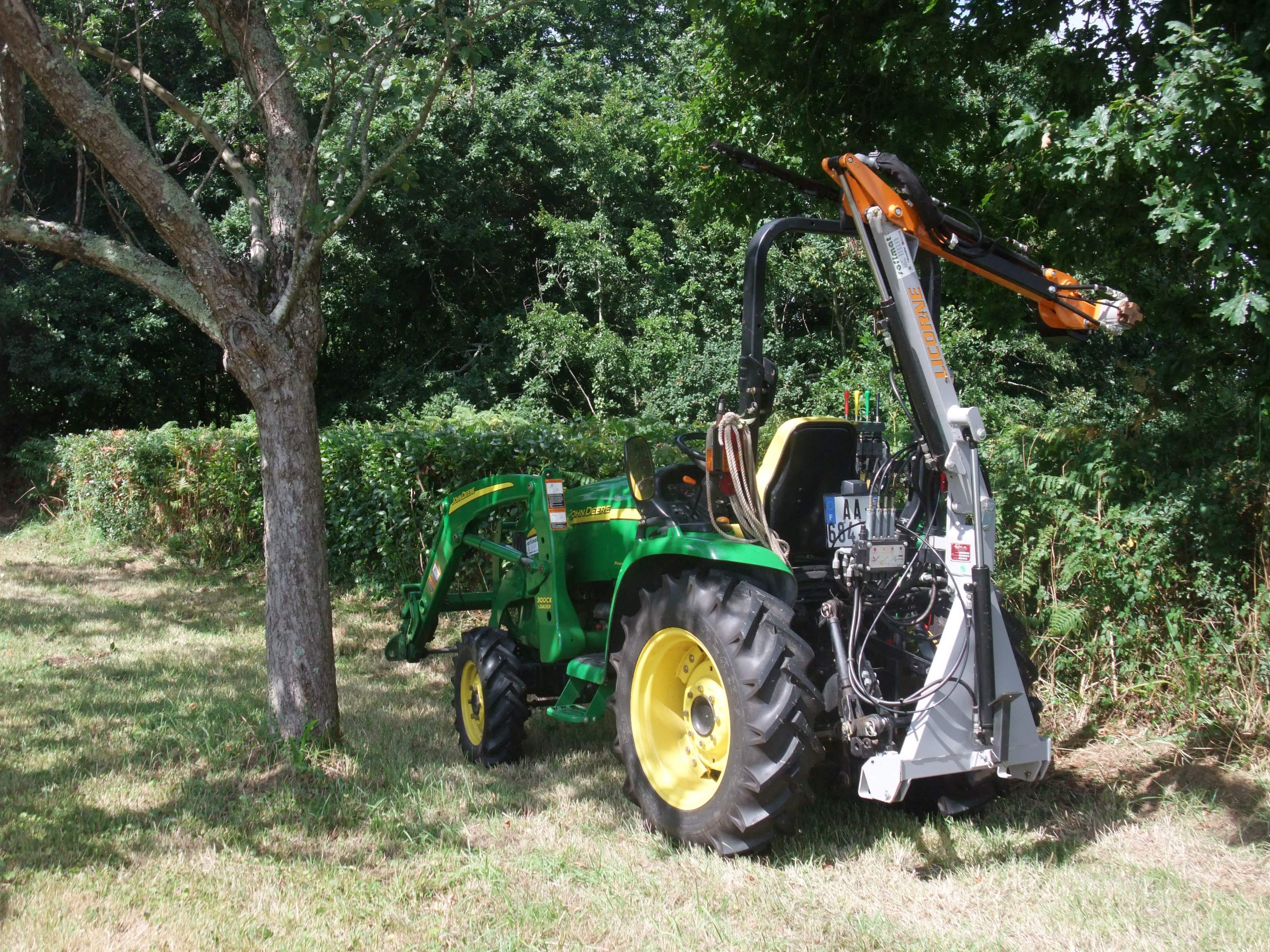

I don't think there will be any trouble running a sickle bar straight from your usual QDs. This is what I have been doing for several years with my hedge trimmer. I usually run it just above idle on my JD 3520. The only addition I had to make was a direct return to tank for the hydraulic motor.
