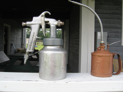

I use a conventional siphon feed spray gun with quart can. Converted it to pressure feed with a kit and it works perfect for spraying FluidFilm.
   / Fluid Film rust perventative ?? #27
Can you post photos, give further description..I'm sorry, I don't understand what you did... also maybe discuss and/or show via a photo what the spray pattern is.. and effective distance..... you seem to have found a solution that has eluded several othes... I'd like to understand further... sounds very promising:)
   / Fluid Film rust perventative ?? #28
I use the spray gun for general application and the pump oiler for squirting fluid film into cavities where the spray gun won't work.

thanks for the photos.... do you thin the fluid film or spray it straight.
I understand it is rather thick without thinning....
