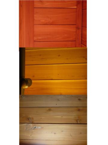

I took my Dad to a low vision specialist and learned that the fluorescents (bulb replacement type and long type) have different kinds of brightness that is measured in degrees Kelvin. The specialist said that Walmart/Homedepot do not have the brighter replacement bulb type for the brightness needed for my Dad. Special light places have the brighter bulbs. I brought one of the bulbs and the colors are closer to real than the yellowish lower kelvin temp ones.
Attached is a regular incandescent light bulb top, and a Walmart florescent bulb middle, and the special higher degree kelvin florescent bulb bottom.
The cedar is exactly the same color but at night with the lamps it looks like I have three different stains. The bottom is the color closest to the sunlight color and is the easiest light for my Dad to read by.
There is a brighter degrees Kelvin bulb but it is too harsh on the eyes like bright sunlight. I'm sorry I don't have the degrees numbers for you right now but I hope this helps with a goggle search.

Don, what you are describing is the "color" of the light measured in a index called kelvin. The warm white or yellowish hue is 2700K. The cool white bulbs that were so common in 4' fluorescent were frequently 4000K also known as "cool white" I believe that 2700K is about as low a temp as they go but on the higher bluish end they go well above 4000K. There is a color rendering index that indicates how accurate the color is. Stores use different temps based on the product they sell. Myself, I prefer the more yellow light of 2700K. Sometimes the lumen (brightness) is slightly less per watt, but still quite efficient.

RaT, I just looked at the base of the floresent bulb (the bottom picture), it says 6400K. That is the K best for contrasting colors for reading for people with macular degeneration.
