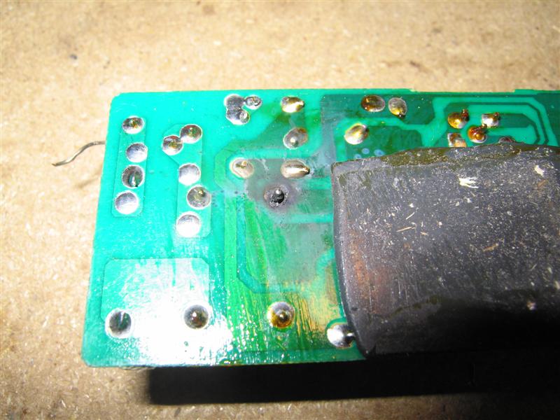

I have a fixture in my kitchen that has four T8 bulbs (32w ea) 4' long. I have replaced the ballast twice in the last year.
I checked all the wiring from the breaker to the fixture including the switch and there are no loose wires or bad connections. Currently the light won't come on. I tapped the ballast and the light flickers and then goes out.
I have been using Advance brand ballast (made in Mexico) model REL-4P32-SC. I checked online and that appears to be the right ballast for 4 T8s.
Can someone recommend a good brand ballast (preferably made in the USA) that will last longer than 6 months. Or maybe I'm missing something here on the troubleshooting side. The bulbs all work but could one be bad somehow causing the ballast to go out?

Inspector507 said:
Some lamps need to be within 1/2" of a grounded metal surface or they won't start properly.
Well, the ballast is screwed into the sheet metal frame of the fixture which is grounded so I guess that fits the bill.

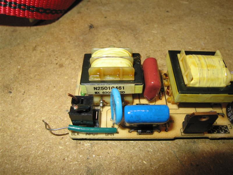

Anyway, took apart the old ballast and on the underside of the circuit board, one of the solder joints was burned which went to the transformer all the way on the left of the photo. See photos.

/ Fluorescent T8 Ballasts #8
Good pics. I would call that overheated. Probably a poor solder joint to begin with and a higher resistance connection that generated more heat. This becomes a downhill slide with more heat deteoriating the connection and generating even more heat. An overloaded ballast, not really designed well for it, driving 4 bulbes instead of 2 could have contributed. You might be able to clean up and reflow/resolder that connection.
I won't bother with that. I switched over to two ballasts to distribute the load. This one is headed for the trash heap along with all the other poorly made junk.
