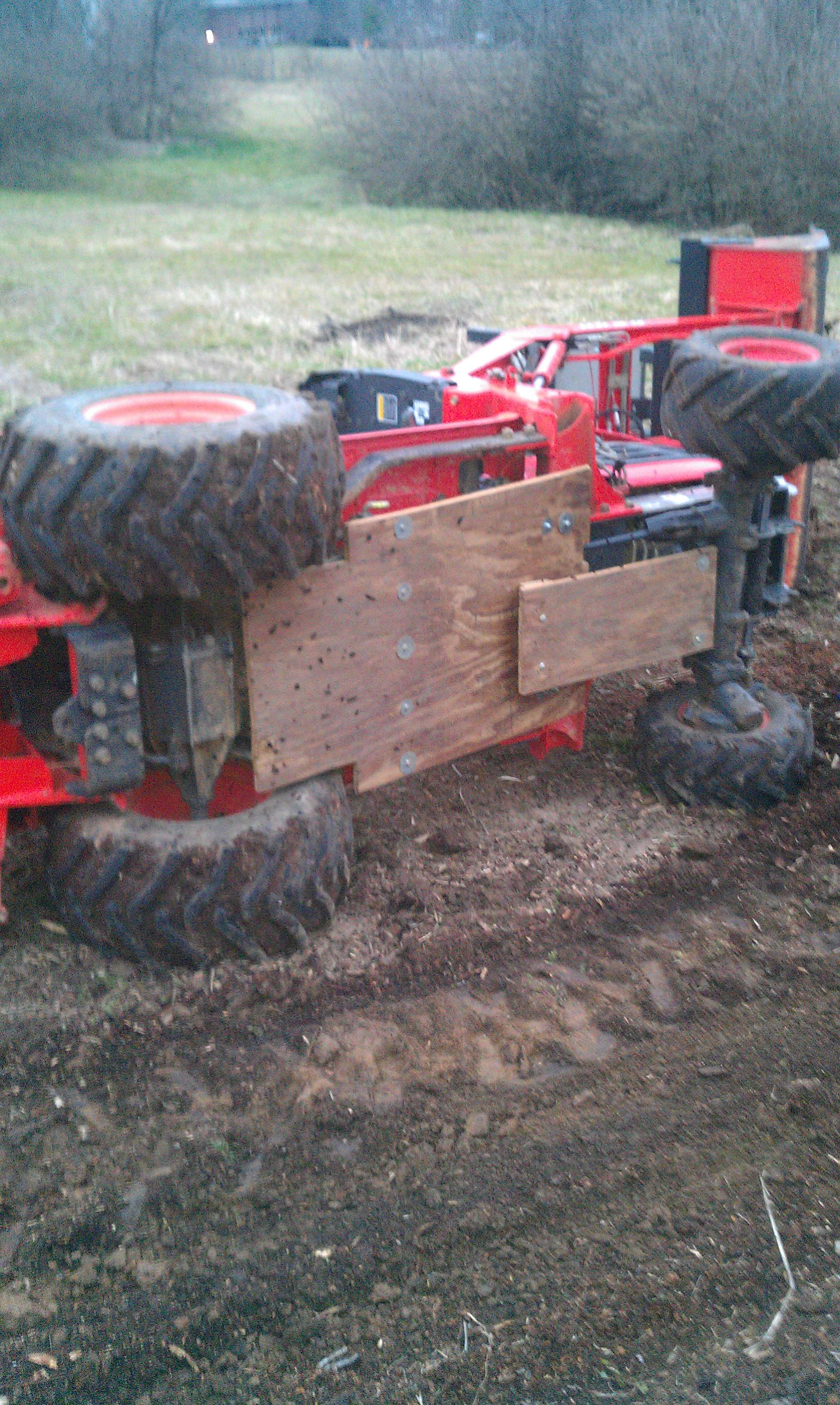

One of the front tires (Ag tires) on my BX23 got a thorn thru the sidewall for a slow leak.
Help please.
I had a cut nail (the type for nailing into concrete) stuck in an Allis front tire for about a year before I got around to fixing it. I keep plenty of slime in the tires due to thorns. Everything would work great as long as I remembered to park the tractor with the nail down. If I didn't remember, after a couple of weeks of setting in the barn the tire would go flat and I would have to pump it up. All that to say, I had to park the tractor so there was slime around the hole or air would eventually leak out. If the hole is too far up on the side wall you may have to park the tractor like I show on the attached photo once in a while in order to get the slime to keep the hole sealed.

I get an invalid attachment error, but I think I get the idea. Slime never solidifies and will flow away from the hole. I can say that if my results are the same I will have to do something else. I know I will just not always park with the hole downhill.

If it was me I would do just like Randall suggested. Plug it with a boot type plug. What do you have to loose, a few bucks? You could check a few tire shops and ask if they do heat cure vulcanized patching with a boot style plug. You can still put slime in it afterwards.
