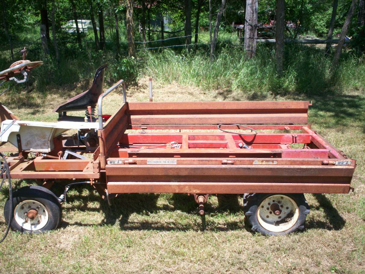

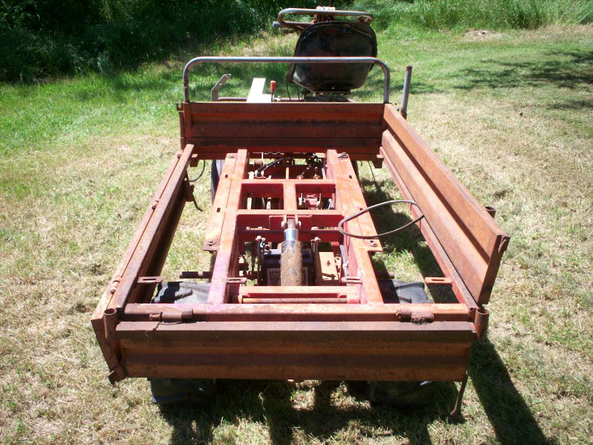

   / Folding sides for a Flatbed #3
This is only about 5', but maybe you can adapt to your needs.

   / Folding sides for a Flatbed #4
I made "piano" hinges out of 1/2 pipe and made removeable pins out of round stock.Made the same thing for all four corners. I used pipes for stake side bracktes. Also put half hinges on the end of the bed,Now,I can pull the pins and move the sides to the matching half hinges on the rear and use them for ramps! Good old boys at the shows scratch their heads and wonder why they hadn't thought of that. Did much the same for my dump truck.
