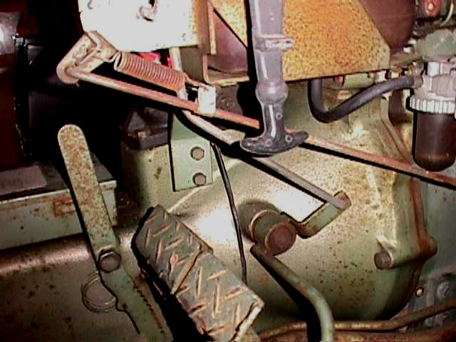

And another
/ foot throttle #32
Another............hope this helps

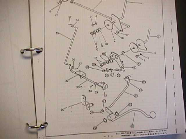

/ foot throttle #33
Chris,
This is a pic of the parts book (scanner on the fritz) from your tractor, the green side-mount headlight YM1700

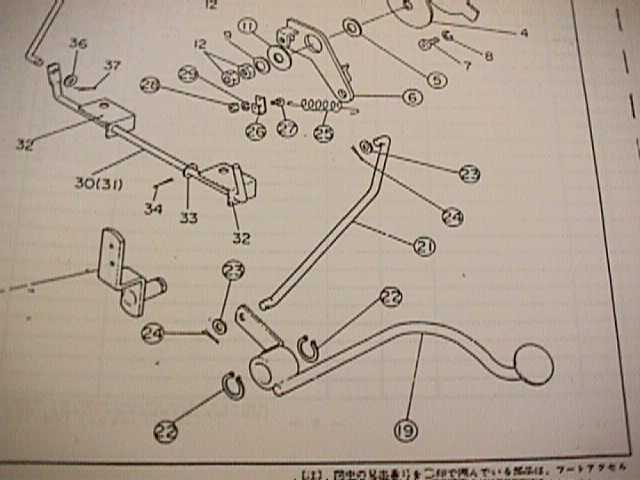

/ foot throttle #34
Parts book pic
(Maybe I'll make Gold Member sooner now /w3tcompact/icons/laugh.gif )
/ foot throttle #35
Roger, anything is possible - this Yanny had been rode hard and put away wet before I paid too much for it. Unfortunately it is about 4 hours away, and it will be another week or so before I get to go play with it again. I've looked at some of the throttle pix in this thread, so I will see if anything has been removed from that region (also, I couldn't locate a thermostart bowl, so I don't think I have that either).
Bob
/ foot throttle #36
Bob, don't look too hard at those pictures of the 1700's foot throttle in order to compare them with your YM155D. The US models had a completely different type of foot throttle parts and mounting. It tucked in much closer to the floorboard and pivoted inside a bushed bracket that was bolted to the underside of the floorboard.
The parts book lists both the thermostart and the foot throttle as optional systems, but according to the adv literature both were always included on the US models.
Both were available as kits.....and might still be for all I know. One of the dealers could probably get you a price. The throttle kit is #794340-01450.

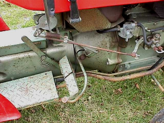

/ foot throttle #37
Chris, Here's a daytime pic of the foot throttle on my Red 1700. BTW I got seat time today YEAH. Got it all muddy tilling too.
/ foot throttle #38
Nice pic. My hand throttle is set up a little differed\nt than that... but the post is unmistakebly for a foot throtte.
Question.. do you push to kill, and pullto throttle up?
Chris
"Chris, Here's a daytime pic of the foot throttle on my Red 1700. BTW I got seat time today YEAH. Got it all muddy tilling too. "
