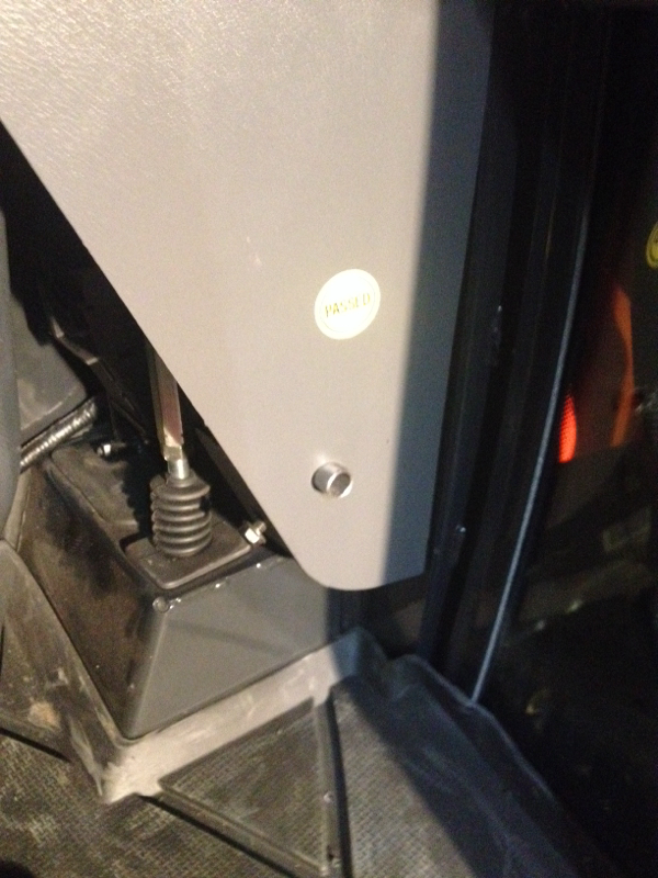

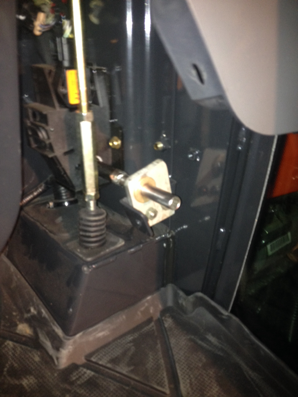

Finally started the foot throttle relocation. I have the new support and extension done, just have to bend up the new rod and slide it into the tube. Funny thing , after removing the original pedal out of the way, I started trying to find a comfortable location for the new pedal by setting in the seat and placing my foot over where it felt comfortable. After deciding on a location I was going to mark that spot on the floor mat with masking tape, while doing so I felt a " soft " spot in the rubber mat where I placed the tape. So I raised the mat up to see why and low and behold there is a " knock out " in the mat and a cut out in the vision pad under the mat not sure if that mat is used on models that have a floor mounted pedal. Any how here are a couple pics of my progress.

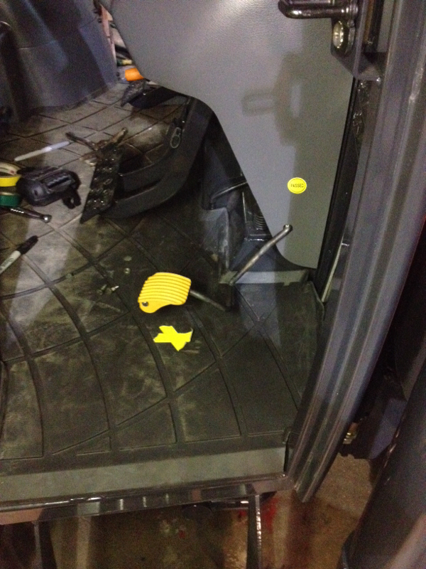

Finished up a pedal that seems to be really comfortable, we will see. Here is a pic before paint and final install.

Good to see you getting the job done, CB. Since I relocated my pedal, I don't think I've used the hand throttle at all, except when setting the RPM for running the backhoe. The pedal is still not exactly where I want it, but 10 minutes with a torch & a slight change in one bend will get 'er done. It's like a different machine now! Looks like you are doing a way prettier job than I did.
Now, I just need to get the seat to move 2" further back & it'll be perfect.
Enjoy!
