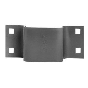

Now on to the handrail. Very rocky so don't know if I can sink a post very deep. It will be hand digging. Not sure if just fastening some uprights to the bridge will be sturdy enough. I've thought in the short run about driving steel T post in and attaching a rope.
   / Footbridge safety ideas needed #14
Could you use some wagon side stake brackets? Drill holes to hold wooden stakes and just put a top rail on them. For stability you could cross brace with wood or cable tensioner.
