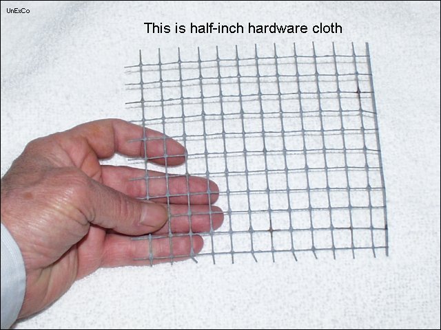

Of the most easily available material, I think I would choose 1/2 inch hardware cloth.
Bruce
