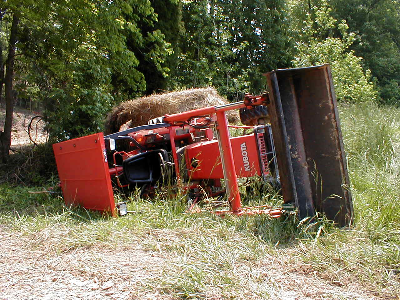

Because equipment, accessories and recommended usage methods fail. In my case, the bale was fixed to the forks with a heavy duty ratchet strap and when the lift arms unexpectedly and uncontrolably went up rather than leveling the forks the bale was virtually launched out of the restraint.
So, did the strap fail? If so, which direction was it wrapped around the bale in? Any pictures?
A properly sized and tensioned strap going around a pair of non-flip up forks (forks like this or this, not this) should not come off no matter what your loader does.

The strap was secured over the top of the bale and around the forks, side to side and did not fail. When the forks/lift arms reached the top of their range the bale strap was nearly horizontal to its starting vertical position and was catapulted out of the restraint. They were not flip up forks
