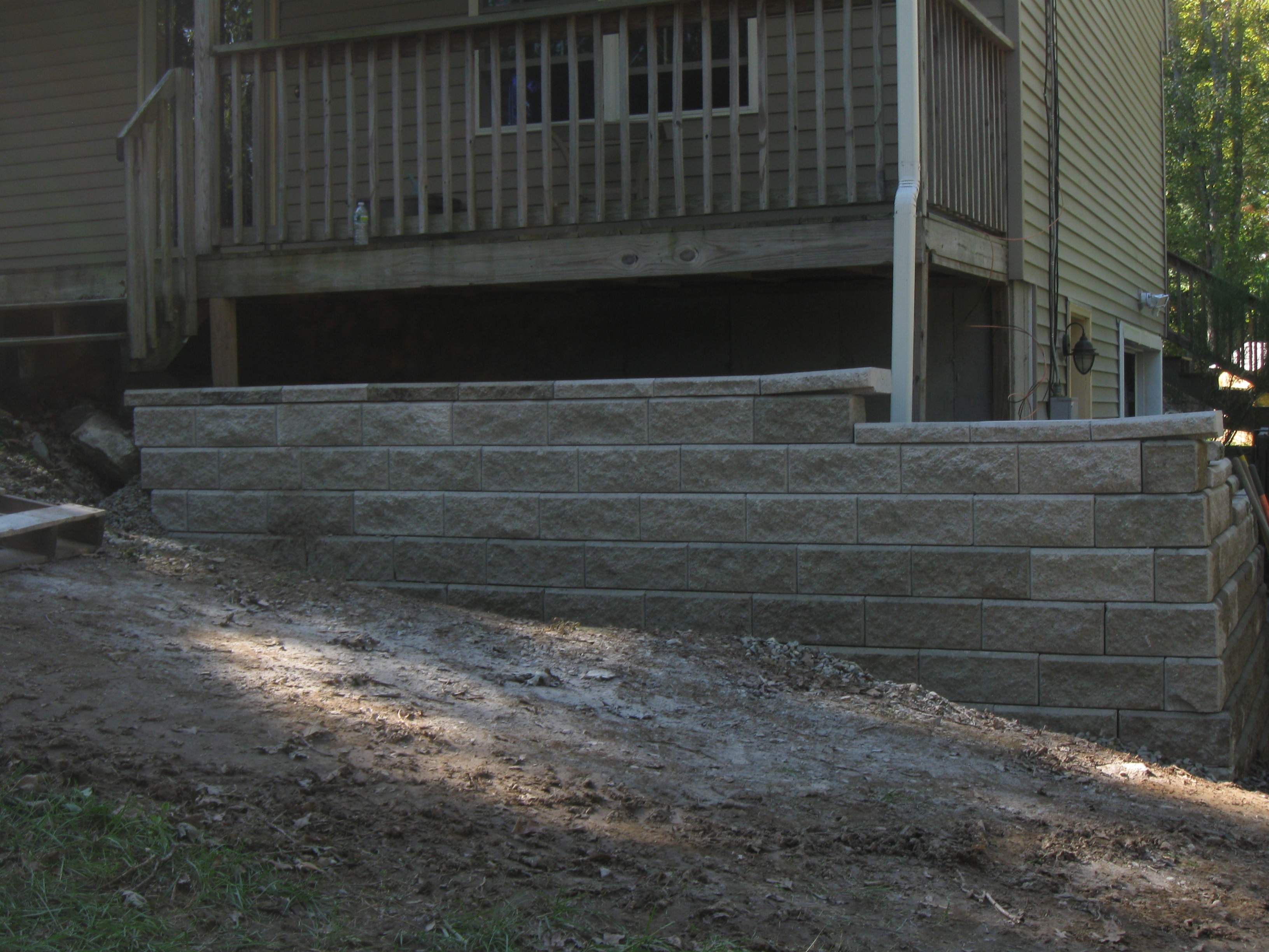

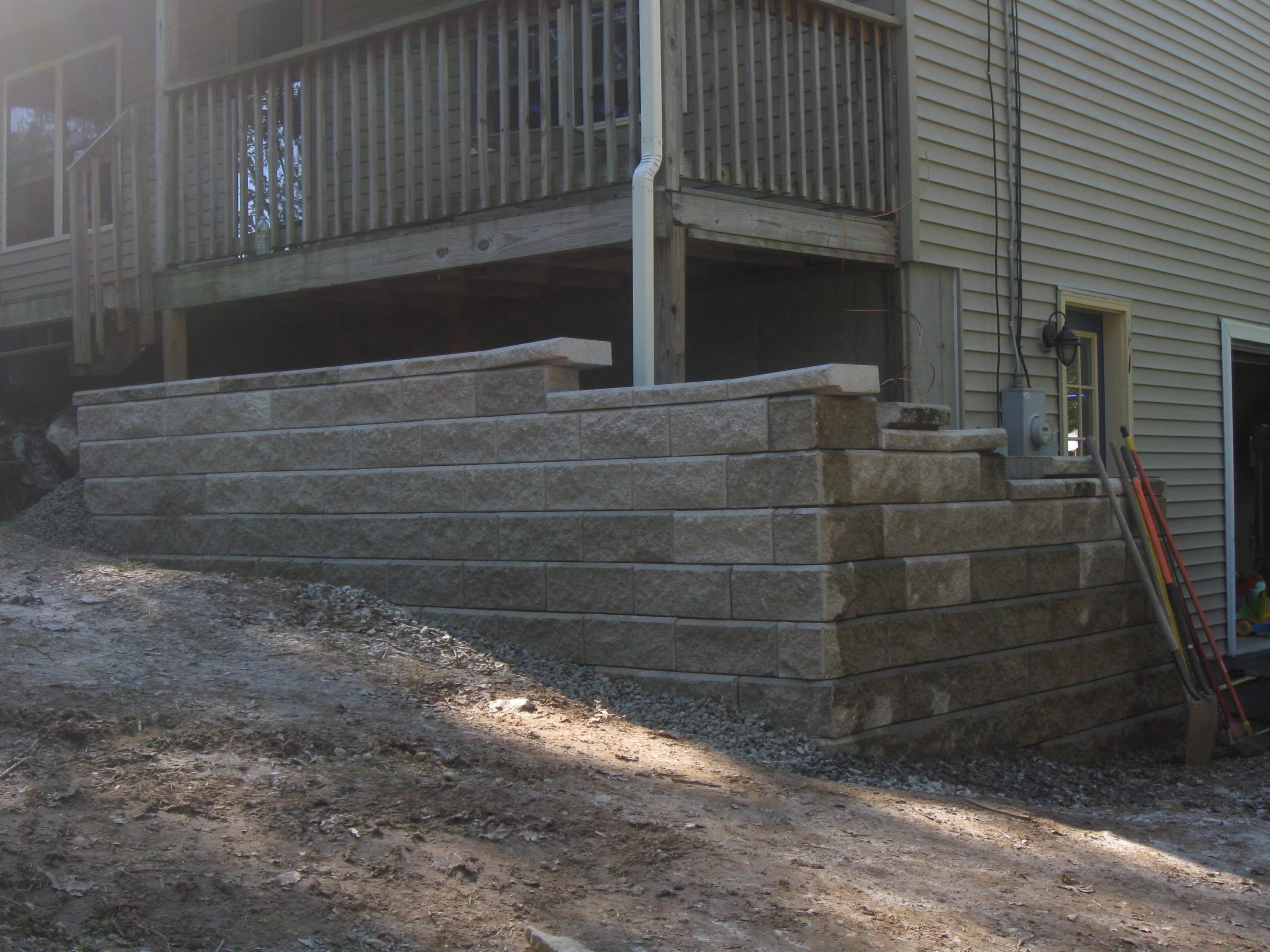

As promised here are the nearly finished wall pics. I should probably start another thead but too tired at this point.
JB these blocks do step back and are good for mass/gravity walls due to the weight. The brand is Allen Block but I'd look for Versa lok instead. Theses have some dumb corner blocks. They're also inconsistant as much as 1/4, which doesn't sound like much but adds up over the courses.

Matt,
How much clearance do you have on each side of the electric meter?
Can you cut those caps with a wet saw? I typically will score the caps and split them with the cut side on the inside joints. I laid about 900 62# retaining wall blocks for my new shop foundation this year, that was a good work out for me.

Hey Steve, yes the caps can be cut with a wet saw. But the guillotine is the best for making it look right. I'll post the finished pics later on today. If you cut them you have a smooth face and since the rest of the wall is rough it looks funny. There's a few feet clearance on the meter also. Lifting these blocks gets old real fast. I swear some felt more like 100lbs.
This is the second wall I've built with them, the other was and inside corner so you don't need to use the corner blocks, you just cut the lip off the stretchers. Next I'm going to build a stairway along side this wall but I may wait till spring out of time and $$$ at this point.
