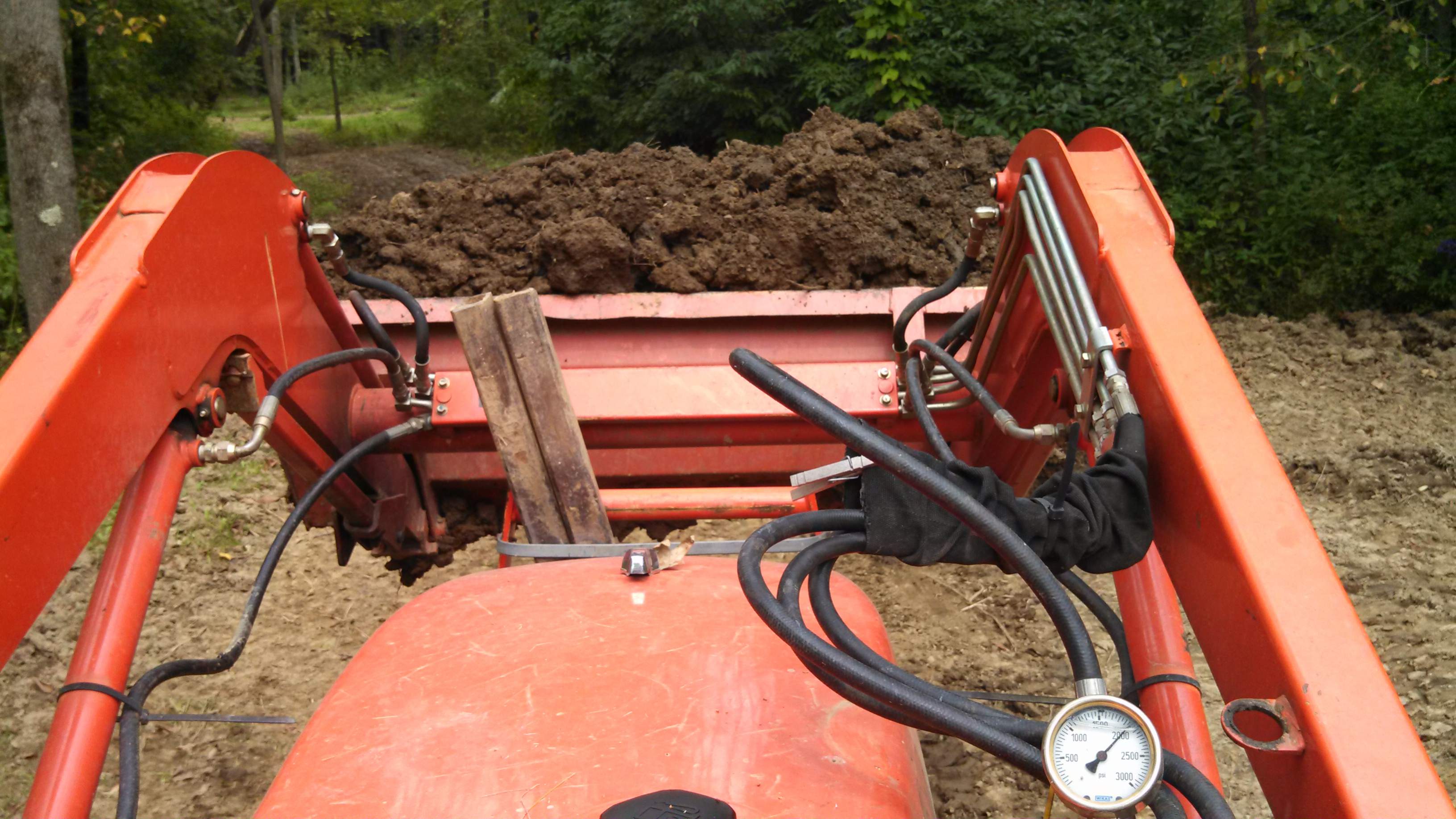

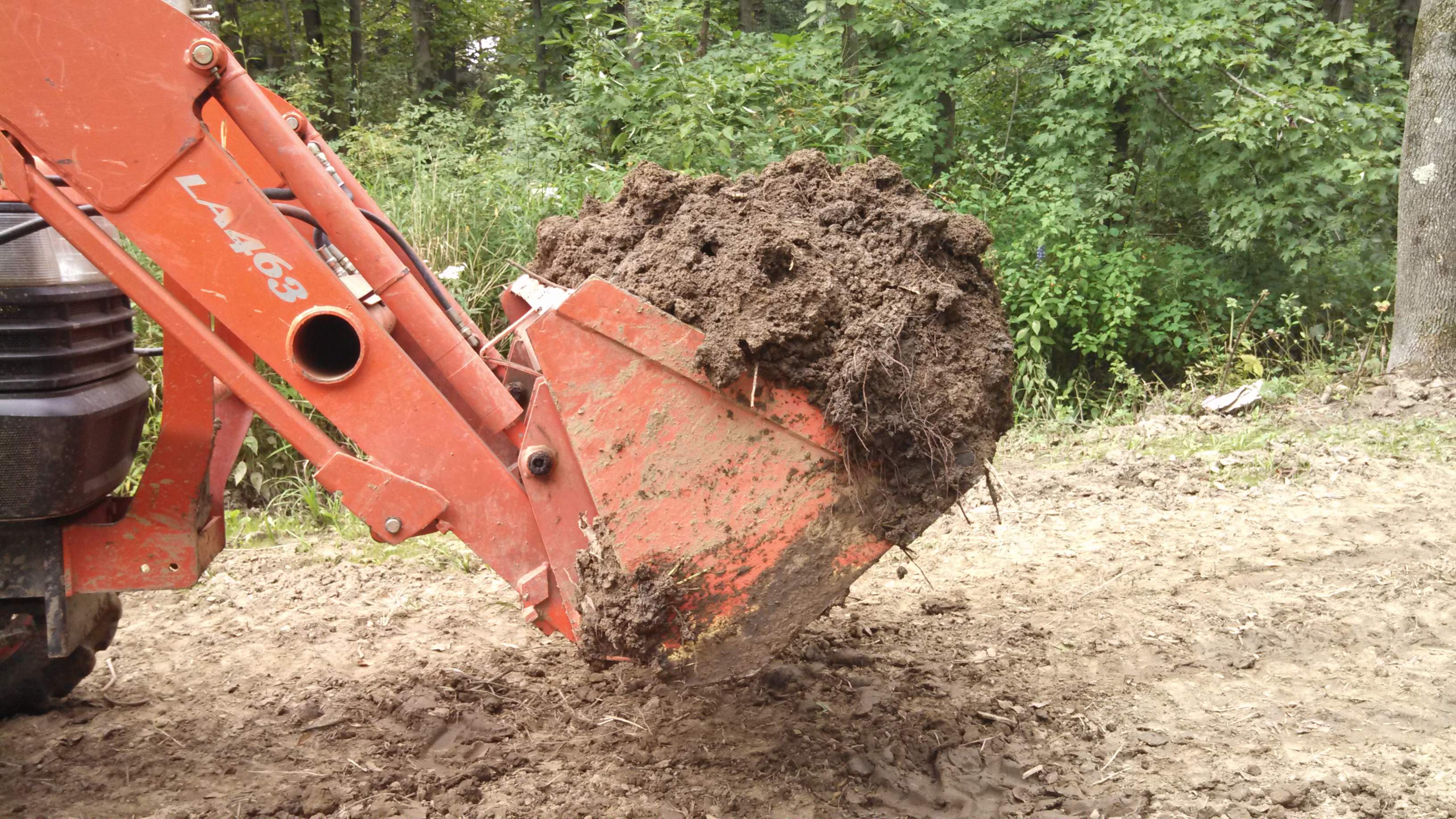

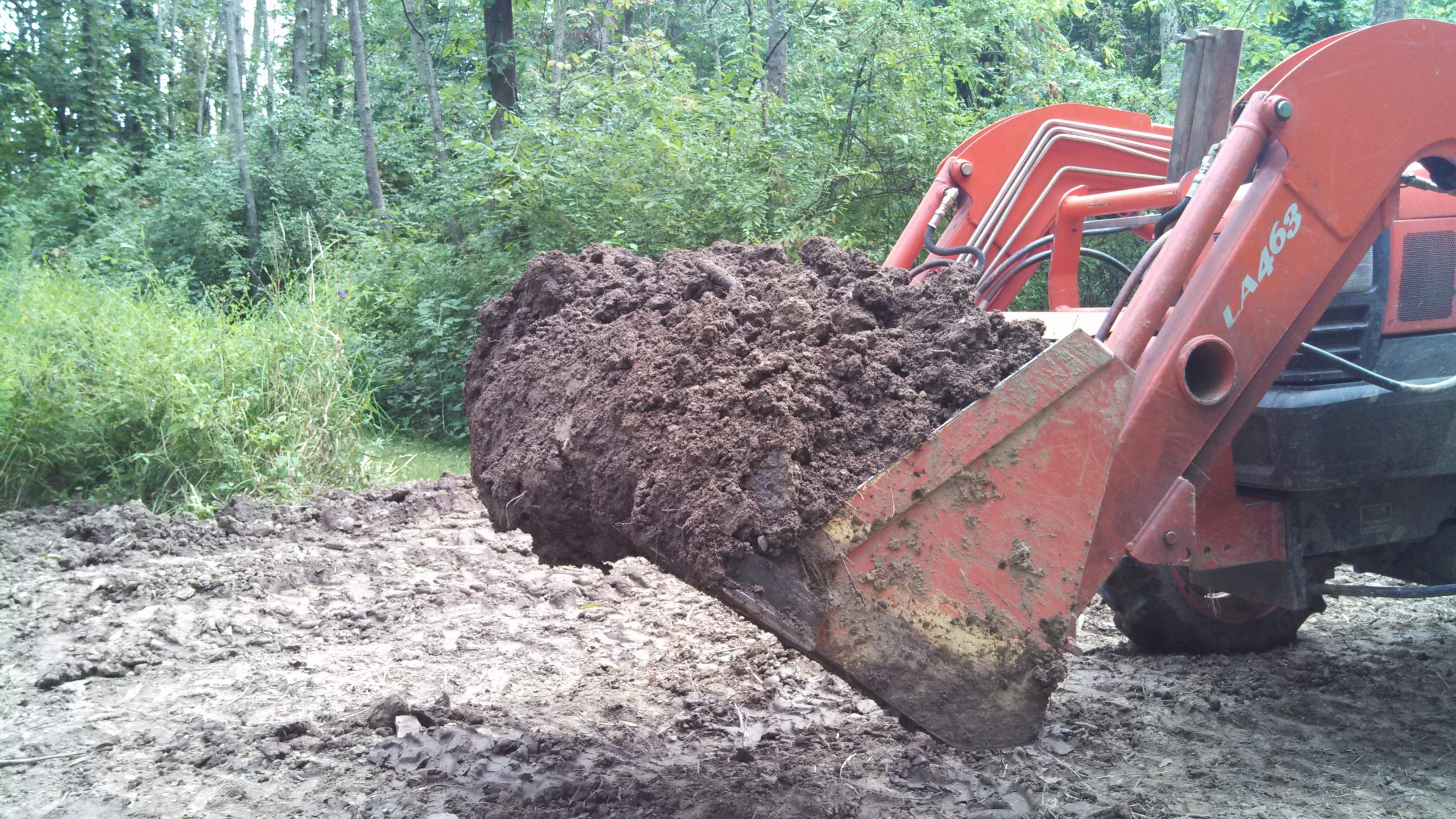

Moving some dirt today. It amazes me the number of times I hear people mention that the L3400 (2800/3200/3400/3700/3800) have weak loaders.
Who needs more lift on a CUT??? Mine has never failed to lift anything I have tried.
I have a 700lb blade on the back and loaded tires for ballast. And even this load was tippy under the right circumstances (downhill or stopping).
the last picture I made sure to include the pressure gauge. It takes 500PSI just to lift the loader frame and empty bucket. I have 2500PSI to play with. So at 2000PSI, this load is only 3/4 of what I "can" lift. And bota lists my bucket at 8.1 cu ft struck capacity. So I'd venture to say I had darn near half a yard on there (13.5 cu ft)
I certainly dont know what I would do with a spec of double what mine is rated for. It would be usless to me except for bragging rights.
Certainly not a weak loader by any means. Just might not have a "bragging rights" spec.

Nice point made, I like the gauge, is that a permanent mount? Does the gauge fluctuate when picking up different loads based on weight?

ITs mounted with a quick connect and a tee. I leave it on the lift circuit, but the way I made it, I can hook it up to any of the 4 functions. Or I can remove the tee completely, and hook the gauge direct to any port.
