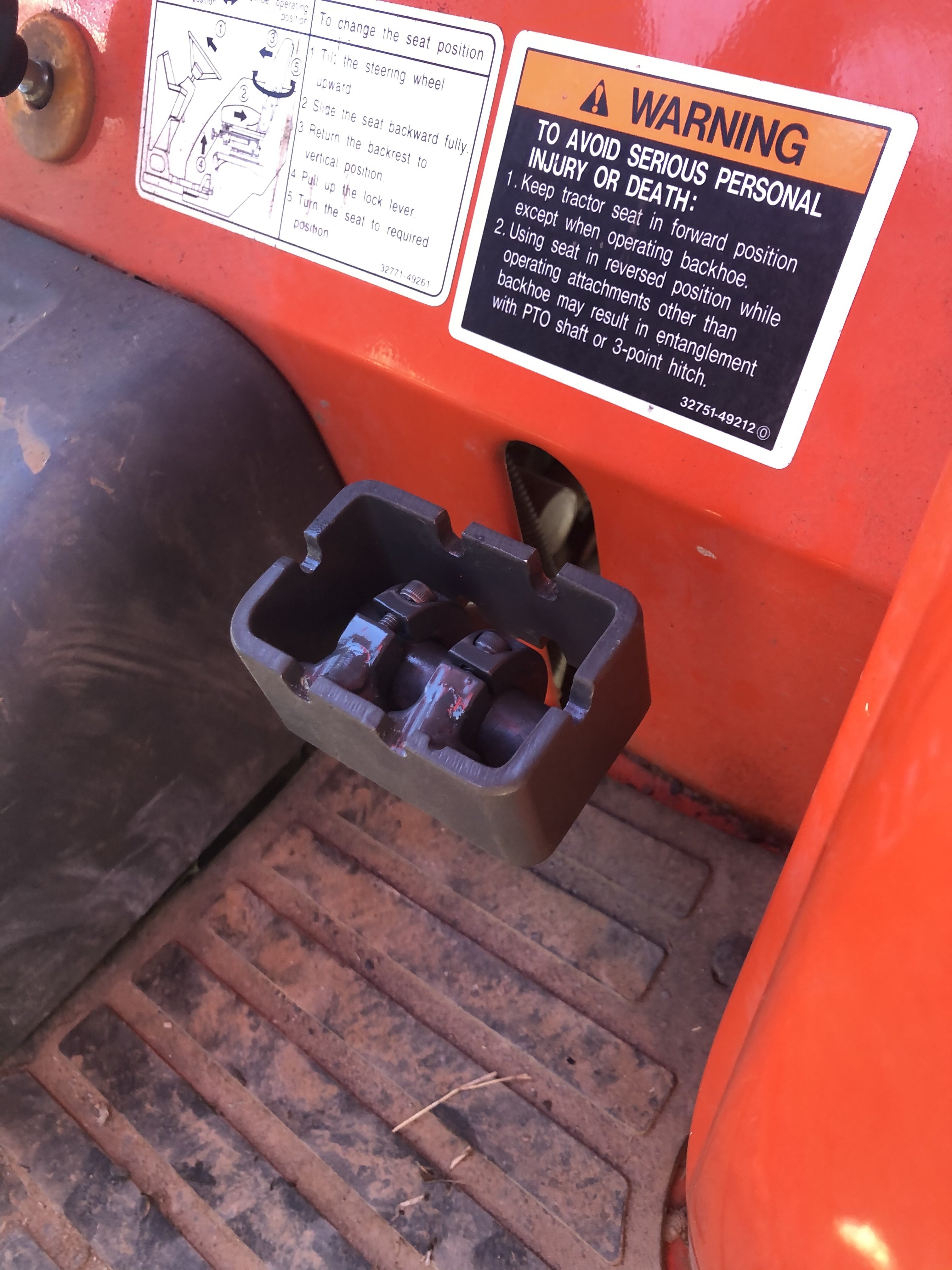

I'm of short stature with lower back/sciatica issues and need to modify the uncomfortable long-reach HST pedal on my new Kubota L4060. Can you tell me how you did yours in the photo?
It's a piece of 1/4 x 2 x 12 aluminum stock (Lowes?), grip tape and two 1/4 " carriage bolts. Still working great.

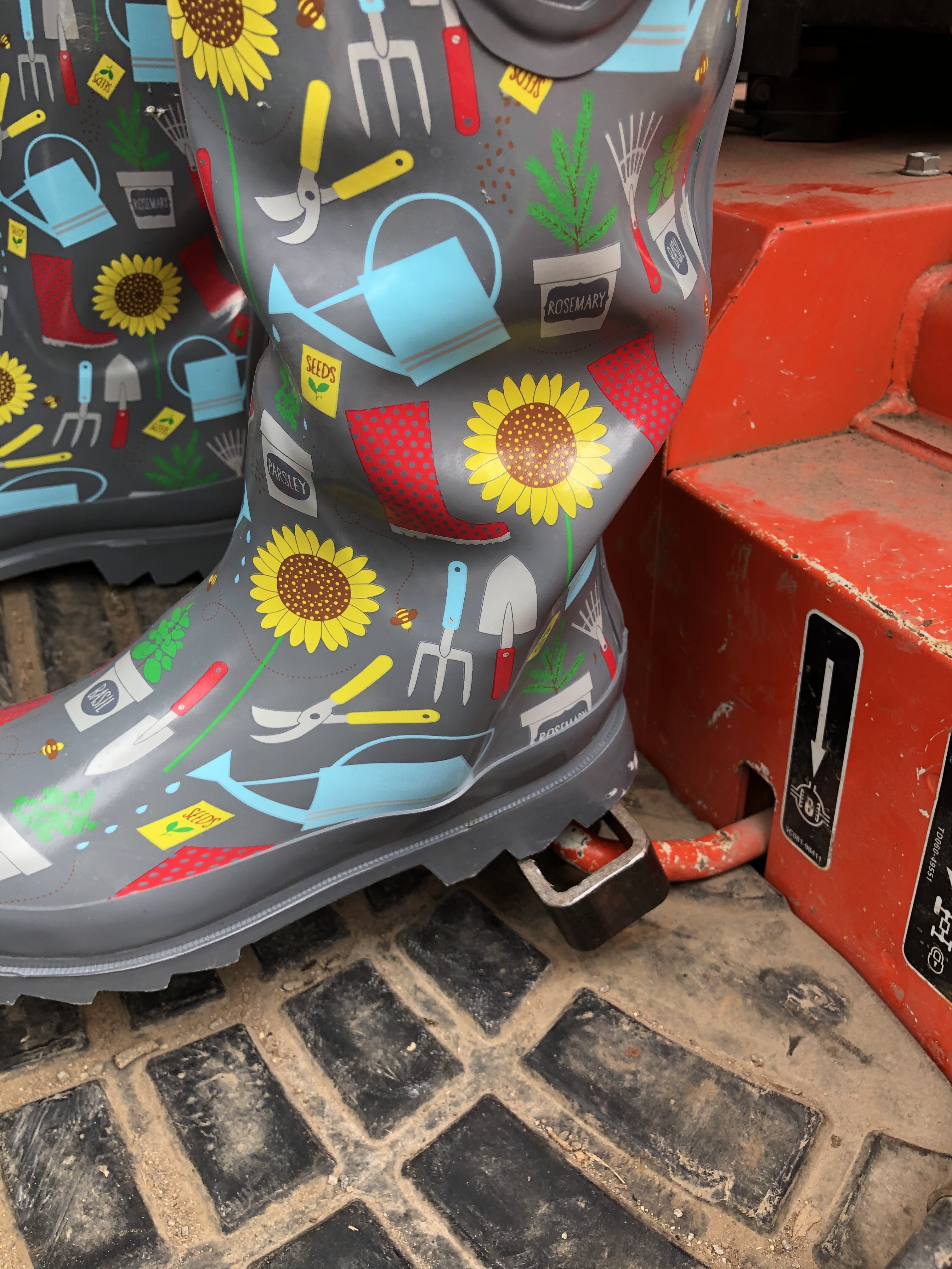

Used some scrap tubing and shaft collars to improve the differential lock pedals. Often used on our hillside farm. Remember to fully engage. Helps with muddy boots and wife to use effectively.

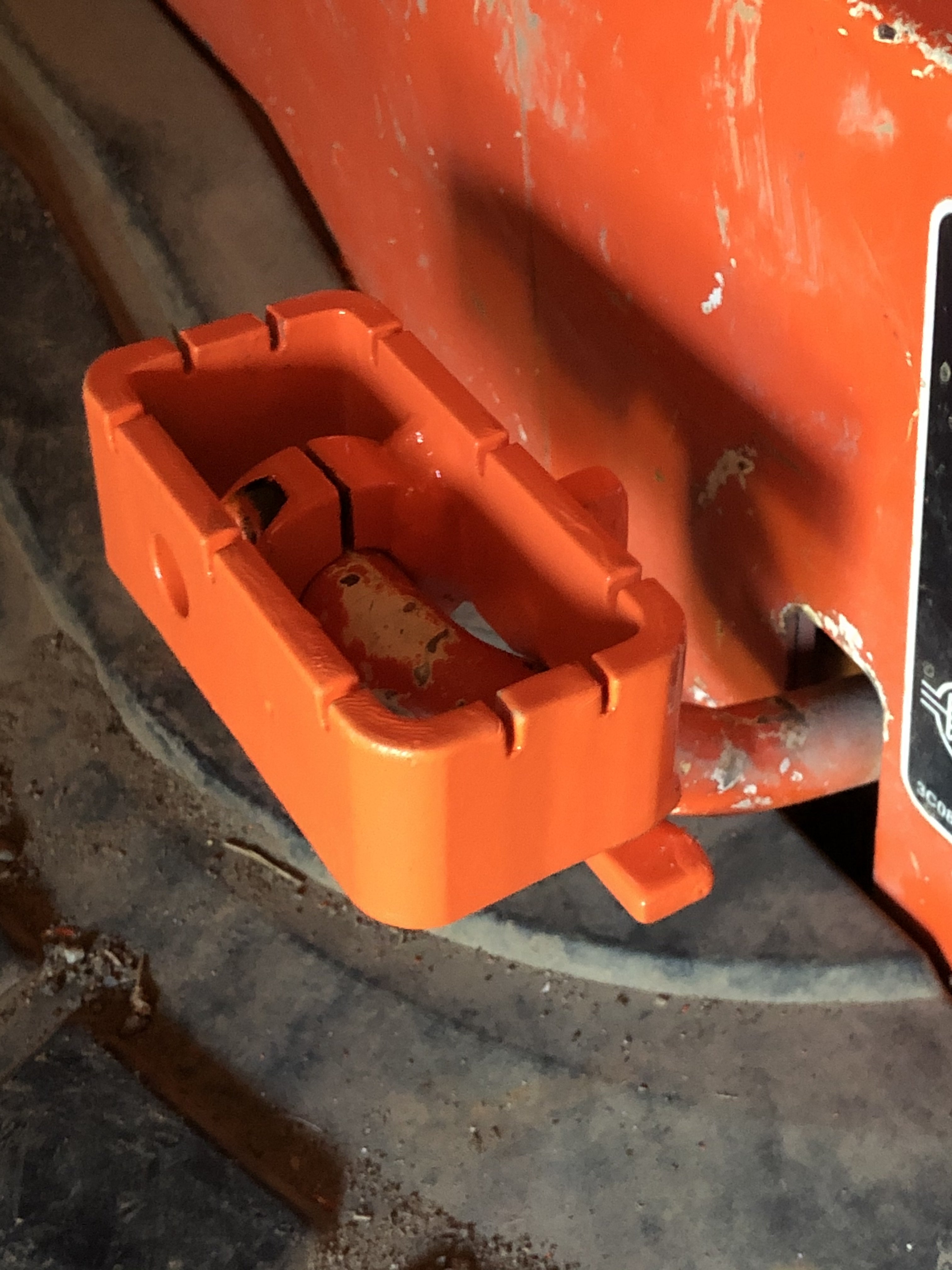

The MX diff lock is a hand operated knob in the same position but it stays in whatever position you select until you select the other position. Being as it is pull up to lock I usually unlock by pressing down with my heel. Not ideal and I've thought about extending the lever upwards so it is easier to reach. But I've lived with it for 250 hrs so far.
The treadle pedal is another story. I really don't like it. Currently I have a 1x3 stick tie wired to the front tread to raise it 3/4". The jury is still out on what is needed to make it ergonomically acceptable.
Once I turn in the seat for reverse work I end up with my toe on the back section. That's not ideal

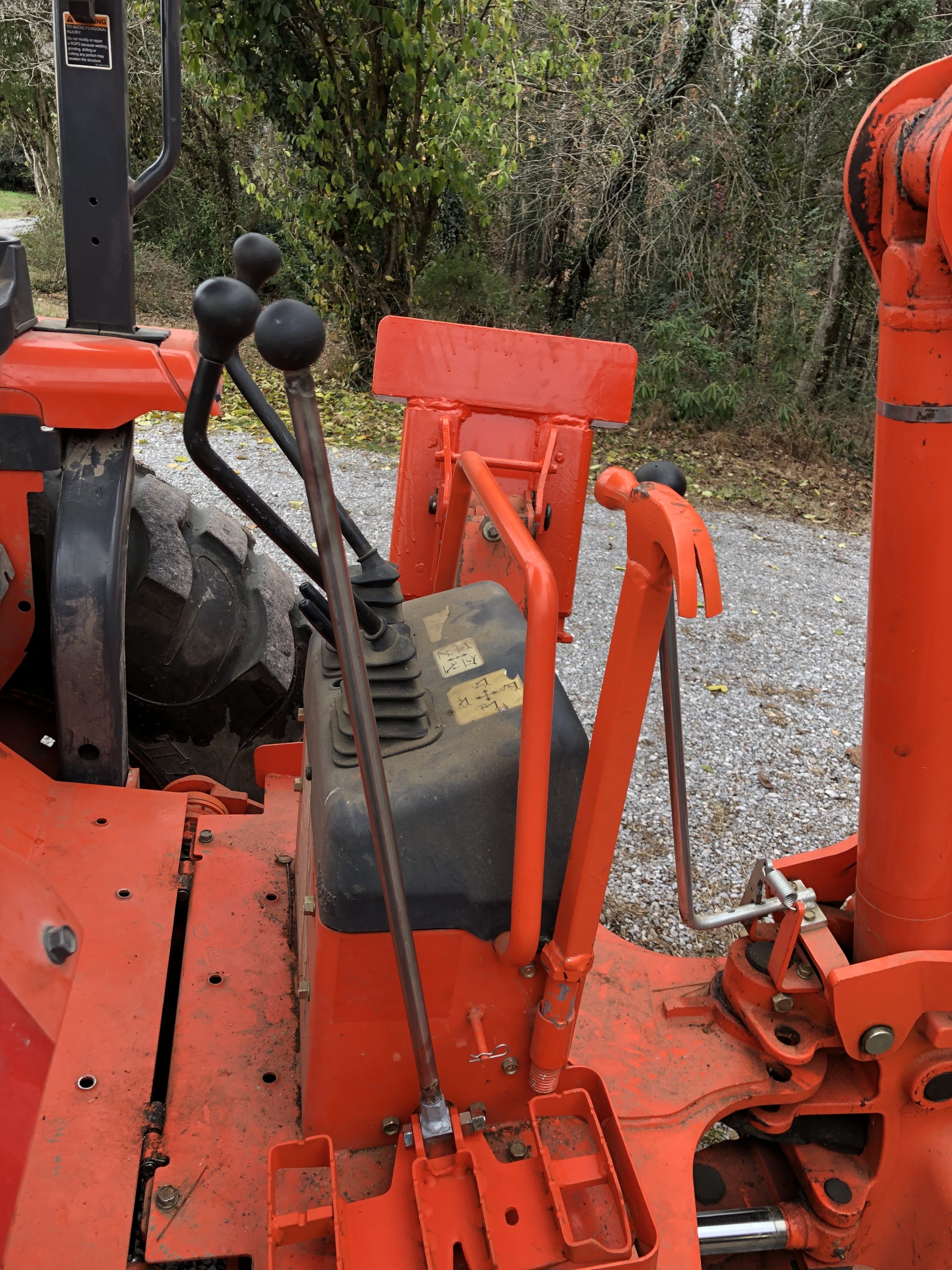

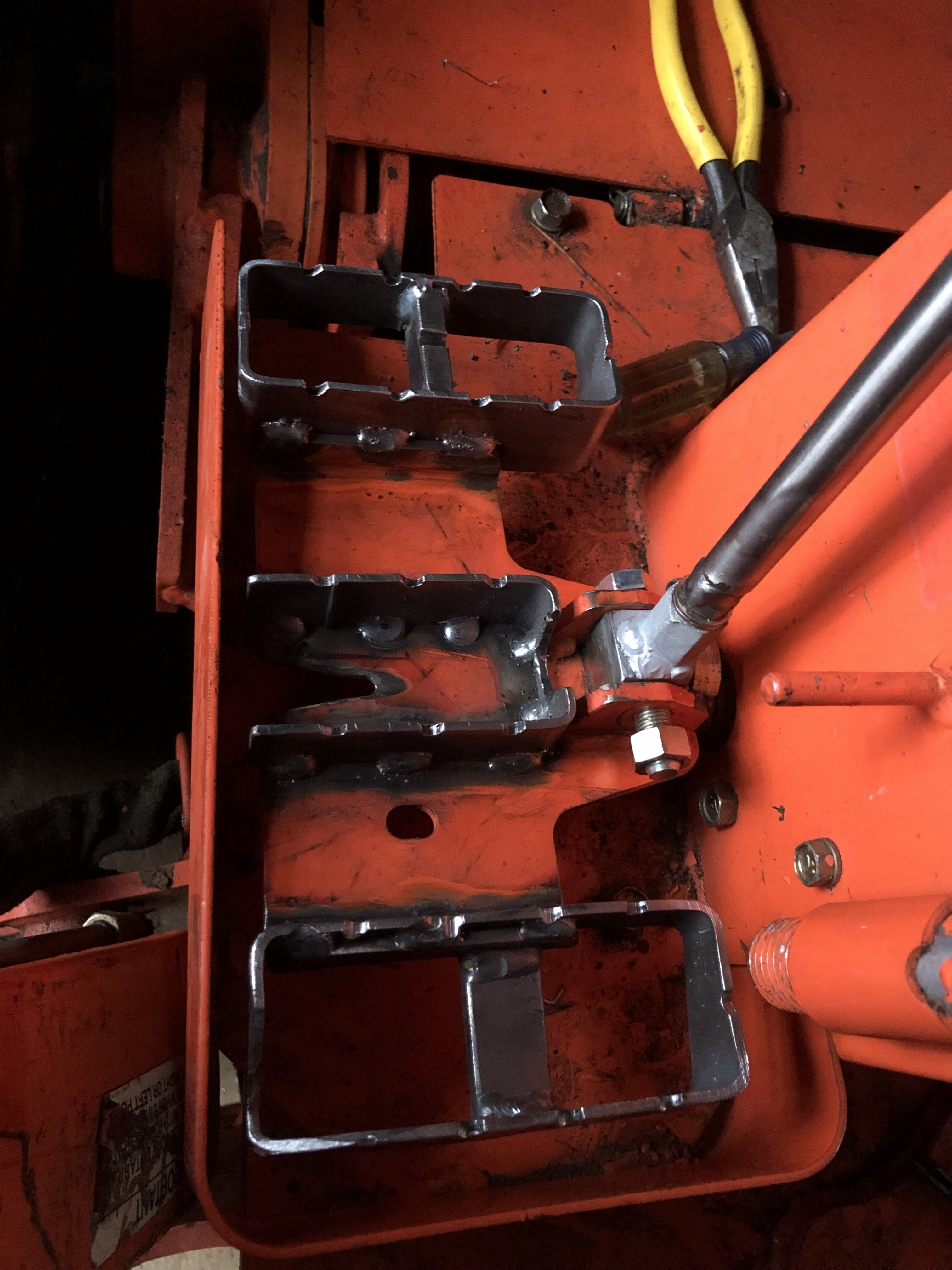

Not afraid of improving ergonomics to improve operational use. Treadle pedals on B26 and M59 TLBs are okay. M59 bushhogging requiring constant varying due terrain and load is acceptable for hours.
Never was comfortable with the M59 backhoe thumb control pedal. Modified pedal and added a hand control option to help my limitation. Pedal still folds and lock. Funny the B26 OEM backhoe thumb peddle is similar but more comfortable to use.
