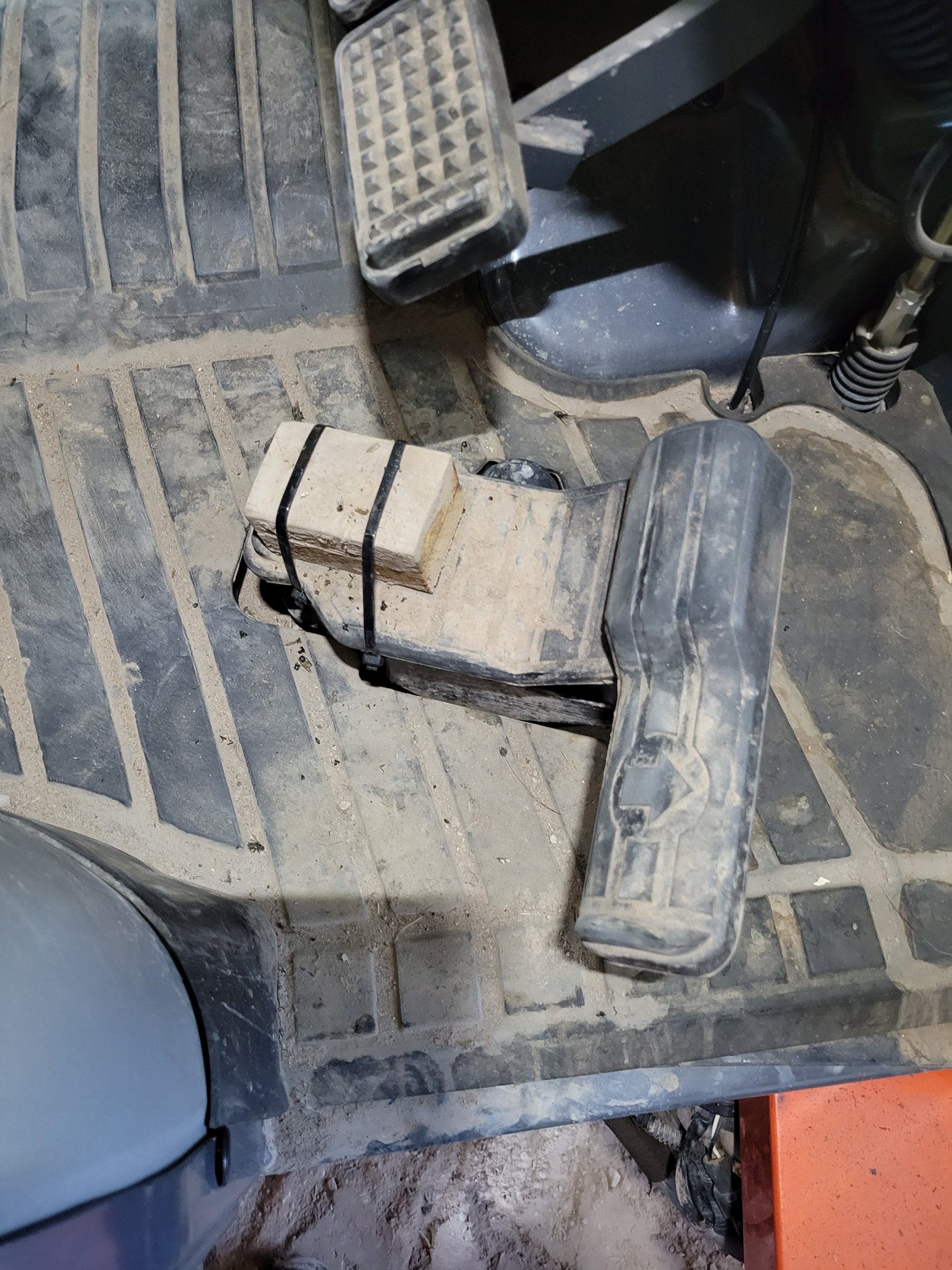

Screwed that one up. I have arthritis in my ankles also. I use the wing to go forward and press on the bottom to back up, but the bottom is too low so I added with tie wraps a couple of one by blocks.
This is a Grand L and it has a clutch, bought it in 2012.

Because of arthritis in my hip I had a real issue with the treadle pedal. This was my solution. I use my toe for forward and reverse, much like a two pedal system.
I'm of short stature with lower back/sciatica issues and need to modify the uncomfortable long-reach HST pedal on my new Kubota L4060. Can you tell me how you did yours in the photo?
