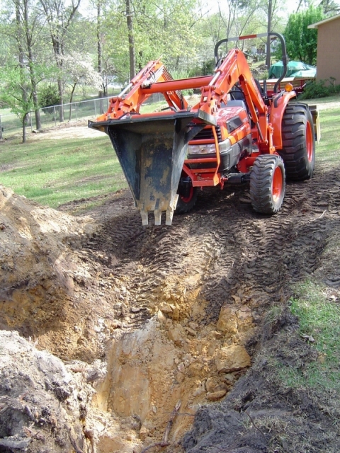

For 4 inch stumps either a toothbar, forks or even a subsoiler would do the trick with either the MX or DK.
For 10 inch stumps that were cut low eough that you could drive over the stump with the tractor , you could certainly rip the roots with a combinatiion of subsoiler and either a toothbar or forks on a strong loader to dig out the stump.
A stump bucket or grapple would obviously work too although with the bigger stumps you'd probably need some help from the subsoiler.
