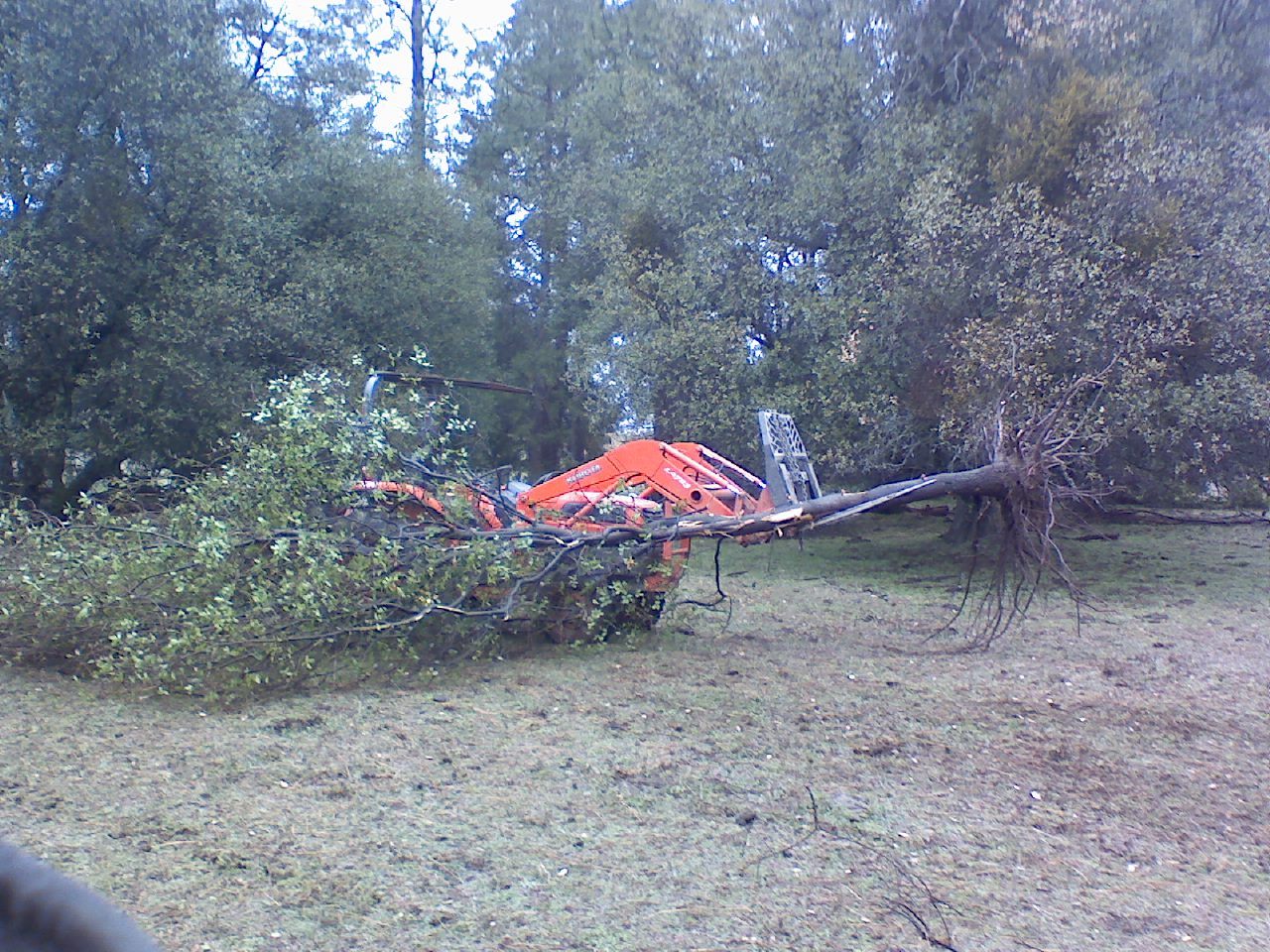

For most things on my familys 66 acres we can get away with our two 30hp tractors. For big stuff it is best to go rent a big backhoe. Once you use something like a 310SE to dig trees you will never want to do it any other way.
The best thing that I bought was 6,000lb heavy duty pallet forks with Quick Attach when I got my tractor. This lets me swap from 6' foot wide bucket to pallet forks in less than 3 minutes.
For trees under 12" diameter my l3130 with Quick Attach pallet forks, filled tires and 500lb of counter weight will push over trees roots and all.
I have even pushed over bigger ones once they rot a little bit. see attached pictures =)_
with the Pallet forks I have not been real successful at popping roots. Might have to try the tree spade.
What I have done to pull small brush is to put a pallet grabber hooked to my pallet forks at the Quick Attach mount, grab the small tree or brush and then leverage up with the forks in the ground. Works good on most small trees under 2"
I will move rocks up to 1000 lbs with my pallet forks - just set forks in close.
I have also dug irrigation trenches with my bucket. I just make a bigger trench, lay pipe and then back fill.
I must say that I have been looking at the single shank sub soiler for running irrigation lines.
Most of my stumps are Oak trees that are 12-48" in diameter. For these I either rent a backhoe or have a dozer come out. We have also had a D8 low boy come out when we cleared 15 acres of tree's.
