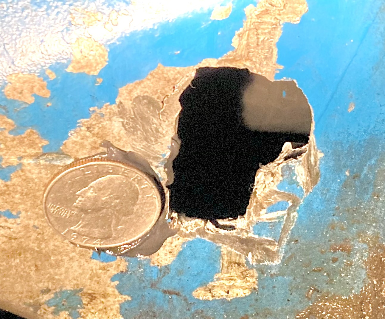

Thanks all! I appreciate this site so much! I got the brake drum off with a combo of citydude's help and the slide hammer. (Getting loaner tools at the Advance Auto is great deal!) Here is another picture of the hole with a quarter stuck next to it for size reference. What looked like a crack in the 1st picture was just bad light. I found available used parts but they're understandably a little pricey. I will take it to a weld shop first to check cost and confident level for a cast aluminum repair like this. Thanks again!

So it is cast aluminum not cast steel...lol If the shop is upfront, they will tell you the chances of a successful repair is slim. Better off just replacing the part and being done with it.

Lucky it's in a no support area. Yes cast aluminum can be welded by someone experienced in aluminum welding. I did say experienced and not a welder who seldom works with aluminum. This is non structural repair. Get it super clean and epoxy repair will be fine.

Aha, I thought t was Cast Steel, did you do the magnet test? it does not appear to be structural which is good. Atleast you have plan B , but I think you will be fine with welding one plate or just externally patching the hole.

The issue with welding ANY aluminum that has been in contact with ANY type of lubricant is, aluminum has a certain level of surface porosity in it so the lubricant migrates into the metal itself and no matter how well you try to clean it, when it's heated, the lubricant will vaporize out and cause weld inclusions. Consequently, the chance of failure will be very high. If he can replace the part, that is what I'd do. Any competent weld shop or welder will tell you that.

Most dirty aluminum has a good chance of being welded by a knowledgeable welder. It may take a bit of time to burn the oil out with the TIG arc and with brushing with a stainless brush. If the OP has located a used housing, why not have a welder try welding this one once it is off? If the OP wants to patch it, maybe form a patch out of 1/8" aluminum and epoxy it over it.
