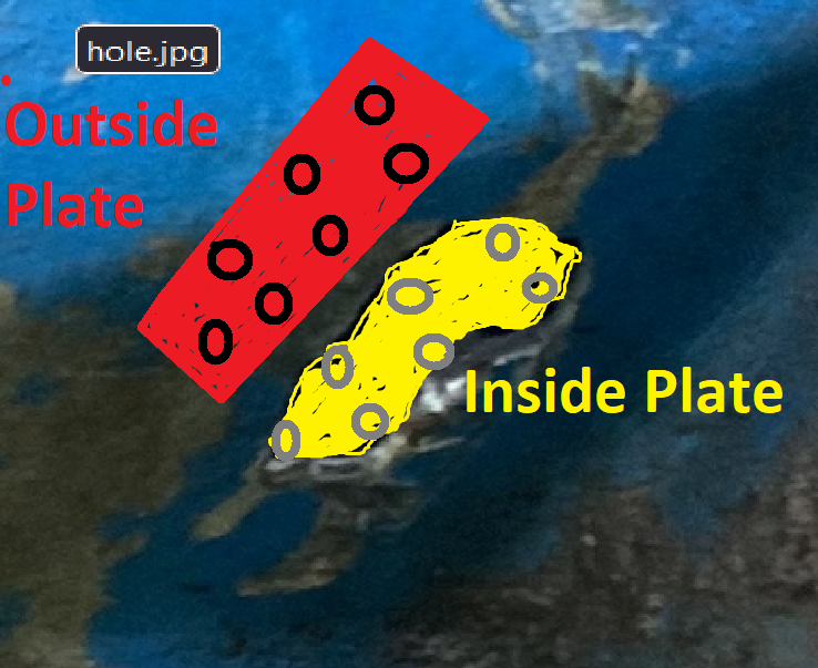

It looks like there is a little room behind the hole. I would make a flat piece that would slip up inside the hole with a some nuts welded on, and then make a larger mating piece for the outside with a piece rubber in the middle of that "sandwich" to seal it up.
In other words smaller flat plate inside the hole. Larger flat plate outside the hole. Some kind of gasket goo or rubber to act as sealant between the two. Tighten fasteners running between the two to cinch things tight. (kind of like putting a toggle bolt in drywall)

I found a used housing and bought it. It should get here in a week or so and I'll swap it in. I'll take the busted one of and see about the seals and gaskets and order them too. Once I have a spare housing though, I will see which of these fix-it suggestions would have been most likely to work at all, or last longest. Judging from the pics of the used one, there are some mold features in the casting on the inside of the part that might make some of the suggestions difficult. I'll share a progress report and final outcome for thread closure. Have a great weekend! Keep your lift arms pinned! lol!

I once fixed a hole in a vw gti transmission once, about the same size with JBweld. Cleaning both sides and roughening very well. it was in a corner so I used aluminum duct tape to hold the resin. Worked like a charm and never had a problem. On This one I'd put a roughened piece of aluminum with a bolt through it sticking outwards and fish it to the inside, then dope up with putty, then bolt another piece fitted to the outside as the outer support patch. The biggest challenge is keeping the resin from seeping out with gravity before it sets. Obviously, I would just get a good condition replacement part if I already took the time to remove it.
