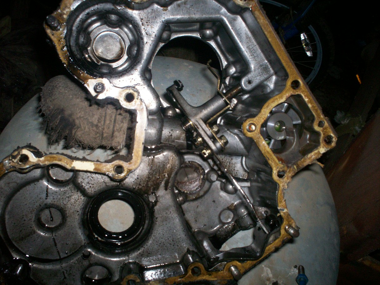

BTDT said:

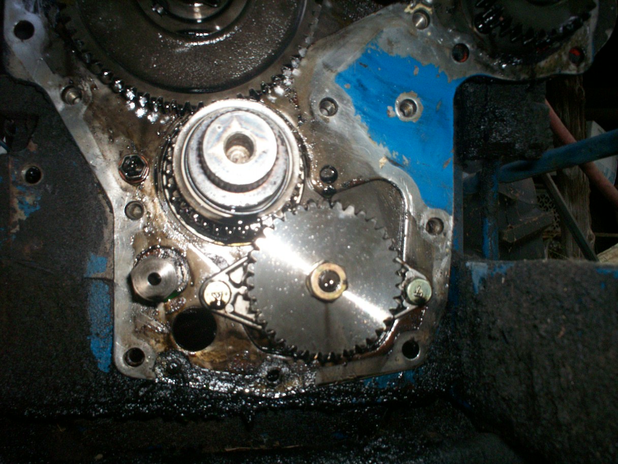

Well guys, I pulled the oil filter, cranked over engine, I have oil coming from pump there. I pulled pressure switch and went to try to find a guage. I wanted one that would just screw into block. No such luck. You have to rig up with plastic hose, fittings, etc. then to guage. I'll keep looking. Put pressure switch back in, hooked up air hose to filter mount, and blew air into who knows where. I could barely hear a little air escaping from top of head down hole where lifters are. This is the normal oil path, but not much air coming there. So, I pulled timing cover off, and lo and behold, no oil tube. There is a bolt with a copper washer screwed in to where I think one end of the tube should mount, but don't know where other end is to go. I guess I'll have to buy a tube, then try to see which holes match up.
Here are some pics of the front cover off. Not much to show, but there is no oil tube. Next week I will go back to dealer and see if I can order one, with bolts, get a gasket set, and put back together. The inside of the front cover doesn't have any oil galley in it, so we'll see what happens.

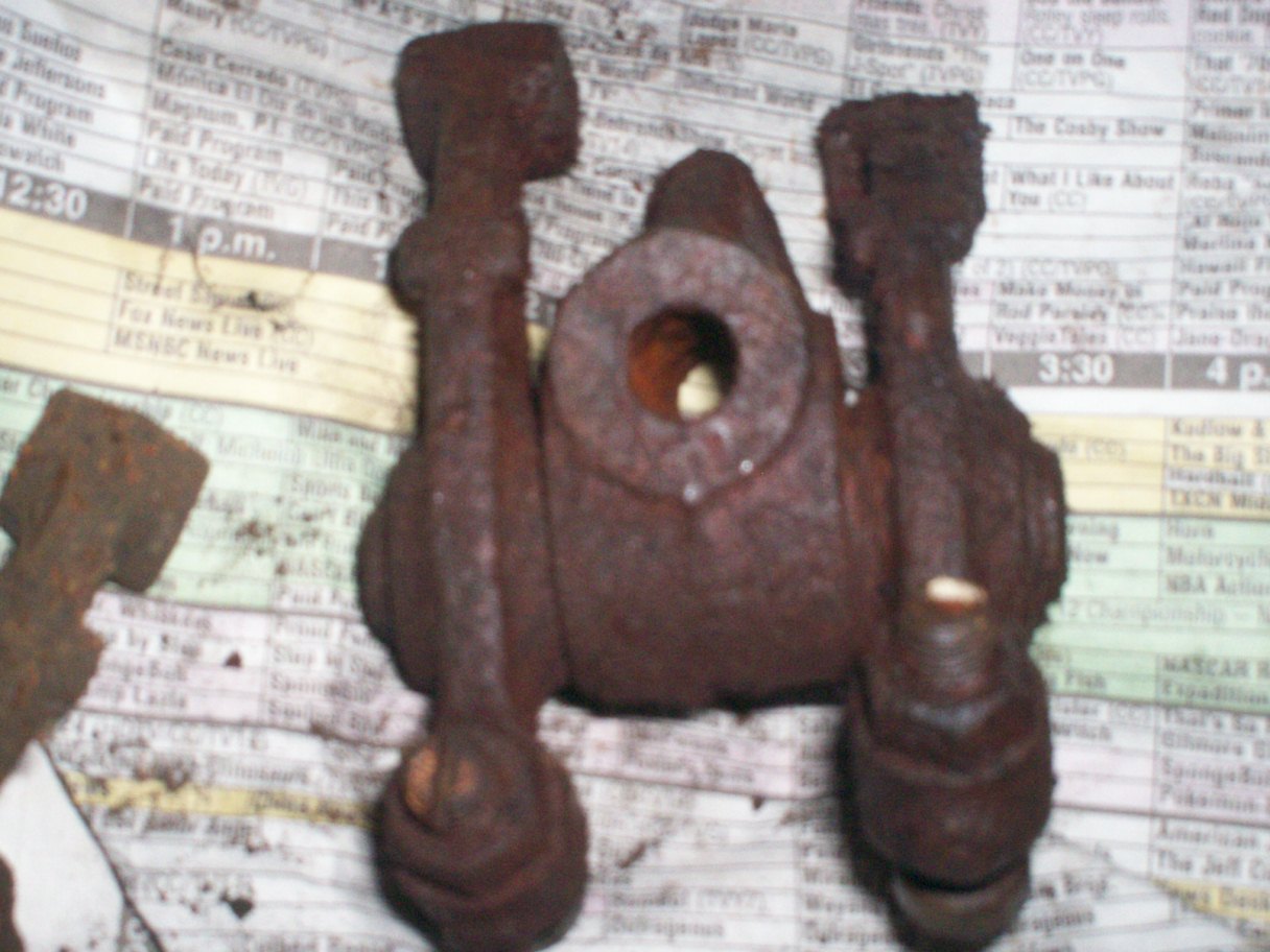

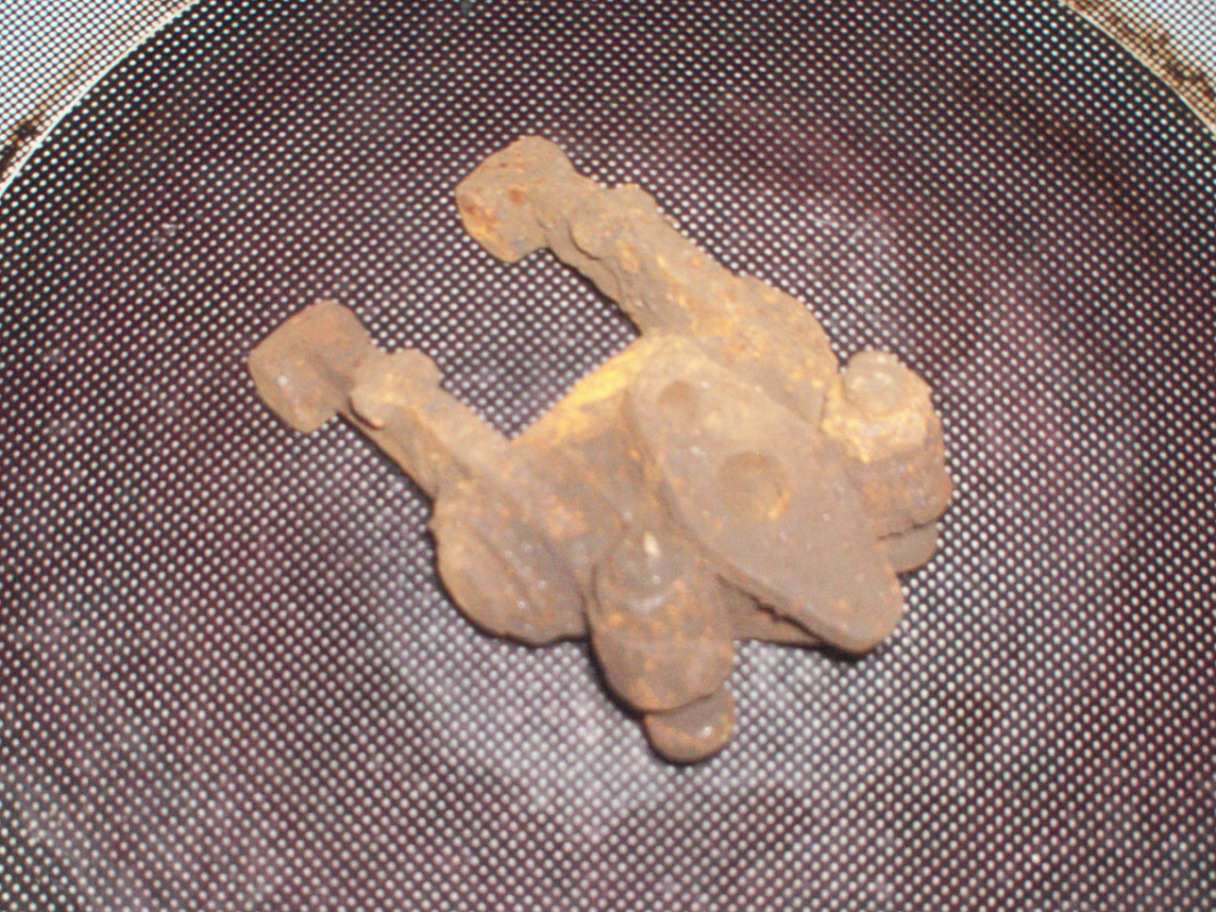

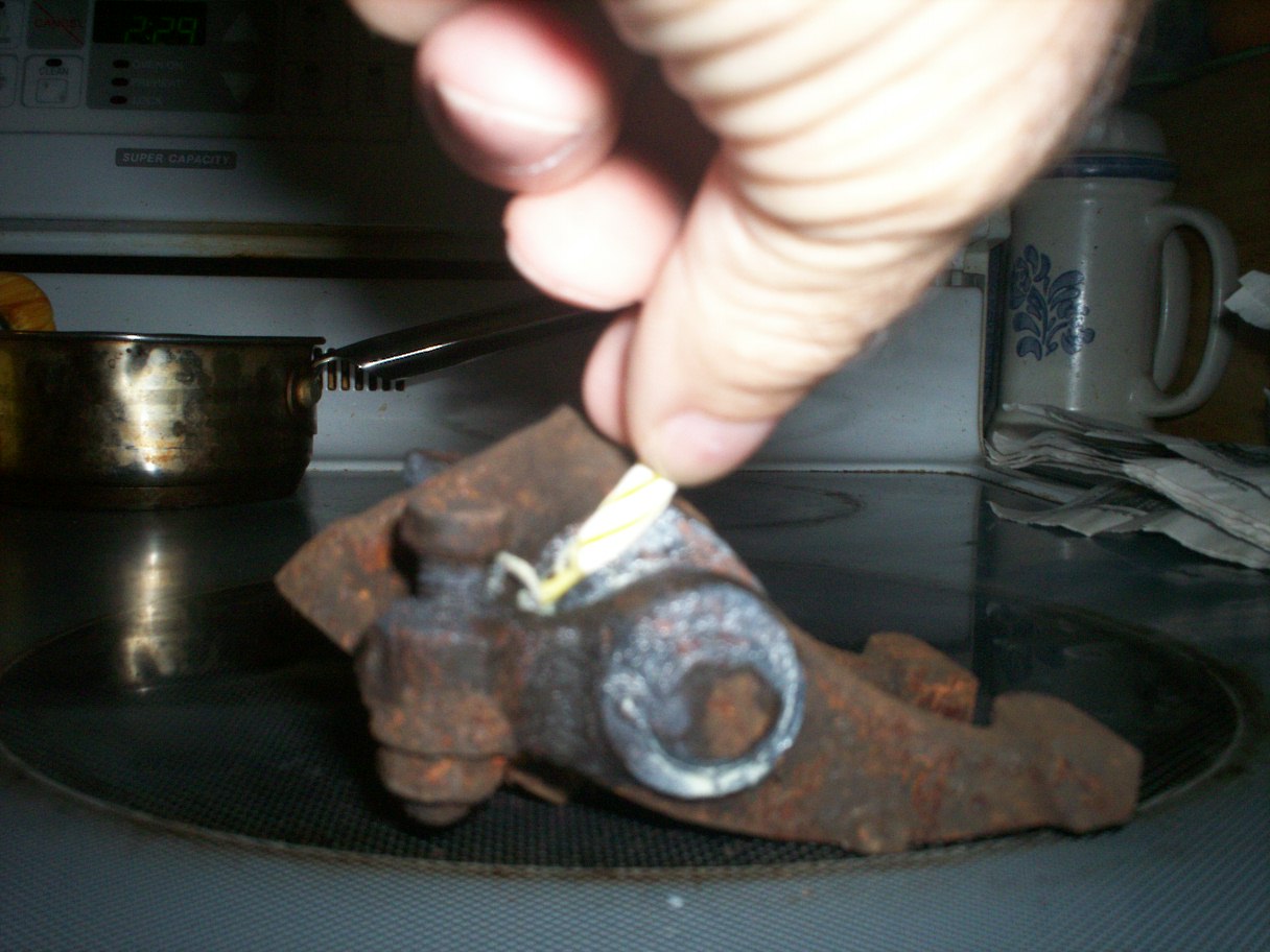

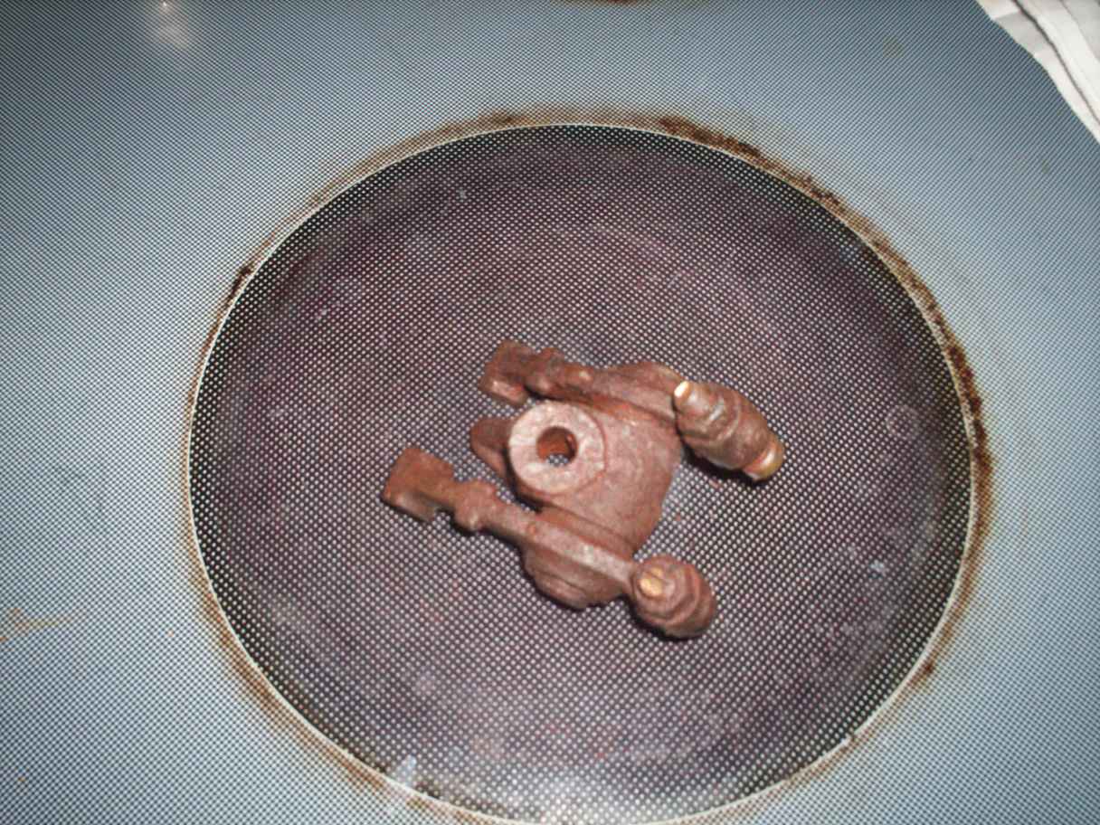

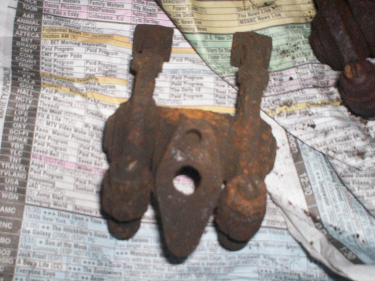

I found the original rocker arm assembly's, they didn't appear to be worn too bad, but as luck would have it, they were rusted up, wouldn't move at all:mad: I remember talk of using wax to free up stuck bolts, so since the wife was gone shopping with my daughter, I brought them in and put them on the stovetop. Heated them up, applied a birthday candle to pivot points, and the adjustment screws, the wax wicked right in. Carried them out to the vise, a small hammer and a pair of pliers freed them right up. Brushed them with a wire brush, stuck them in a can of diesel till I get ready to go back together with engine.

Went by the dealer this weekend, bad news--part no longer available. He gave me the # of a salvage yard in Commerce, said they could probably locate one. I called this morning, they haven't found anything yet. I'll give it about a week, then go to plan b.

Salvage yard just called, they have my part ($22.00). I will go pick it up tomorrow.
