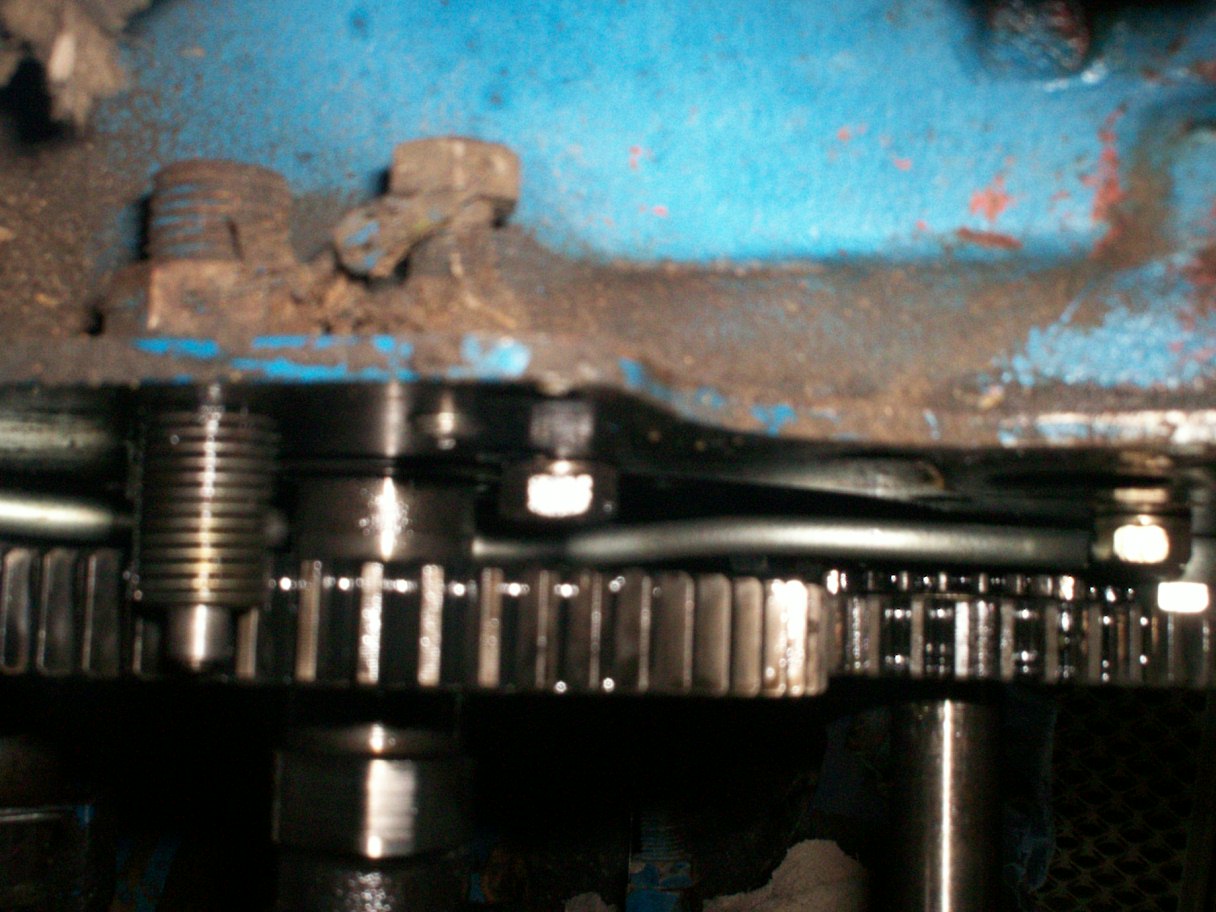

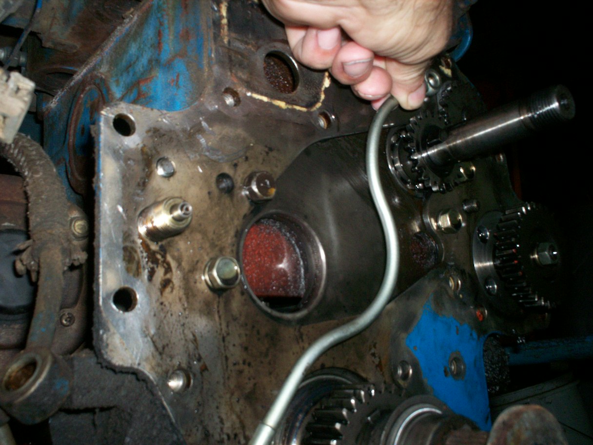

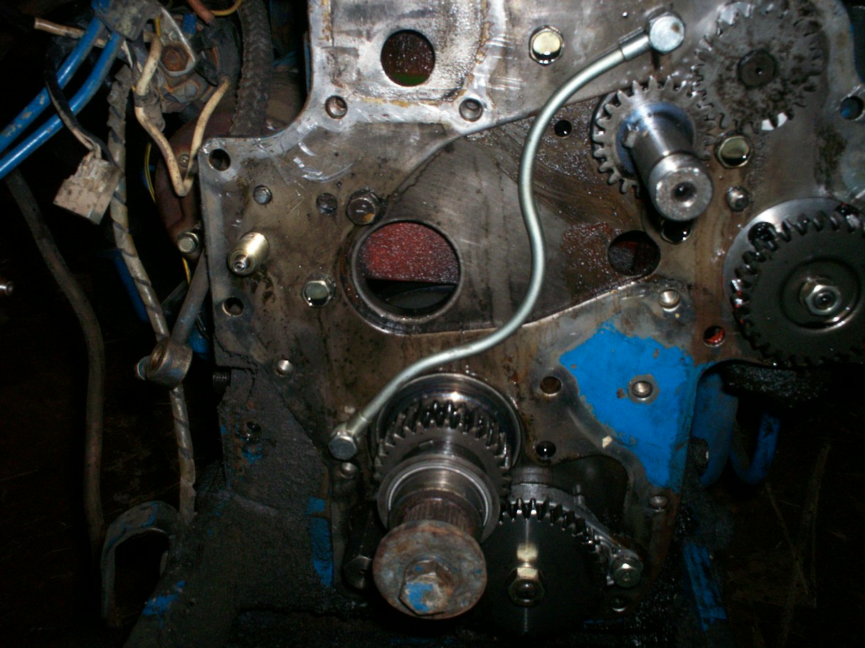

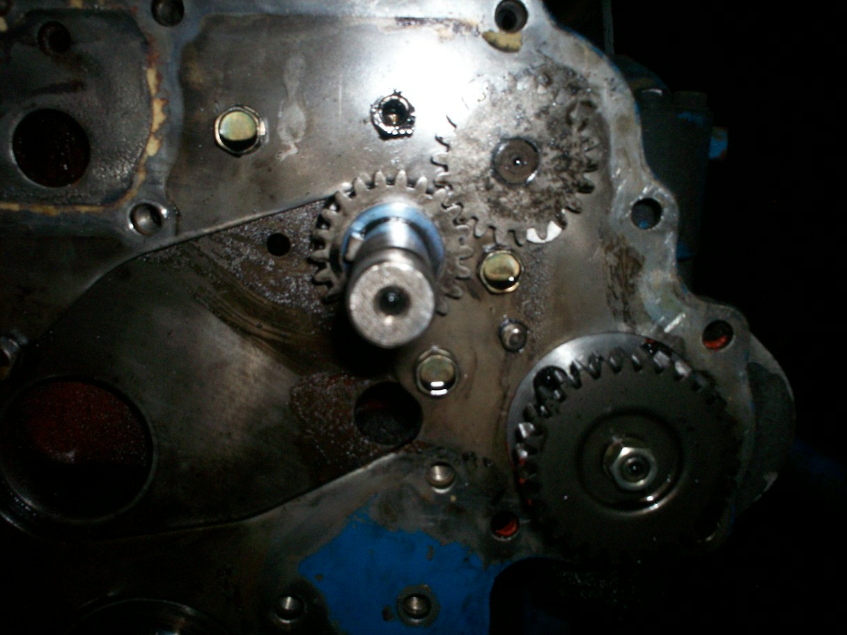

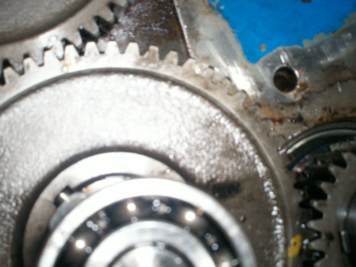

Did a little work today on engine. First, I held oil tube up to try to match to bolts that were visible. Found 2 that matched length of tube, one was the bolt that was suspect with the copper washer, the other was up behind gear that runs cam. Removed 2 gears, one that drives injector pump, and the cam gear (I lined up timing marks first). Pic 2 is looking at hole that oils top end (this also had a bolt in it). Pic 3 shows tube bolted in place. Pic 4 (kind of blurry, zoomed in too much) shows gears with timing marks lined up. Pic 5 shows gears back in place and close proximity of oil tube (side view). Tomorrow I will make new timing cover gasket and see if I can locate a new front seal locally. I'm thinking Monday I may try to run.

I knocked the front seal out and scraped off a piece of the old gasket so I could get the same thickness. Went to 2 different parts houses in Kaufman, neither had a piece of gasket material larger than a sheet of paper, and they couldn't cross over the seal #. Napa might have a piece big enough (15"x15"). I will check with the tractor dealer Monday, and check on availability. The seal looks good, and could be re-used, but I need a gasket. The waterpump seals through the back of the timing cover gasket to the block, so I don't want coolant leaking into crankcase. Sometimes you just have to wait.

Got the gasket material from NAPA. 16"x36" sheet for $4.00. Dealer said gasket from Ford was having quality issues so they weren't sending any out. They can get you a good gasket, but you have to buy the engine rebuild gasket set. I made my own. Went ahead and got new seal from dealer, cleaned up timing cover and installed. Filled with oil, new filter. Bled injectors, adjusted valves, engine cranked right up. Lots of oil on top end now. I put a pressure guage where the sending unit is supposed to go, just to see what kind of pressure I have. 50#'s. I used tractor about 3 hrs yesterday, no problems.
