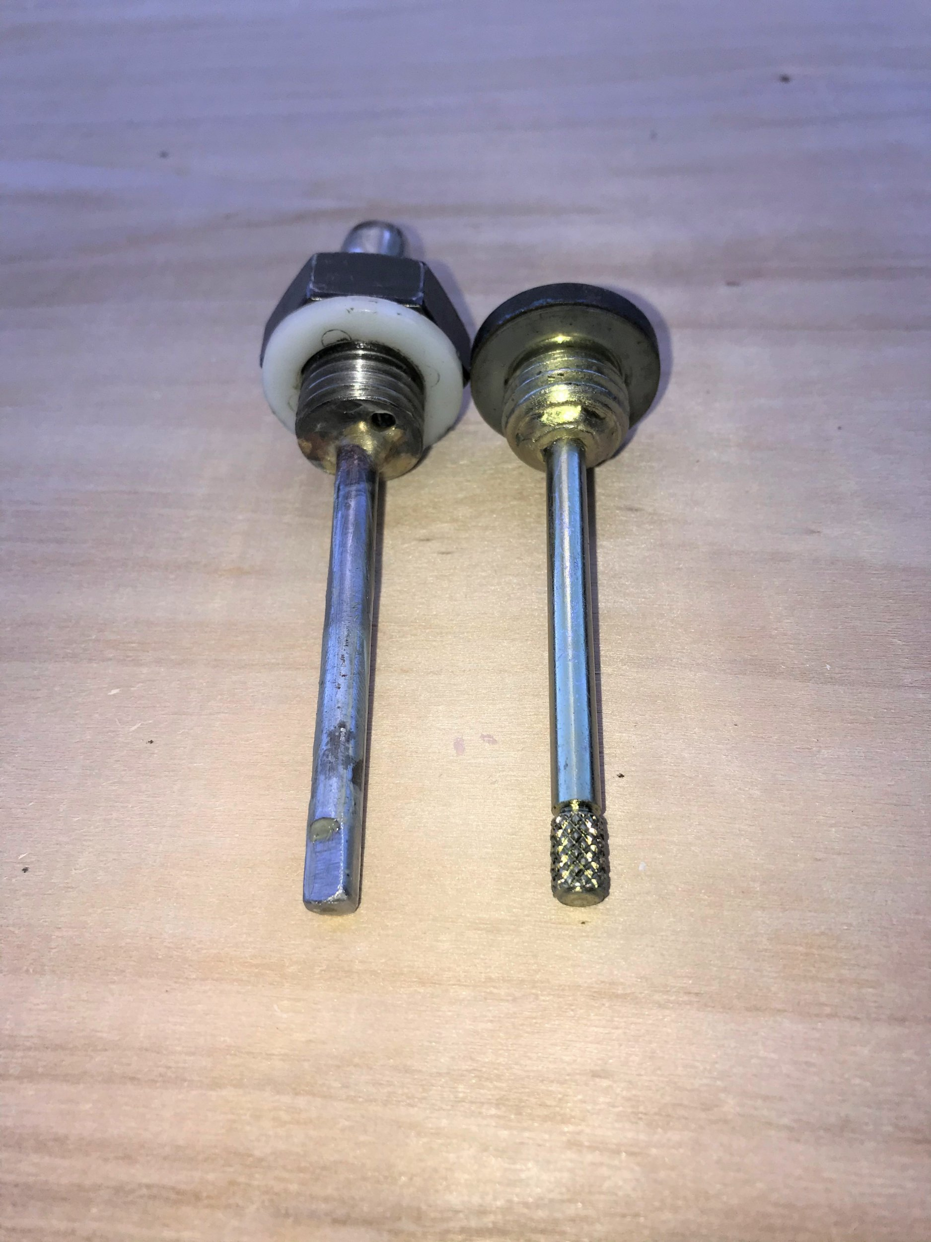

Update, it's been awhile!
Instead of replacing the seals I have been monitoring this slow front axle oil leak and came to conclusion that it is a combination of worn bevel gear lower seal (item 15) in the enclosed drawing, and a pressure buildup inside the axle due to no venting whatsoever.
Pressure buildup is caused due to heating while operating and change in outside temperature.
In order to eliminate pressure buildup in the axle I made a new "venting dipstick" to replace the OEM dipstick (item 63).
The vent is a John Deere item JD5801 which is a "one way vent" or a pressure relief valve and it's easy to find them for few bucks on Amazon or eBay etc.
I have installed these JD vents on my JD 413 brush hog and Ford 917L flail mower gearboxes for the same reason.

Well it's been two years since switching to 85W-90 gear oil & addition of vent as described above.
Ford 1310 front axle has not since leaked any oil!

Until i can acquire the correct seals and complete a repair, i like your temporary fix. The vent fitting you used looks to be about the same size as the plastic fitting/dipstick used on the Tuff Torq front axle on my Legacy XL.
How did you go about creating that vented dipstick? I'd like to give it a shot.

Here it is in few steps:
  • First I figured which thread is in the factory dipstick and bought a same size & pitch metric bolt (M20 x 2.5) from a local hardware store.
  • Cut the bolt to a proper length and drilled hole right through the center in a small lathe - I suppose it could also be done in drill press if no lathe available.
  • Drilled a hole large enough to fit 1/4" steel rod for the dipstick. Dipstick was brazed on later.
  • Drilled just the top end of the 'bolt' to proper diameter for the threaded vent & tapped inside thread for the vent.
  • Drilled a small vent hole at an angle right into the area where the bottom of the vent will be (see post #4 above).
  • Large diameter plastic oil drain seal to seal the dipstick to the axle case.
I could have easily done it just by modifying the OEM dipstick similar way, but decided to leave it as is.
