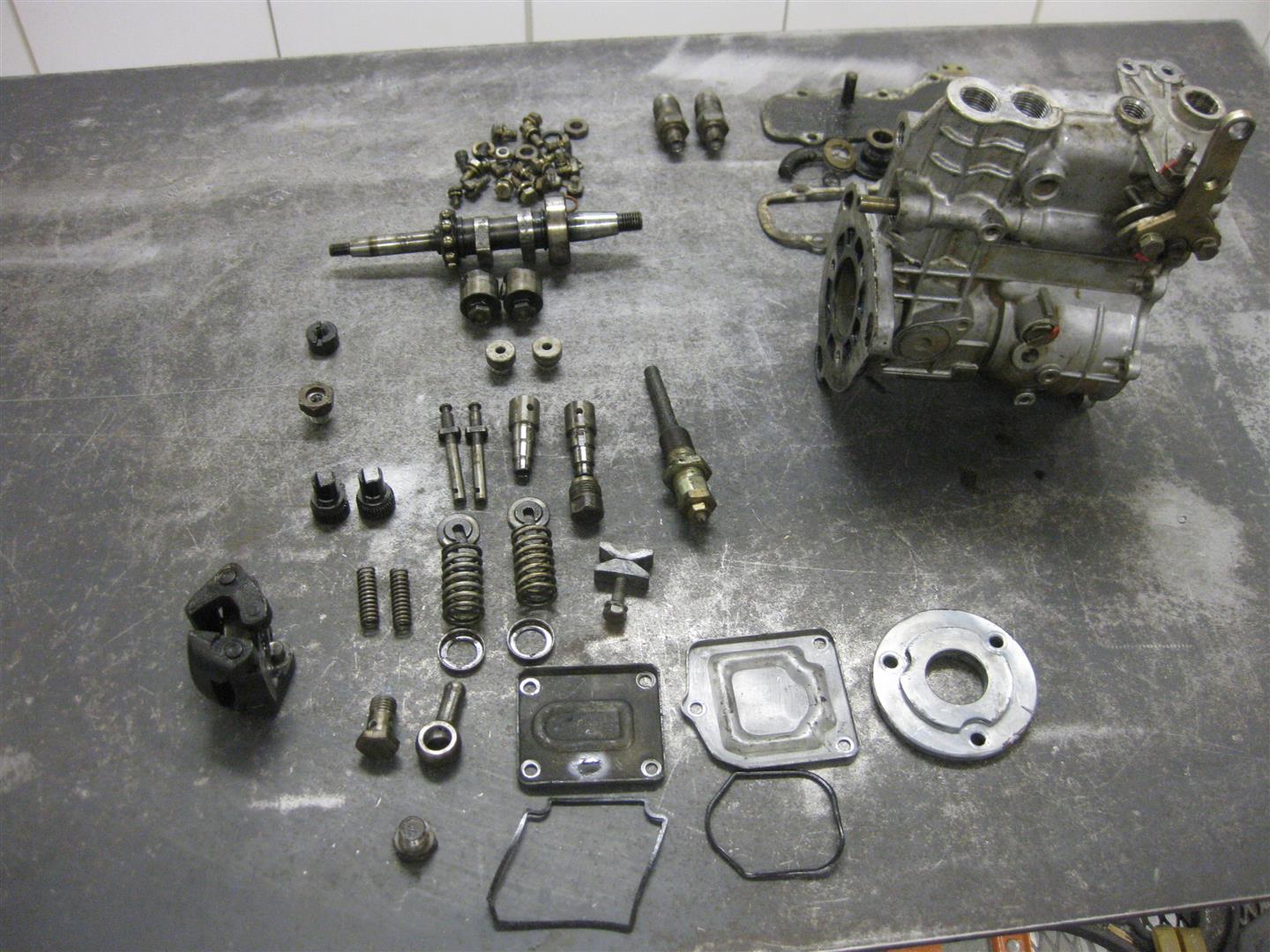

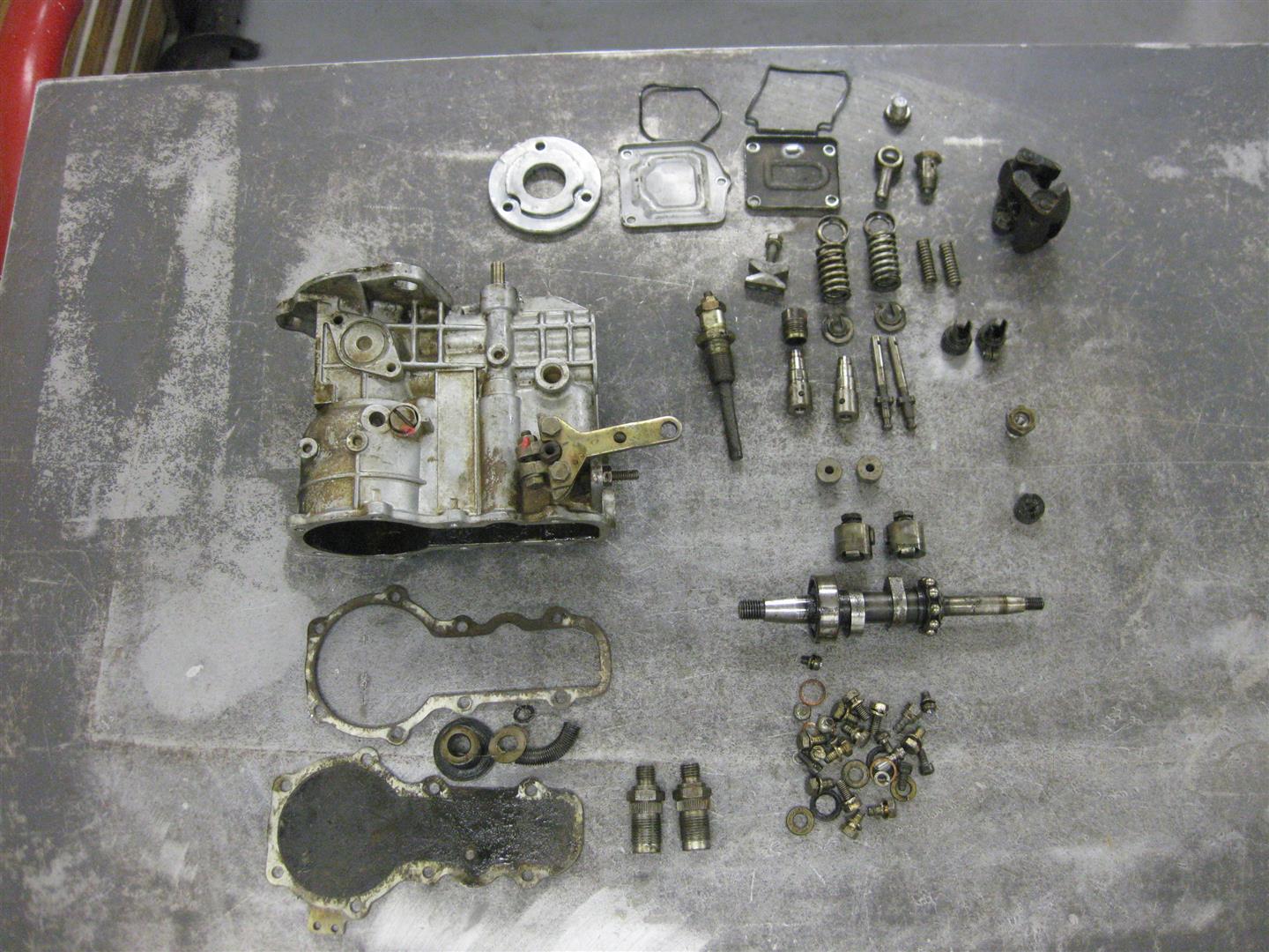

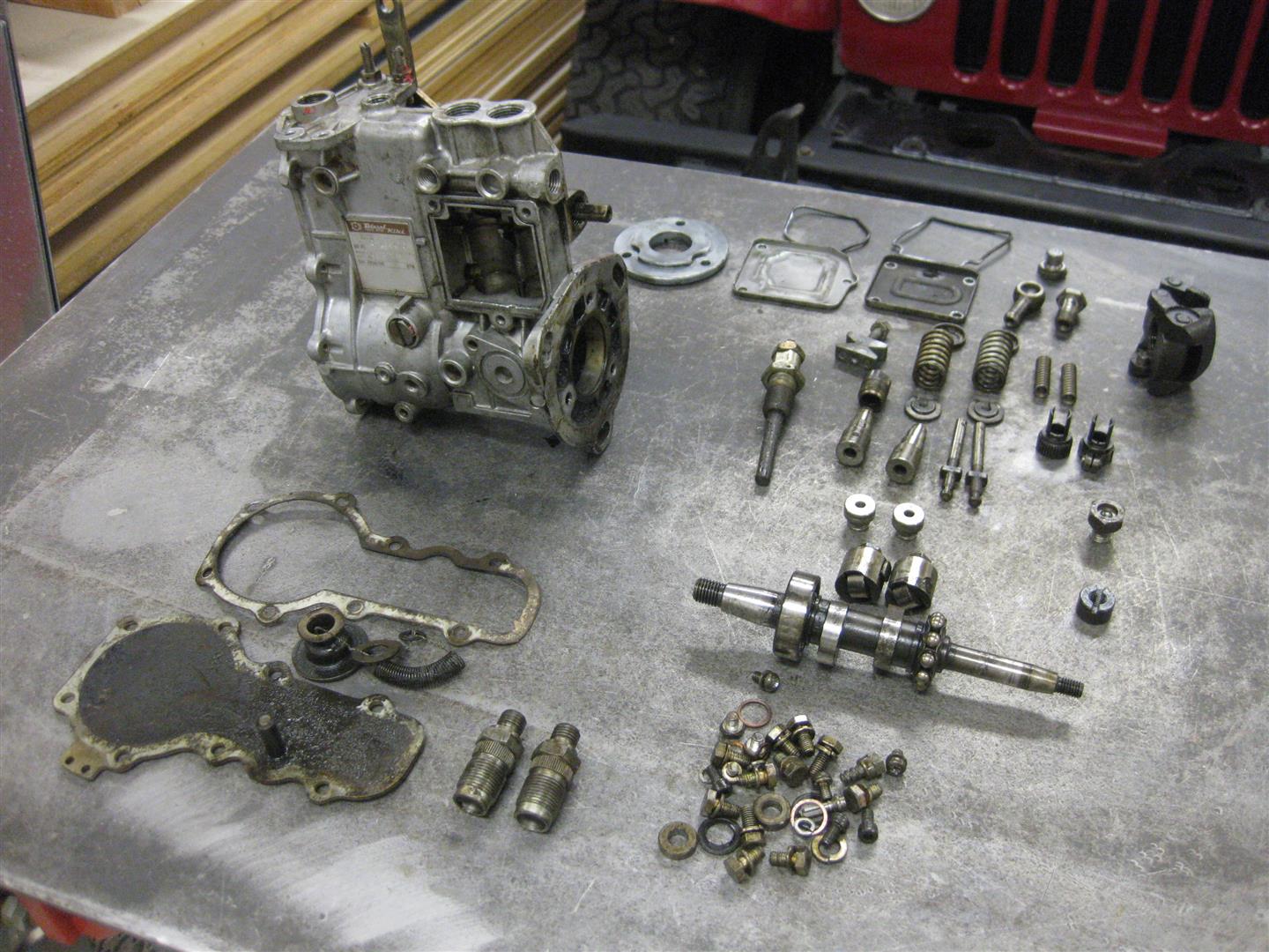

As promised, here are a few pictures of the original fuel injection pump that came from my 1979 Ford 1500 tractor. The pump was disassembled by a local fuel injection pump rebuilder and returned to me in this condition. I'm not sure where all the parts go, although some of them are fairly obvious.
Fuel Injection Pump 10-11-13 (4) (Large).JPGFuel Injection Pump 10-11-13 (48) (Large).JPGFuel Injection Pump 10-11-13 (53) (Large).JPG
John
   / Ford 1500/1700 injector pump #100
Thanks John for the pictures. It is exactly how I envisioned it looking at the only diagram I found on the injector. I think repair or overhaul is doable if the need ever arises. You are right that it the engine is not so smooth running but I have been always amazed of how much power I can get to the wheels or PTO and 3 point with this engine. I have seen several of them with 3000+ hrs on them, so I think with a bit of TLC it will keep running for a long time.
