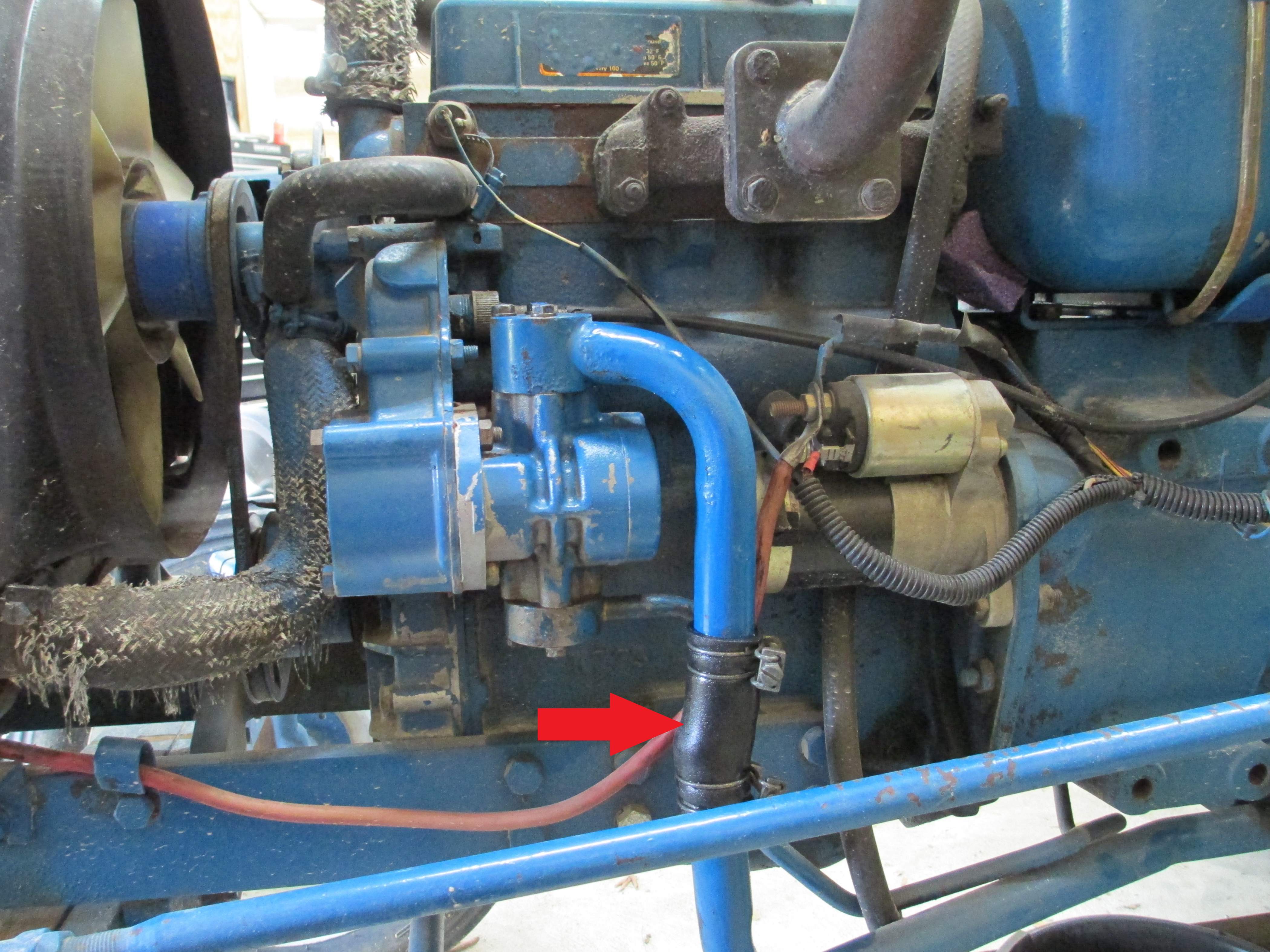

#32
Well, I put the old filter back on to eliminate a new defective filter, didn't make a difference. Put new filter back on.
Took rubber hose off that connects the ridged tube from top of pump to lower ridged tube, used a soup can full of fluid and put it over the ridged tube from top of pump. Started tractor and nothing, can still full. Tried a couple of different O-Rings on input tube to pump to try to ensure there is no air leak. No change, even though these are just regular O-Rings out of a kit. They are not the NH O-Rings, they are typical O-rings. The one removed from the tube was like a flat rubber washer, unless in was flatten over time, don't know. So I guess it is possible there is air still passing by the O-rings I tried but I think it would be a long shot.
I am still having a hard time accepting that the pump just died but I guess that is a possibility.

Here is a picture of the rubber tube I removed to put the can of oil over the ridged tube coming out of the top of pump. I even tried to check for air leaks in the ridged tube, but didn't find any.

Apparently my tractor had a field repair done on the hydraulic line the goes from the diverter valve to the bottom of tranny. There was a rubber hose splice in that line where it was cut in two. I replaced it with a new piece of hose because it was looking pretty old and worn. So I had to take the line loose at the diverter block and reinstall it. That's it all except for filter and oil. I had waited till the oil change to replace the hose.
But right now the pump will not suck fluid from a can through the short top pipe coming off the pump. I can't think of anything else that would stop that from happening, Unless of course the O-rings I tried aren't sealing well enough to create the vacuum needed or discharge pipe needs to be filled with fluid or something.
