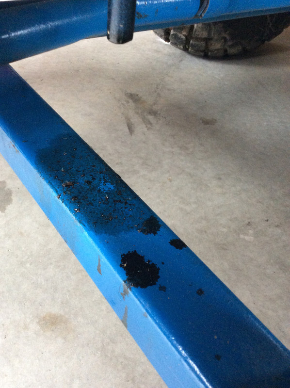

My Ford 1510 has started spitting/leaking oil out of the exhaust pipe.
It uses over a quart of oil per tank of fuel. I mildly restored this tractor a few months ago. I bought it with a bad injection pump, so it didn稚 run right. Now that it is running I知 finding this oil issue. It is more pronounced when rpm is above 2000, but does smoke at all rpm痴.
The breather hose does have some air coming out, but not much oil. Here is a shot of the hose end.
I知 wondering if this is a valve guide issue or rings. When I went through the tractor I found the oil tube for the rocker arm shaft missing. The rocker arms and guides were without oil for Lord knows how long. The valves were way out of adjustment because of the wear. Something else I found was the #3 cylinder exhaust port completely blocked off with soot/sludge. At the time I chalked it up to valves being out of adjustment. But now I知 thinking maybe the valve guide was wasted letting oil in.
How do I tell where this oil is coming from? Thank you for the help fellas.
