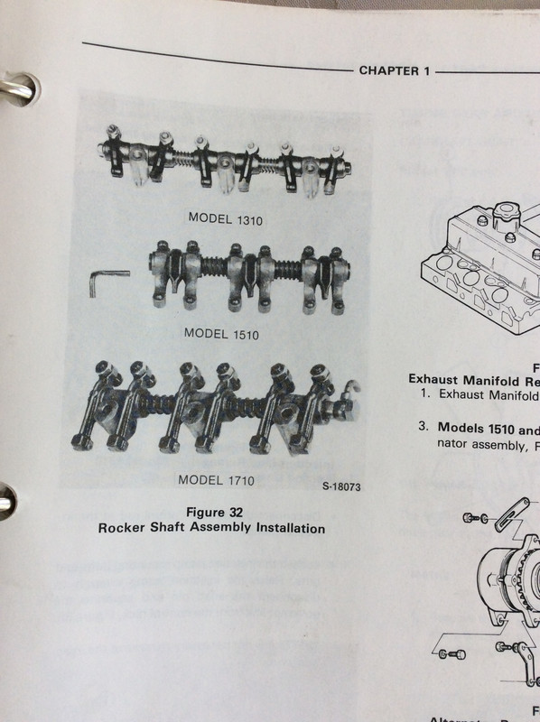

There must be an oil port due to your transfer piping to the rocker shaft with your teflon pipe. I have looked and can't find a transfer pipe in Messick's engine diagrams, but I'm sure you are right that one exists to oil the rocker shaft.
   / Ford 1510 shooting oil out exhaust
#36
This is a pic from the service manual that clued me in to the missing pipe.
I can tell it is coming from cylinder three because the exhaust port there was wet. The other two cylinders exhaust ports were dry.
I removed the exhaust and checked for oil inside, but there is nothing in there, just soot.

Just a random thought...make sure your oil supply pipe extends into the rocker arm shaft the same distance as the factory one to distribute your oil evenly in the shaft and not oversupplying #3 with oil??
#38
Yes, I checked it. I ran the engine with the valve cover removed to see how much oil was being supplied to each rocker. Surprisingly there are no oil supply holes on the tips of the rocker arm for the valve and push rod ends. The only oil supplied lubes the rocker shaft and that’s it.
