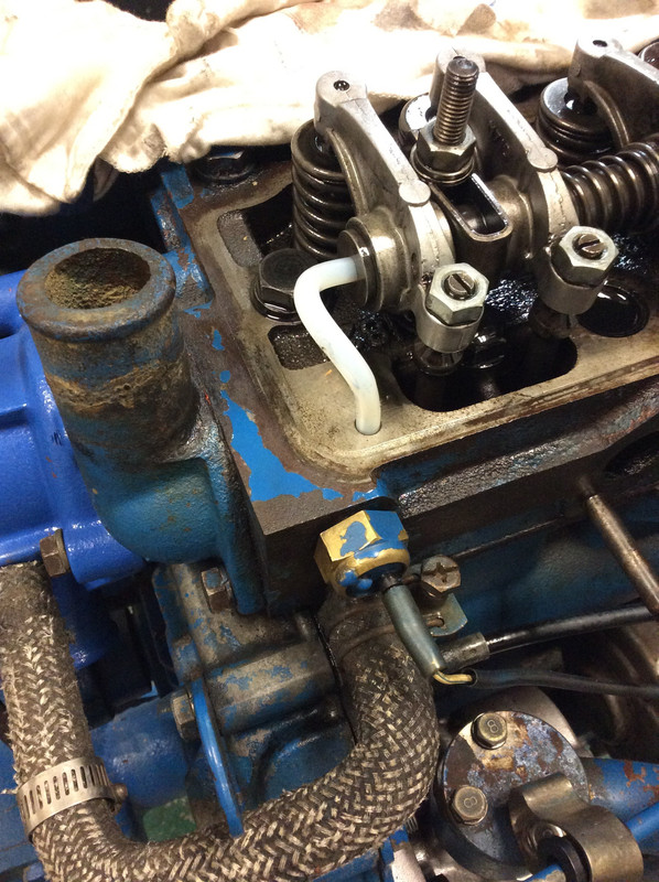

Boomer, I’m also wondering if that was the issue. Why do you think it is the guides and not the rings? Just curious as I am not a diesel mechanic.
When I started digging into this tractor after I bought it I discovered the pipe which supplies oil to the rocker arms was missing.
You can see the hole for the tube in the lower right side of the head.
I was able to fab a new one out of high temp ptfe tubing which seems to be working Well so far.
It was after installing this tube that I noticed the oil in the exhaust and consumption. Are the valve guides lubricated by oil leaving the rocker arm shaft?
I will look and see in the parts breakdown if there are valve seals or just guides.
Is there anyway to tell which ones are shot other than removing the head and micing everything?

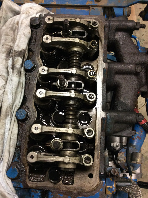

Yes the valves and guides are splash lubricated.
With care you can remove the rocker shaft, and then using compressed air injected through the fuel injector hole, hold the valves closed while you remove the locks holding the valve spring in place. Now you can feel the amount of lateral movement of the valve in the guide.
Universal Overhead Valve Spring Compressor
Have the engine at the top of its stroke for the cylinder you are working on so the valves cannot drop right into the cylinder.
It is likely you can buy seals now even if they were not used originally.

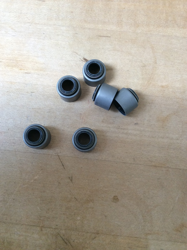

I checked the parts breakdown, and it does have guide seals. It does appear they are still available, so I will put in an order with Messicks.

My valve seals came in yesterday, just waiting on the spring compressor now.
