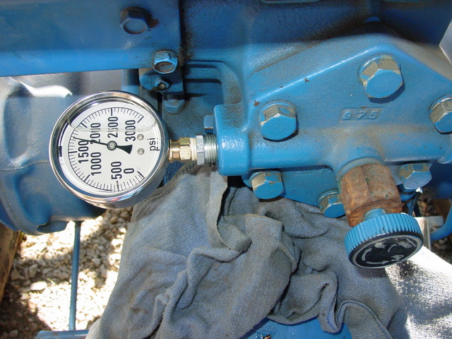

After installing the valve, connect some hoses and place in a bucket and then start engine to see which hose has flow.
Usually the 3pt is the last valve in a tractor hyd system..
You could put a hyd gage there and test for pressure.
Show us some pictures.
Does it look anything like this?

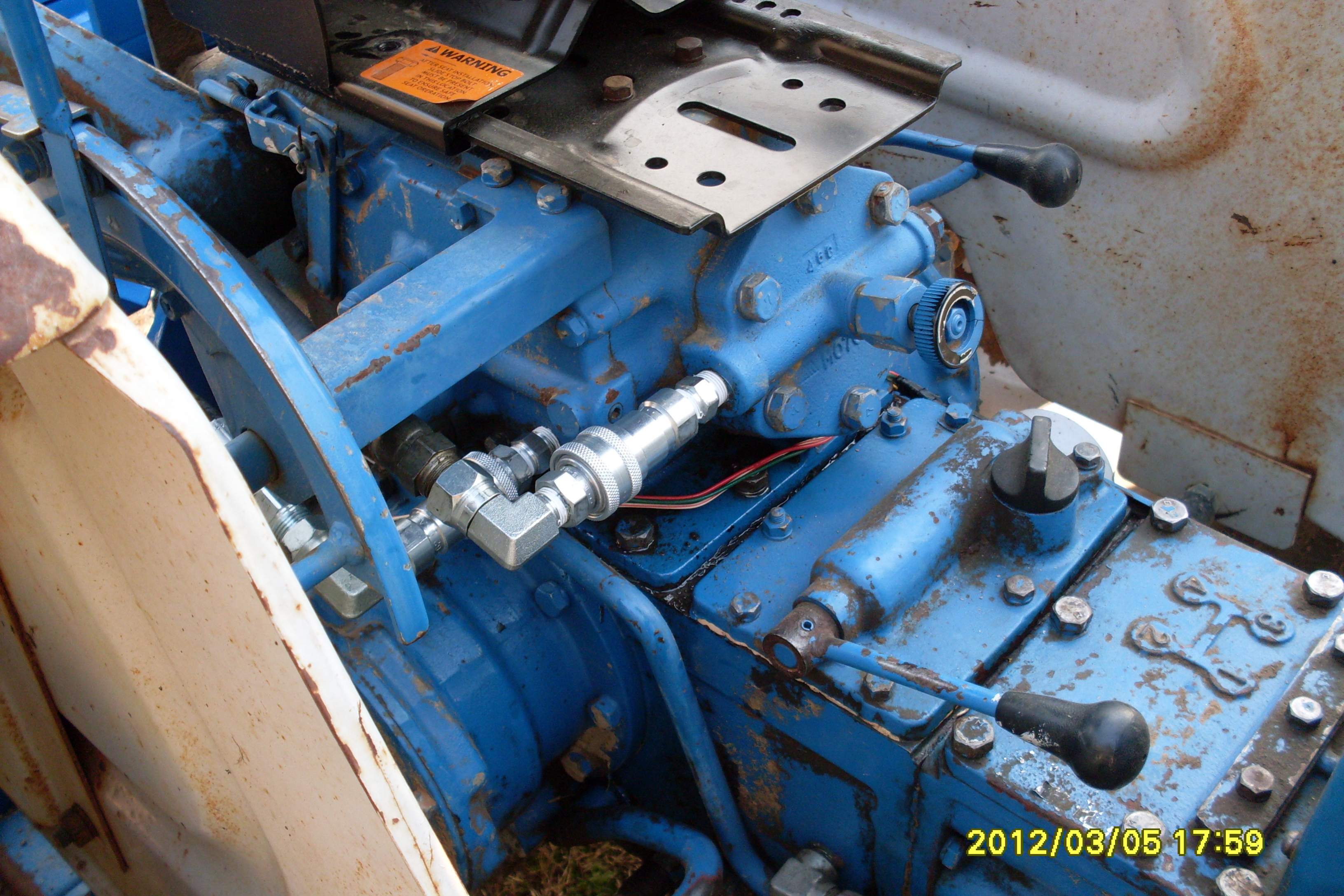

Well, here's the only pic I can find that I have online already: This is the 3 point control from directly above. The tube towards the top is the return to the tank, the inlet tube is underneath. The cap with the 3 bolts on top we are looking straight down on has to be removed and is replaced by an adapter block with two hydraulic ports on it, not pictured here because I didn't want to install it yet without a plan of how to move forward. You can see the speed control knob at the bottom of the picture, and the entension out to the control lever to the left of that.

This is how it might work.
The pump is pumping fluid to the bottom of the 3pt assembly, and the top plate is redirecting the fluid to the 3pt.
When you remove the cap and replace it with an adapter, the fluid now flows through the valve and then into the 3pt.
So with the loader valve in neutral, the pump flow is flowing through the loader valve to 3pt and then to tank.
You can only us both valves at the same time if you only use about half lever on the loader. If the loader uses all the fluid, there will be no fluid to the 3pt, but that is only for a short while.
The adapter may be marked, but if not, you can bump the engine and cause the pump to run briefly and fluid will flow trough the OUT port to loader.
You could also install a gage in the ports and check for pressure as in the pic above.

Did the bump test, and it seemed to confirm the flow through the valve. Then switched the tank and PB lines, and it works as predicted. The loader valve works fine, and the 3 point works all the time, except of course when the loader valve is being engaged. That's good enough for me.
