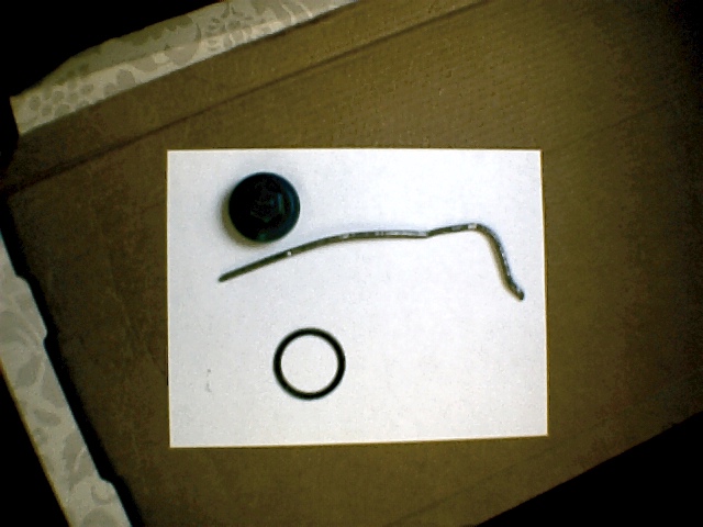

I can assure you that there is a chance of the cap and stick becoming seperated (wink)....
Here's what i found on my 5000. Apaprently the prev owner may have ? bent the stick a little and put it back in. there is very little clearance.. at least onmy 5000 trans... any deflection in the stick and it touches a gear. Apparently it got pulled up and wadded up .. Luckilly I only found small metal and no 'teeth' in my oil and all the gear 'feel' good so far..
I've included my cap, and dipstick.. used to be oem 1- unit.. al metal..
Soundguy

Soundguy,
I'm glad you were able to retrieve the metal rod(dipstick) with no damage to the gears. After I saw your pic I then looked at my manual and sure enough it is a metal dispstick like yours. Surely one can come apart from the cap by some sort of abuse. For some reason I had a Brain hiccup:D and had a vision of that cap and dispstick on 1700 same as my Honda lawn mower which has a moldedd cap and graduated dipstick all one piece.
Well, once more...You're right on the money..boy What a surprize !!:)
